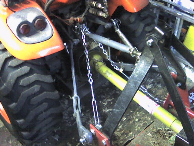

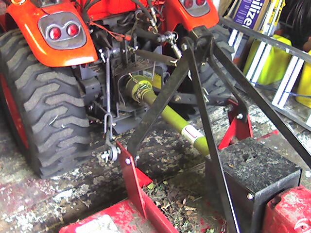

However, here is my update on the check chains: I installed check chains today. Due to the configuration of the Bush Hog 480 Squealer mower and the geometry of the 3pt arms on the CK20, I could not install chains as far outboard as I had wanted. In fact I had to install them essentially directly under the pins. Nevertheless, I did put the chains on and used a turnbuckle to tighten them to the point that they were carrying some of the weight. I then tried out the mower set at 4 on position control which puts the skids on the mower sides about one inch off the ground. I made three sharp turns at mowing speed (low gear) and plowed on two of the three turns. Not good.
I could raise the mower but that is what I did without check chains to prevent plowing and that gives me a minimum cut height of about 5 inches which is a bit more than I wanted. I did the mowing at dusk and did not get photos so I'll try to get some tomorrow AM to show my check chain set up.
I have been very happy with the Bush Hog as a brush hog which was its initial purpose. I was hoping to use it to maintain the area after clearing but unless I can conquer this plowing issue I am going to move on to plan B which involves a Caroni flail mower. I need to make a lot of turns around bushes, trees and rocks on a gently sloping former pasture so it may just require a different mower style.

I've said it many times before on TBN, and again in your case, I think you should look into "check chains". For the most part, they'll eliminate any scalping unless one of the tractor wheels falls into a hole.
And then what happens when you go over a hump?? The chains would simply lift the deck off the ground. The way your chains are set up they aren't any better than position control which in itself does nothing to control scalping either. ???
/ Brush mower Vrs Finish mower #31
Well, I will post some photos of the check chains I installed based on DJRADZ's photo. Looks to me like I did essentially the same thing and attached them at the same point (under the 3pt pins). I agree it makes more sense to attach them outboard but I could not do that without interfering with the 3pt arms.
I agree with the comment that based on the geometry these should not really do much more than the position control. Indeed in my brief experiment after installation that is all they did. If I try to mow with the hog about one inch off the ground, even on level ground, when I make a sharp turn there is a significant chance that I will start to plow. By plow I mean the edge of the hog will scape the turf off and leave a big (ugly) curved clean dirt scar between about 2 ft and up to 10 ft long and about 4-8 inches wide before the "plowing" stops. I can avoid plowing altogether if I keep the mower level higher but then the lowest cut is about 5 inches.
Regarding Soundguy's question, I do have lateral stabilizers which can be seen in the photos and which are adjusted fairly tight to prevent lateral motion. In the photos the check chains are loose but I tightened them prior to use after selecting the cut position with position control. They were tight enough at that point that they were hard to turn.

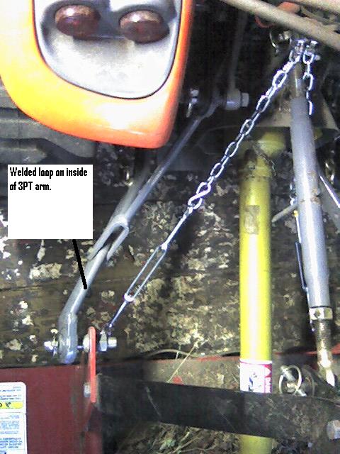

There is a welded loop attachment point on the inside of each 3pt arm that I have never figured out the use for. It is about six inches from the pin coupler and on the inside. I have only a lousy photo that I have put a pointer on to help you see it against the dark background.
What am I doing wrong?

/ Brush mower Vrs Finish mower #32
It will depend on the size of the hump. Small humps like ant mounds may not even be saved with anti-scalp rollers. This begs the next question... How long are you gonna want to 'finish' cut a place that is littered with drastic humps?

/ Brush mower Vrs Finish mower #33
Not sure about the welded loop. How big is it.. Size of a lynch pin?
Soundguy
/ Brush mower Vrs Finish mower #34
I suppose it might be a convenient spot to hold a lynch pin. I'd guess the loop is about 3/8 by 3/4 inch and is about 1/8 inch bent steel rod. It sure doesn't look like it was intended to resist any significant force.
/ Brush mower Vrs Finish mower #35
My old fords have lynch pin holders on them 'near' the eye, and have a chain looped around the lynch pins, connecting them to the holders.
