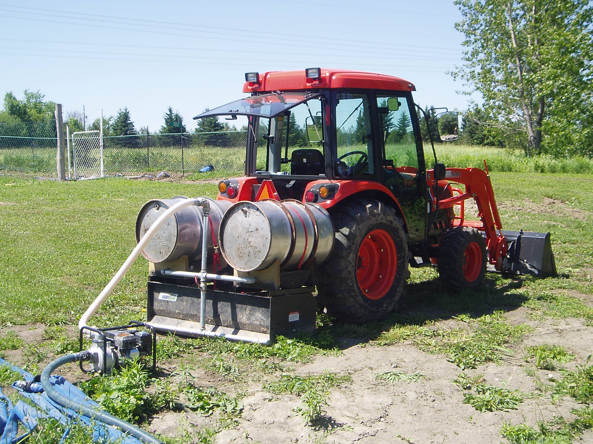

hmmm, they must be 65 gallon barrels then because when they're full of water, the CK30 struggled to lift them, I'd have to jump off, and give 50 - 100 lbs of extra lift. I was assuming the entire rig was about 1700 lbs since that's what the 3pt is rated at.

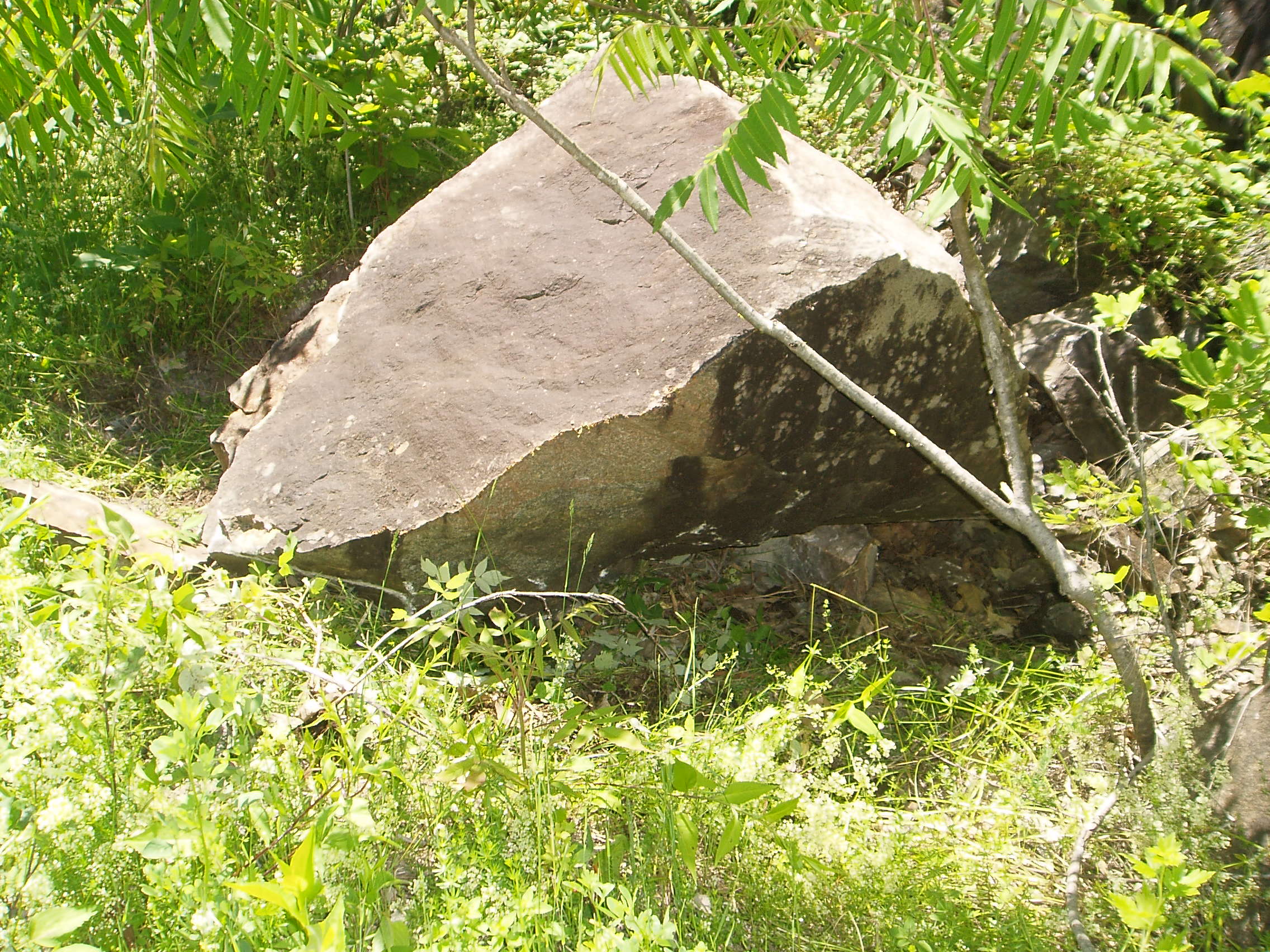

Well, I have 2 problems. 1, the rock is about 3 km from my house and 2, we still can't find the camera! We once lost the remote for 2 weeks when the kids dumped it in the bin with Christmas wrap which we then put back in storage, but this time with the camera is a record.

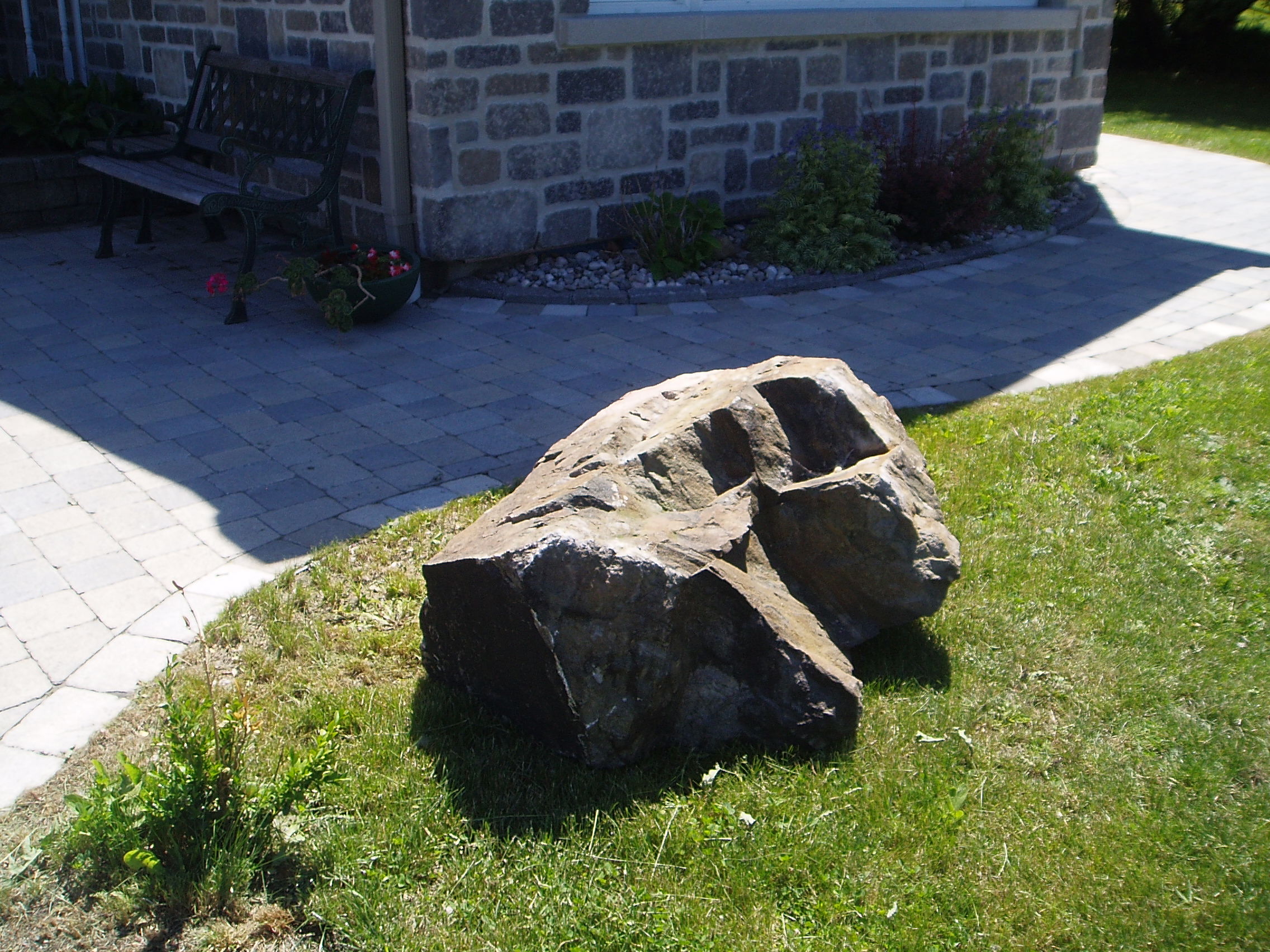

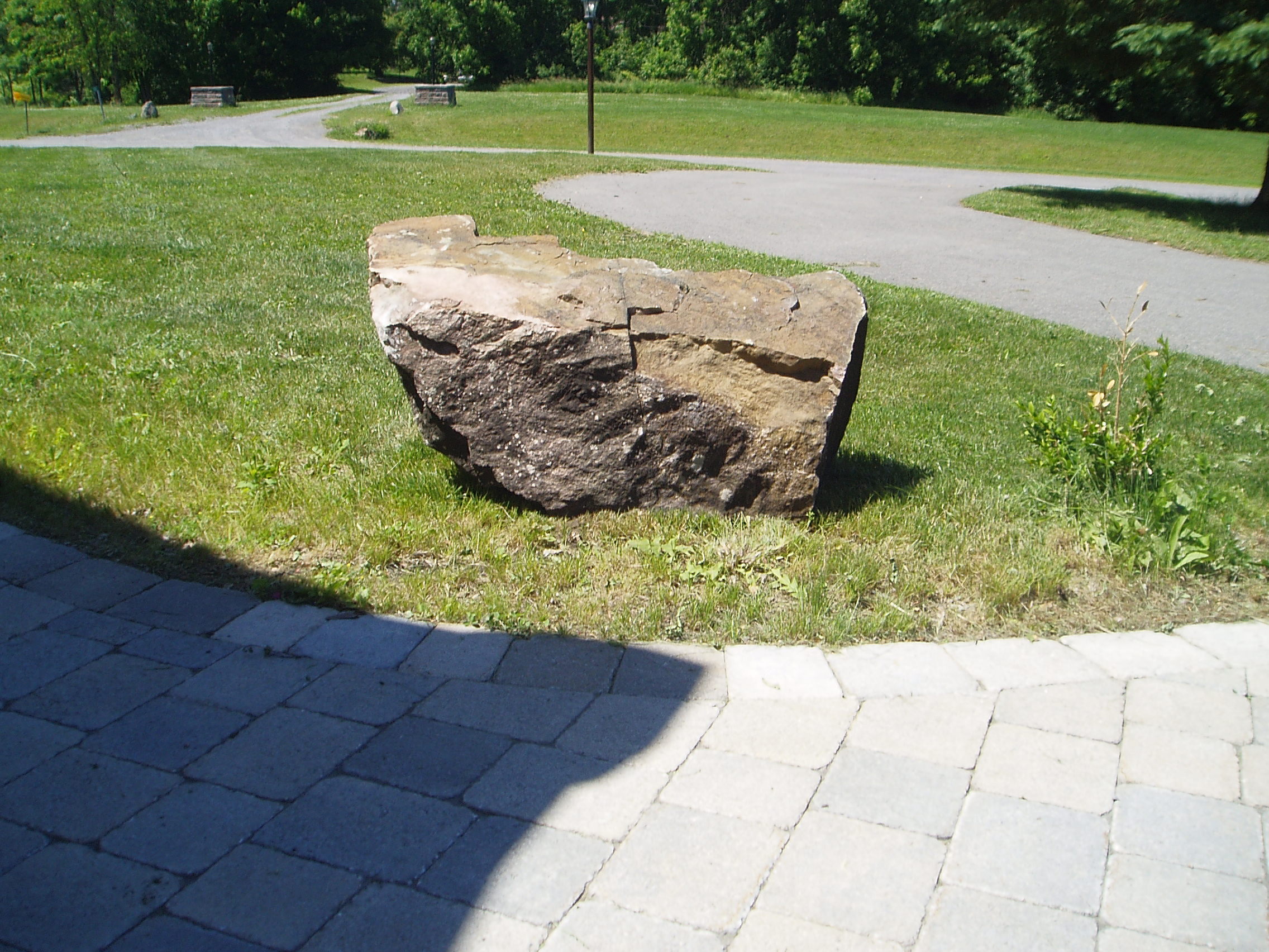

Just what size rock are you trying to lift?
A tractor should be able to lift what you can fit in the bucket.
DK's are nice strong machines. CK's are manure movers/mowers like a Kubota L3400.

Do you have your relief valve bumped up a bit? The specs on L39 and DKSE loaders seem to be identical. I guess the rocks look bigger when you pick them up!

From the pics posted so far, I'd say you'd be able to pick up that rock if you tried with pallet forks or a grapple from the side instead of from the end. It's just too long and sticks out to far to use the bucket.

I'm guessing IndyIan's rock maybe a bit too heavy. Pretty easy to calculate a rough weight with dimensions.

The rock in that first pic you posted looks bigger to me, but they all look bigger than what I would have though you'd be able to lift. The L39 is holding a couple that surprise me too.

I guesstimated it weighed about the same as my tractor, and I could only lift the big end when part was counter balanced on a roller. And even that put a permanent little dip in the middle of the bucket. 6'x4'x1.5'x168lb/ft^3 is 6048lbs.
I have the hydralics less than 100 Psi over factory which is about 2800 psi. When I got the machine it was set at 2200! It could balely lift 1500 - 1600 Lbs. Kubota rates the lift to center bucket, not the pins.
Those rock are the max the machine could lift. I placed them in the bucket with my excavator. There is no other way to fit that big a rock in the bucket and not have it fal out trying to lift. Yes the L39 would lift the rocks to about midpoint.
The L39 is not real strong in the curl and has the Grand L front axle. The new L45 has an M series design front axle and they bumped the curl cylinders up in diameter to where it will curl 4300 Lbs vs 3550 on the L39.
I've got about 1,000 lbs in wheel weights and other stuff bringing the weight to over 8000 lbs. Kubota for some reason likes small front tires on their comercial machines. Sinks real good in soft conditions. The L39 & L 45 should be fitted with 16 x 20 rears (43" dia. vs. 40) and 10 x 16.5 fronts (29 " diameter vs 27") The M59 should have 12.5 X 16.5 fronts.

Well, if it ain't something, it's something else. I was going to give the rock one more try, but my water pump wouldn't go. I've never had to pull it more than twice to start it, but I forgot it out in the rain a couple days ago and I think the gas took in some water. Anyway, I'll try and get it working this afternoon and go for the rock tomorrow morning. Here's a couple pics of my Zamboni set up.
/ Broken again, loosing faith
#360
Well, I drained and changed the gas and still nothing. Fiddled with the switch (on/off) and off it went. So with the tanks full of water, I headed back down the road to try one last time. The rock is down off the side of the road so I put it in 4 wheel drive, low range. I can get under the rock no problem with the forks but, still no lift. I tried backing a little which started bringing the front wheels up to the road level, but also started raising the FEL. I very quickly ended up in a familiar position, with both rear (loaded) wheels, my box blade and two full barrels of water high and dry hanging in the air. The rock wins this one, I picked up a smaller one and headed home. Here's some pictures of the imovable rock plus a couple of the rock I took. My cell phone is in one pic for reference. Still can't find the camera, took the kids again :laughing:
