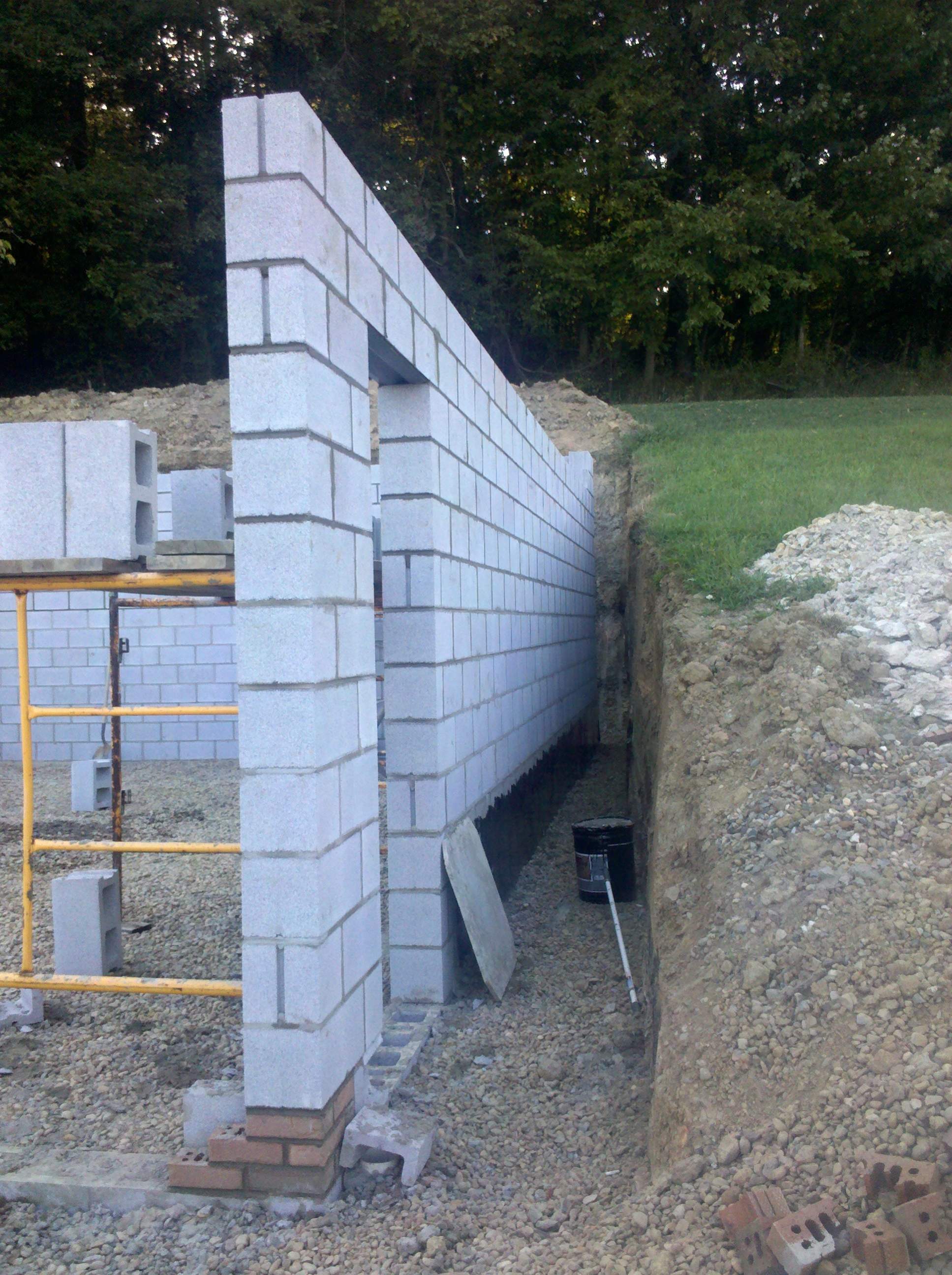

Floor is in. Went with the center drain. Now the kids have a place to ride bikes!

You're making progress scoutcub. Did you slope the floor toward the drain?
Our basement has 3 floor drains. We instructed the contractor to slope the concrete floor toward the drain around 2 of the floor drains; the slopes were even shown on the house plans. He didn't pass the word to the concrete sub so one of our drains didn't get a slope around it. That's one of the many reasons we didn't keep him around to through completion of the contract. My wife caught the issue before the cement around the last floor drain was poured and was able to get that spot sloped the way we wanted it. The floor drain that didn't get sloped is about 3 feet from our hot water heater. Now we may have to put the hot water heater in a drain pan and run a drain hose to the floor drain in the middle of the room.
Obed
Obed - This was a concern of mine as well. I'm currently working overseas so at a disadvantage of not directly supervising the work - not the best scenario. However, I spoke at great lengths with my 2 subs (concrete and block) about what I wanted before I left.
The pictures don't show much slope, so I had the wife double check and they do slope in towards the drain. I'm fortunate the subs seem to have been doing a good job thus far to the specs we had discussed.
I just didn't want to waste a good month of building time while I'm away, I want to be in the garage before the snow flies!

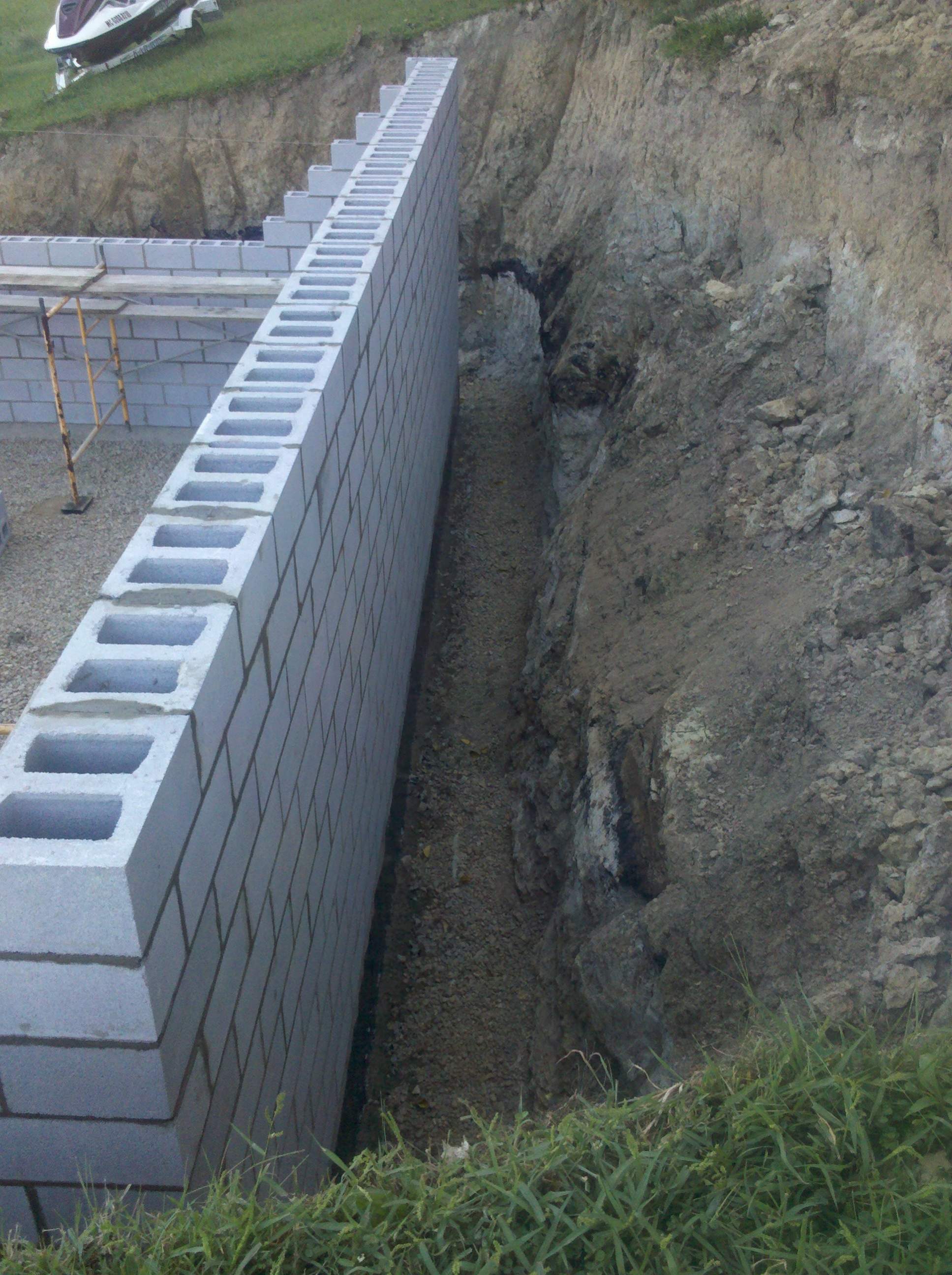

#48
Top cap is on....and front wall started.
Not very happy with Menard's....ordered trusses 3 weeks ago, 2 promised delivery dates ended up as no-show's.......including today....:mad:

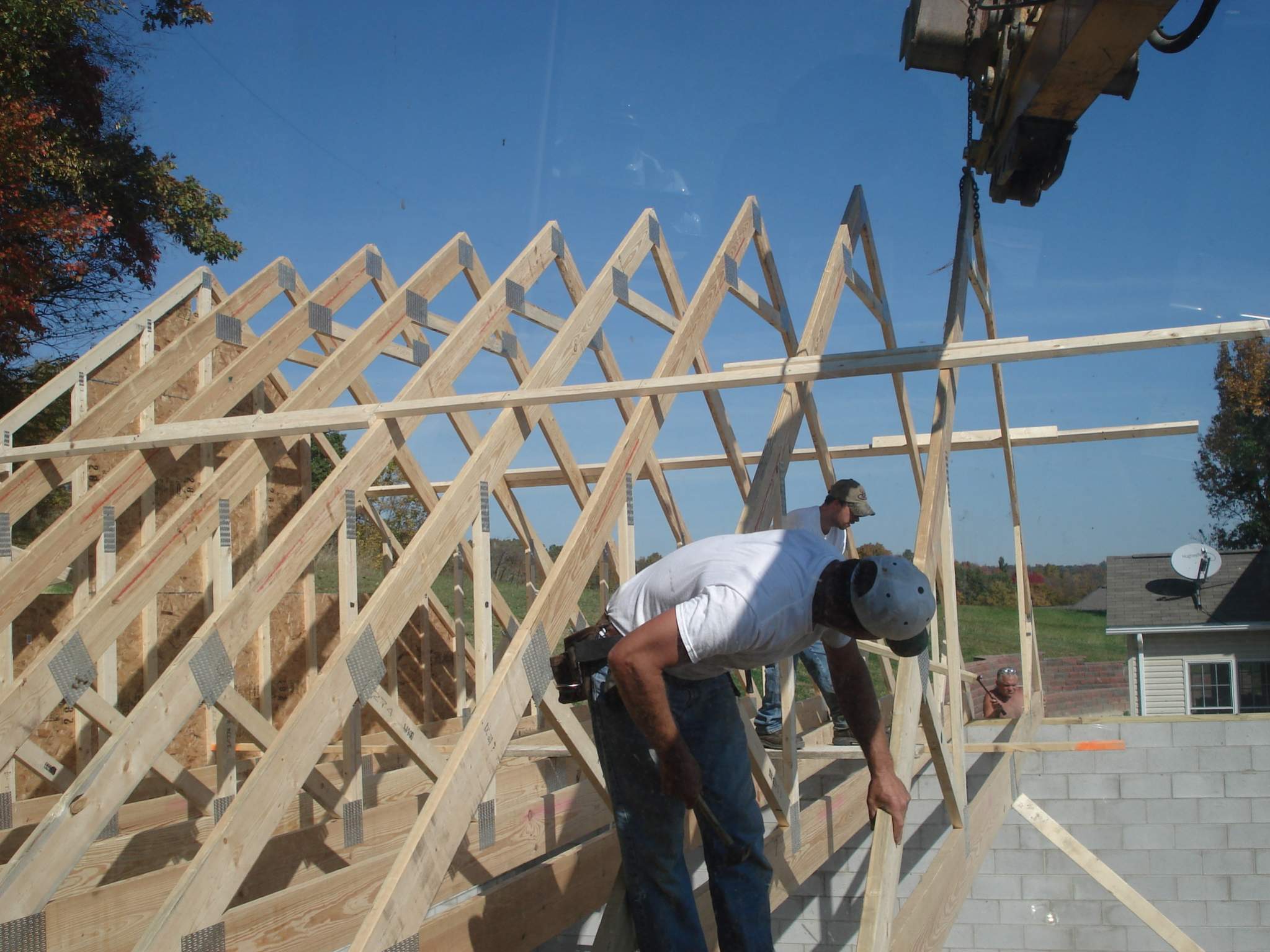

Trusses going up! Very glad I didn't transport my excavator back to the property, we used it to set trusses and I saved a $700.00 crane fee. Plus, some fun seat time.....

Trusses complete! No mishaps or incidents...:D
At first I was a bit uncomfortable with the slope, and getting the machine too close to the "hole" ....my sub at one point suggested perhaps we should get the crane....:eek: so I kept at it till we could get the chain/truss in the center of the garage, and I quickly became comfortable with the slope and the operation.

/ Breaking into the bank #60
Frank,
That looks like a great use for the excavator. How is it that you own an excavator?
