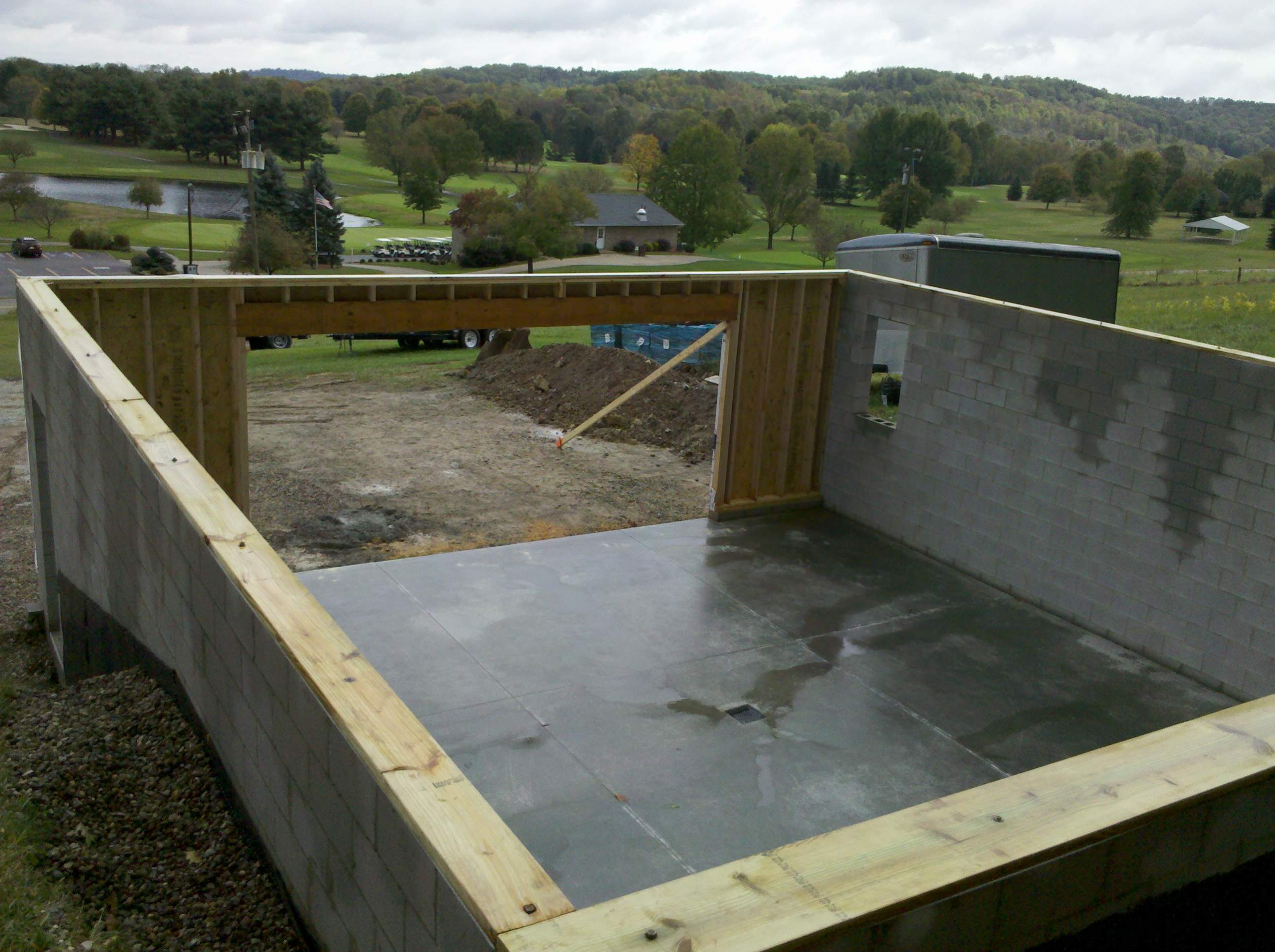

Frank,
Looking good! That sure is a fancy-smancy window; I bet your wife likes it!
I believe you will be very glad you chose to put the exterior door in the attic. It will make carrying stuff into the attic much much easier. Carrying stuff of any size up our pull-down steps is not fun at all.
Obed
Obed -
Well the attic door is working overtime - I'm already starting to fill it up from my small garage and storage. Kind of a "walking the plank" right now to get in there, till I can get it to grade. Quite a bit more material to move yet...
Yes, I really like the octagonal window, and glad it has a screen and opens for ventilation. The wife wanted a round window, but sold her on the much-easier -to-install-and looks better window!

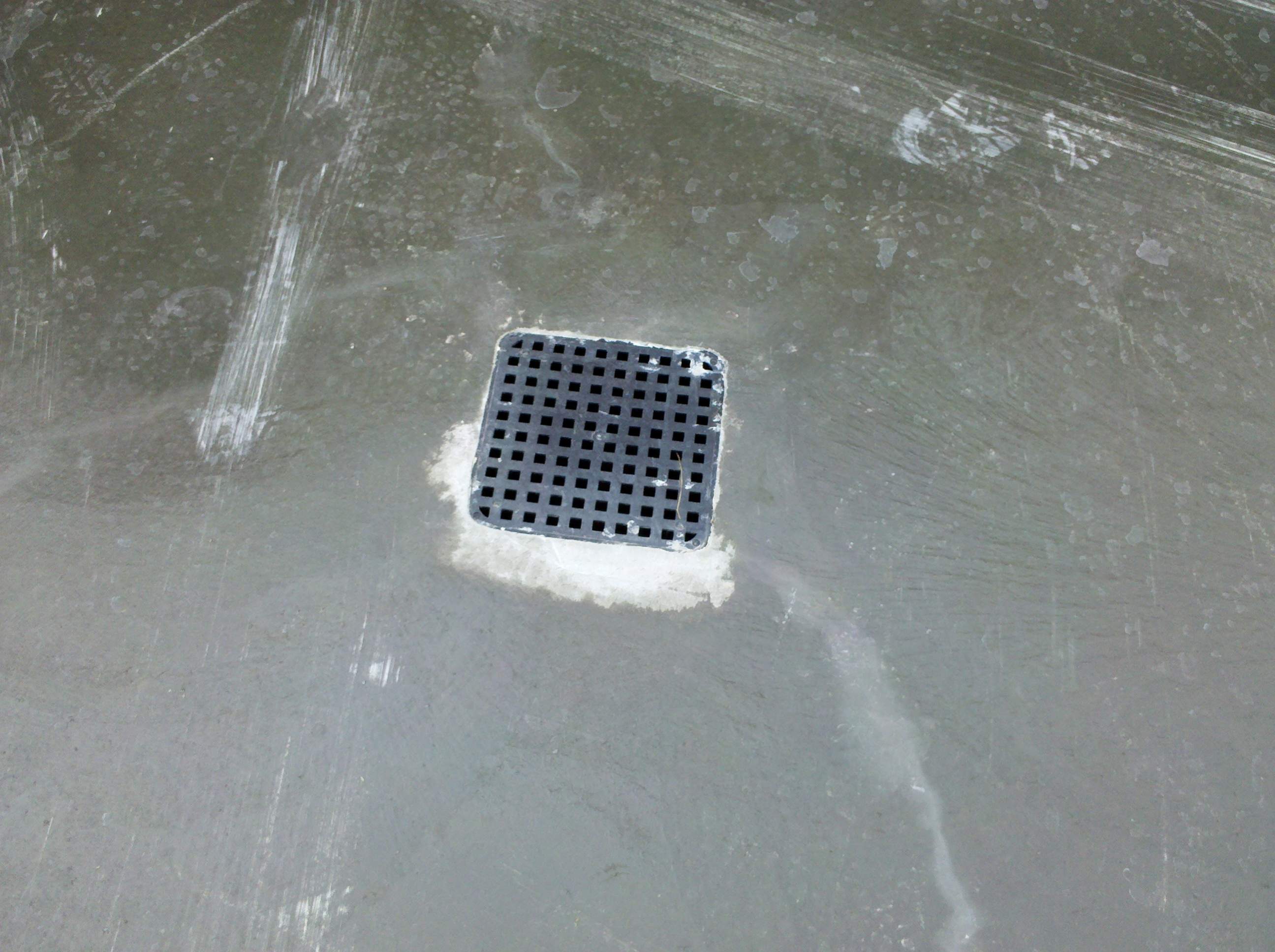

/ Breaking into the bank #83
I would recommend putting a couple of coats of Poly-u on that attic floor bef you get it too filled.
Also, a couple of coats of good epoxy (not Rustoleum) on the slab after it cures for 30 days.
Do it now while the bldg is empty; you'll never get around to it later regardless of your good intentions. Makes it look better and it's easier to keep clean.

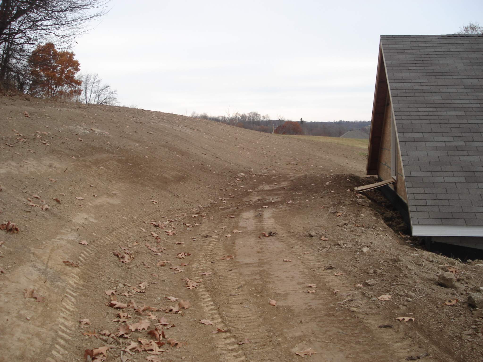

Grading.
Did I ever mention I fear/respect what water can do? The first pic shows a road I started behind the garage to access the attic. My vision was to have an upper and lower road, upper for a perimeter road (4-wheelers, bikes, foot path) leading to a future gazebo/firepit, and the lower road for the attic access.
Additionally, I wanted to grade the roads in towards the slope to allow water to wash away from the garage. Grading is complete, exactly to my specs. Wished I would've done it sooner to get some grass down, so I'll have a muddy mess in the spring to deal with.
