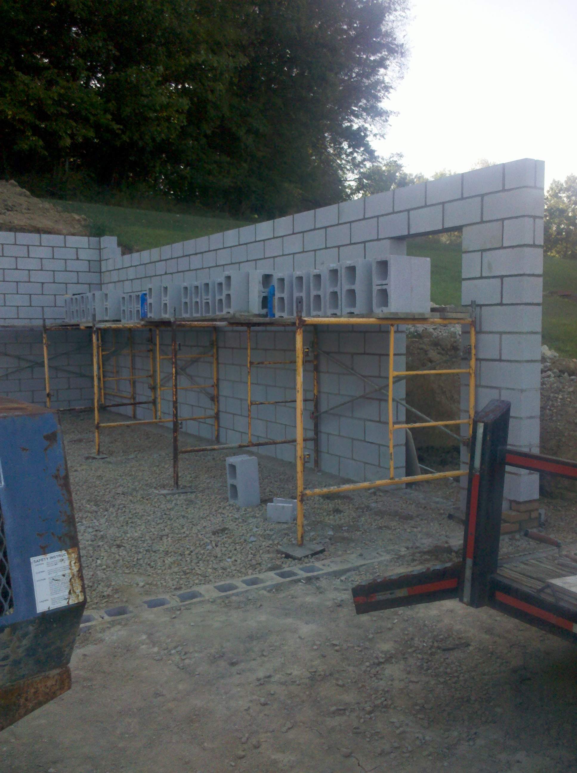

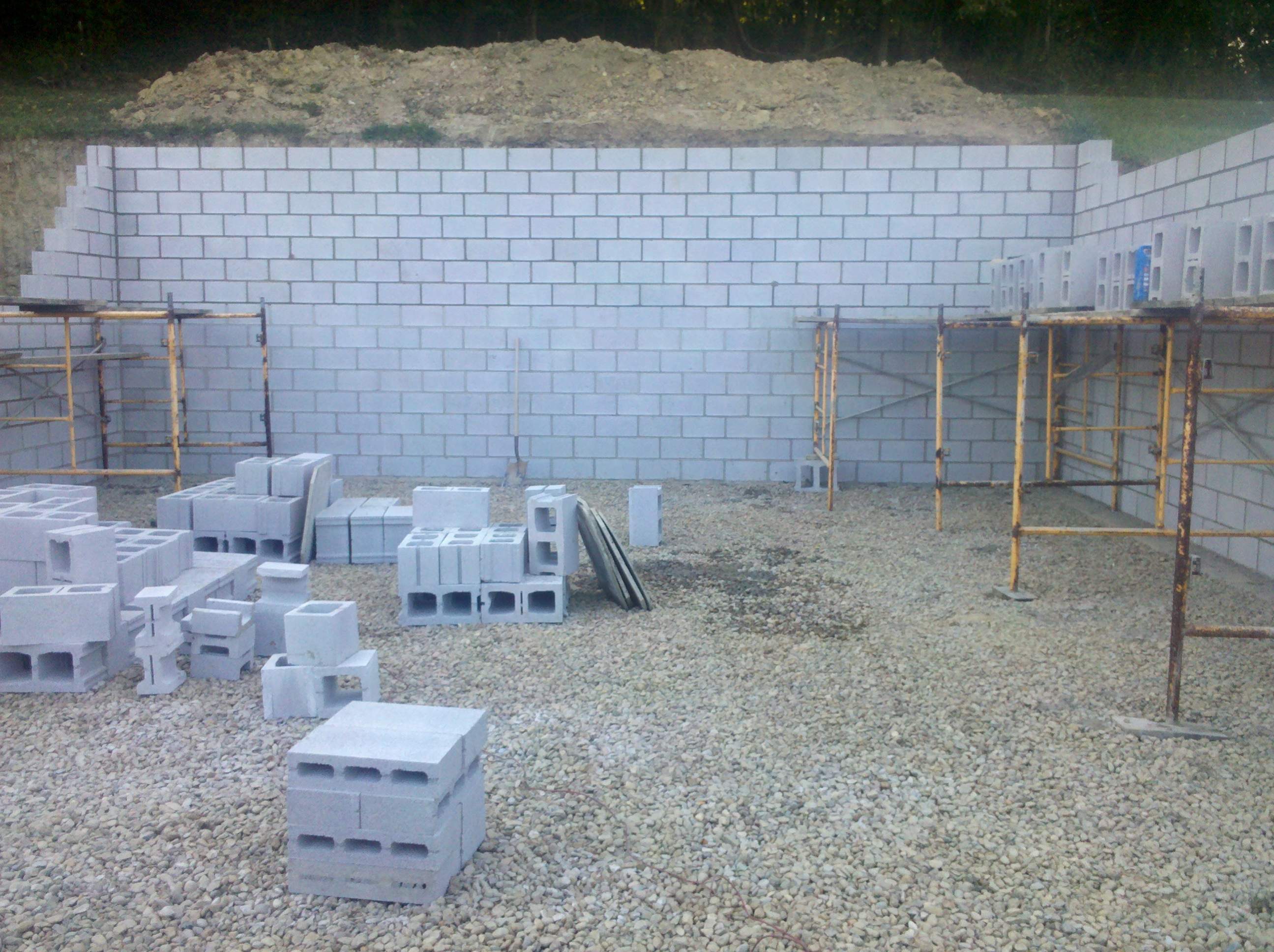

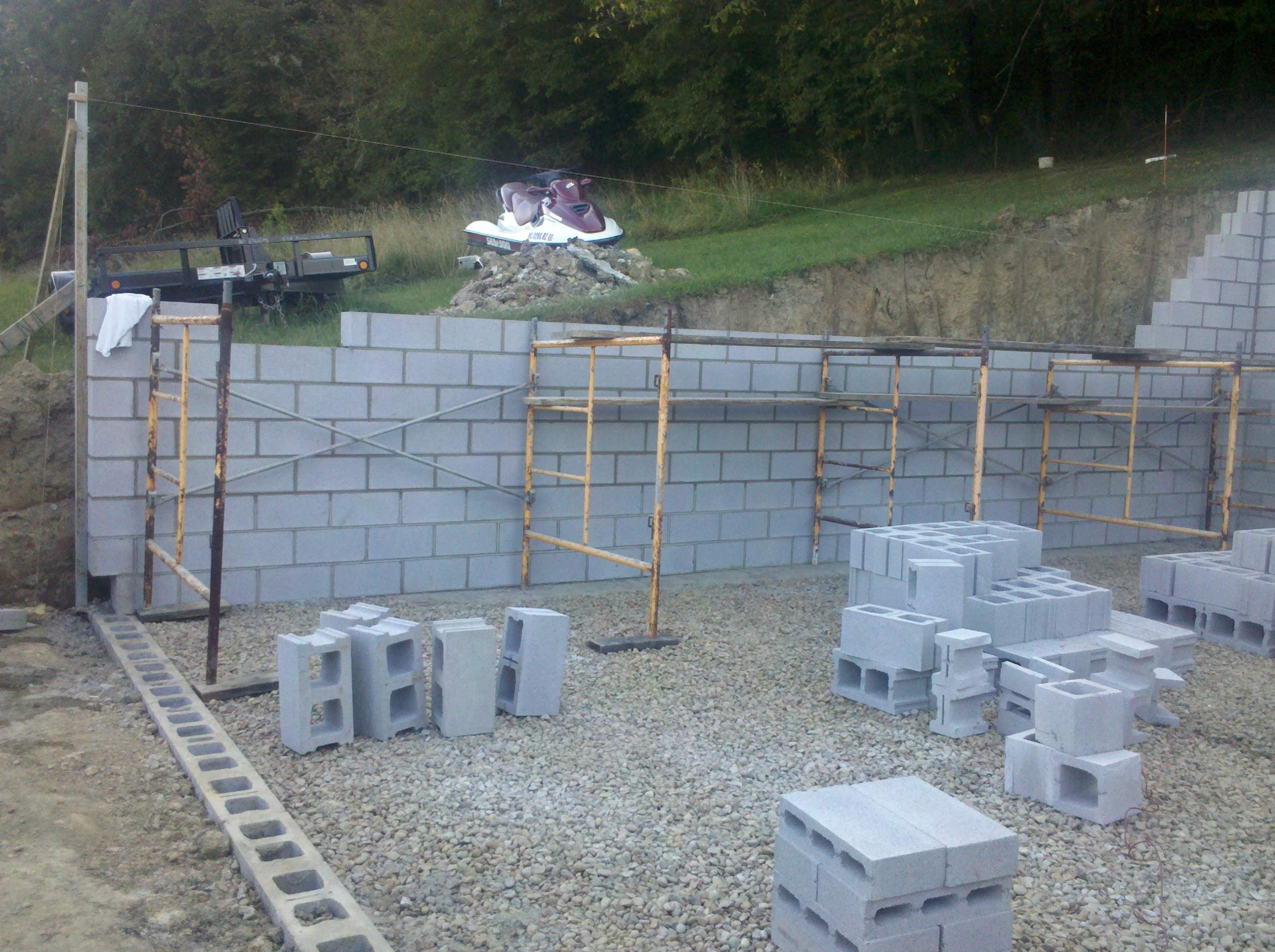

Up to date now on pics. We added an extra course of block to get up to grade. I'll be using attic trusses for some storage space upstairs, and planning a stairway in the back of the building. Planning on filling all the back wall blocks with concrete, and side walls every other one. Also planning backfilling gravel behind the back and side walls 1-2' all the way up to grade, and swaling the ground away from the building. Footer drains are already in, and gutter drains will be tied into same.
Couple of questions for the minds out there;
1. I'm concerned with the back wall and structural integrity, any additional strength features I can add to offset all the ground against the wall? Would it help to build a tight 2X6 wall on the inside back wall?
2. Should I add an outside access to the upstairs storage, at the back of the bank? Advantages/disadvantages?

If you are worried about clay moving to break the wall- you need to think deadmans T. this is for the extreme measures, but the best thing to do is have good drainage behind the wall to releive all water hyrdaulic presssure. this will insure the wall to last a long time.

A deadman is a piece that attaches to the wall and then anchors into the bank. Think of the base of the T attached to the wall and the top wide part bured. The top part is like an anchor that pulls back against the force of the wall trying to pull away.

....Planning on filling all the back wall blocks with concrete, and side walls every other one....
Put re-bar in the block cavities bef you fill them.

having just dealt with block walls myself, one thing that our PEng. suggested, to add tensile strength to our 50' wall were bond beams (hollowed out course of block with horizontal rebar/concrete) half way up the wall.
A little after the fact for you (as it was in my case as well:D). His other suggestion was the one I opted for... vertical rebar runs, filled cores and stone backfill to grade.

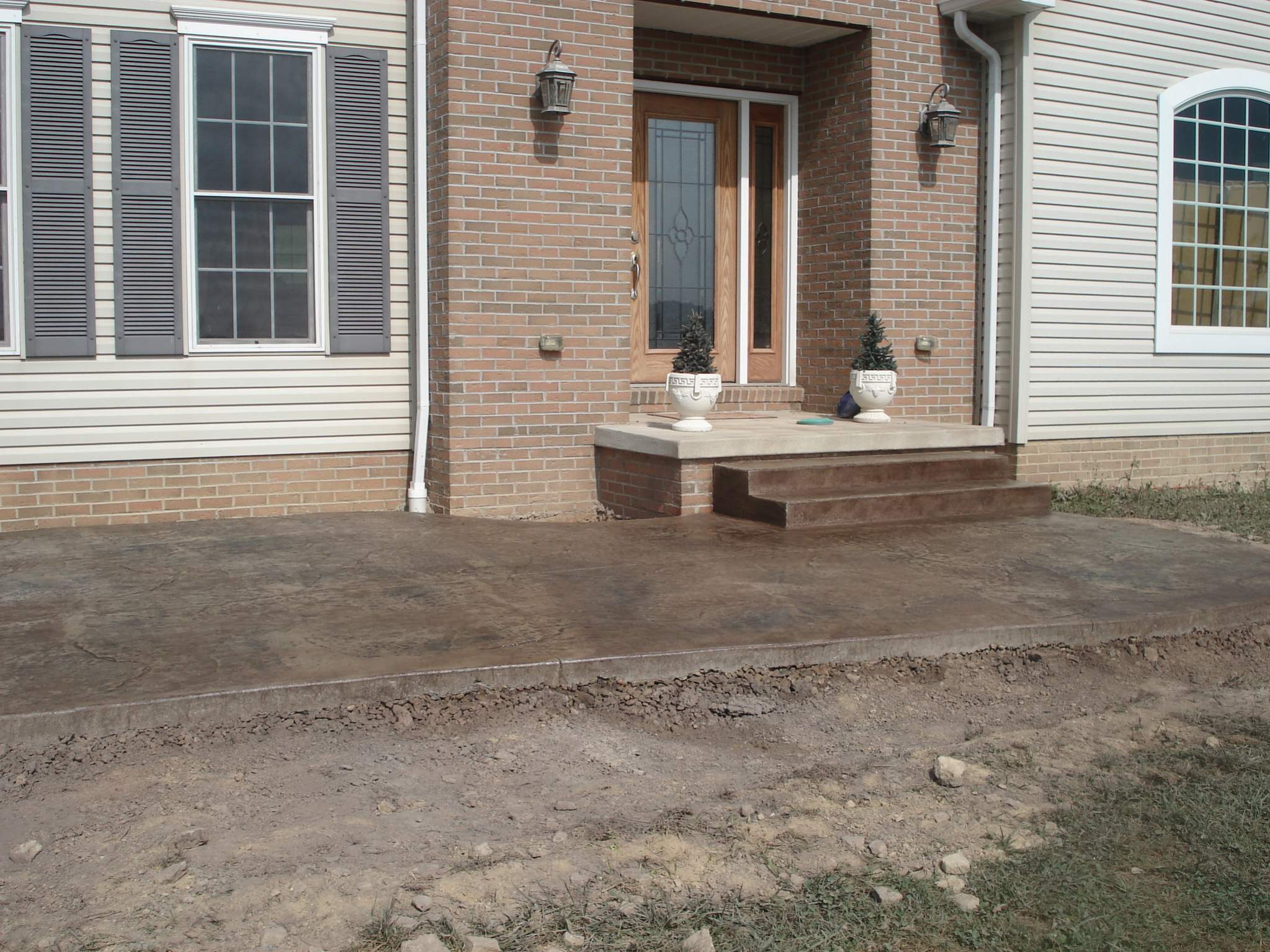

Looking good, scout! On the third photo above, what is the painted-looking line on the right side of the blocks sloping down about ground level? Is that some kind of water proofing? Sorry to keep harping on the water seeping in issue, but, man, have I seen some water problems with below grade concrete/blocks, etc. If you build below grade, you MUST make sure no water will seep in. I think you are covering it with the drain you mentioned, and definitely sloping the grade away from the wall will help, but water does have a way of its own... Keep the post and photos comin'.
What is buttonboard? Some kind of water proofing?
/ Breaking into the bank
#35
Blocks filled in. 2nd picture shows the buttonboard. The waterproofing company used it on the cracked wall on the house, so I decided to add it to the back wall of the shop. Just another soldier against water!
Maclawn - yes, the black angling line is waterproofing. With solid drain pipe, (holes on top) and backfilling gravel all the way up the block, it should give the water a way out and away from the foundation.

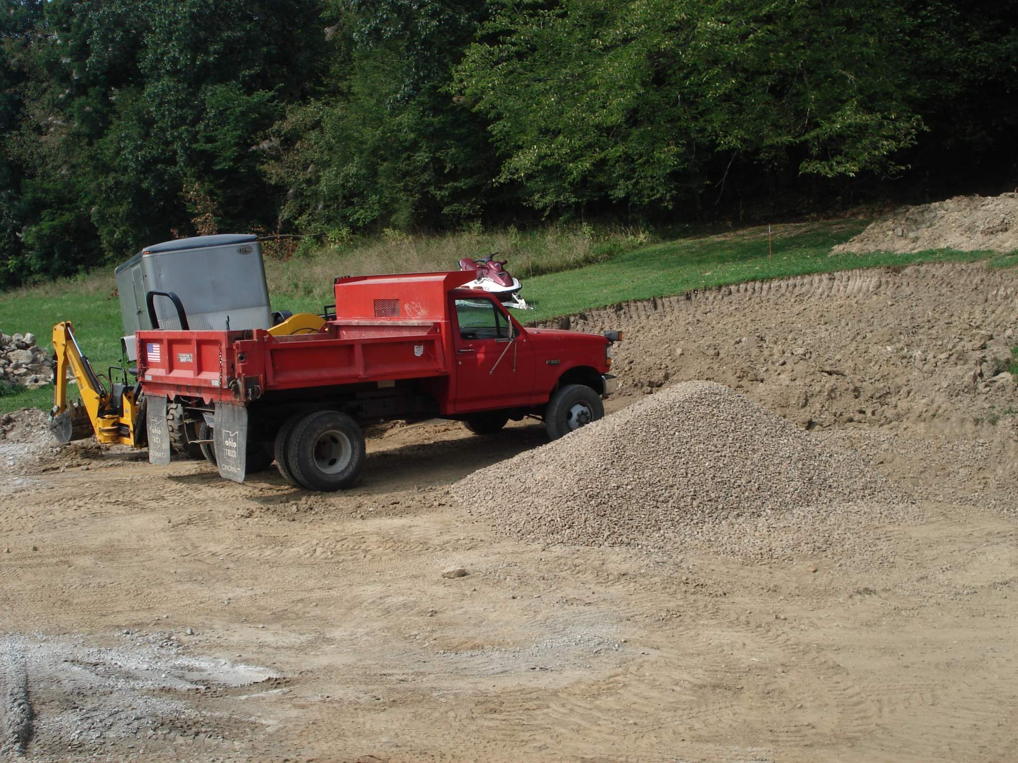

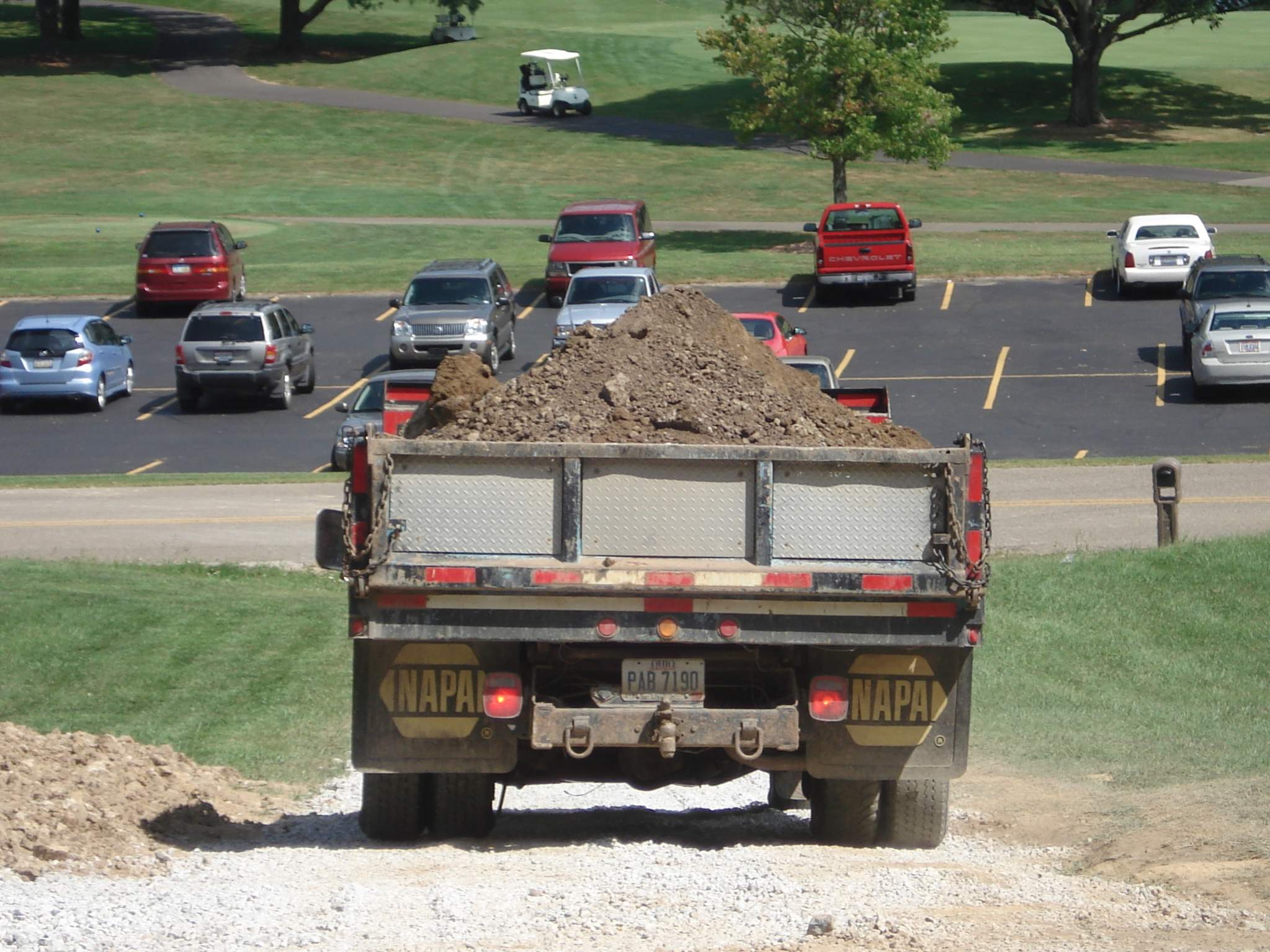

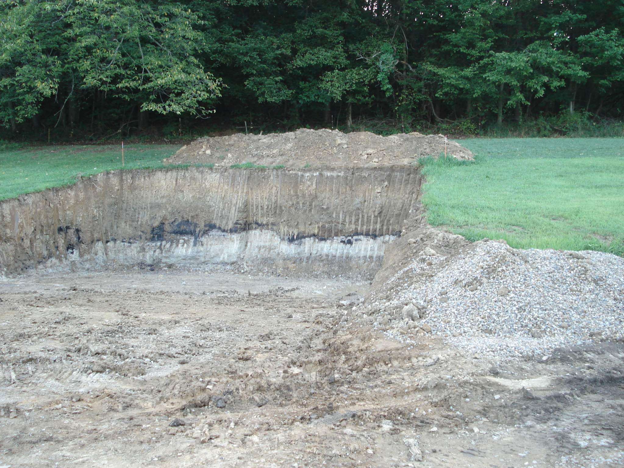

Back-filling the walls with gravel.....

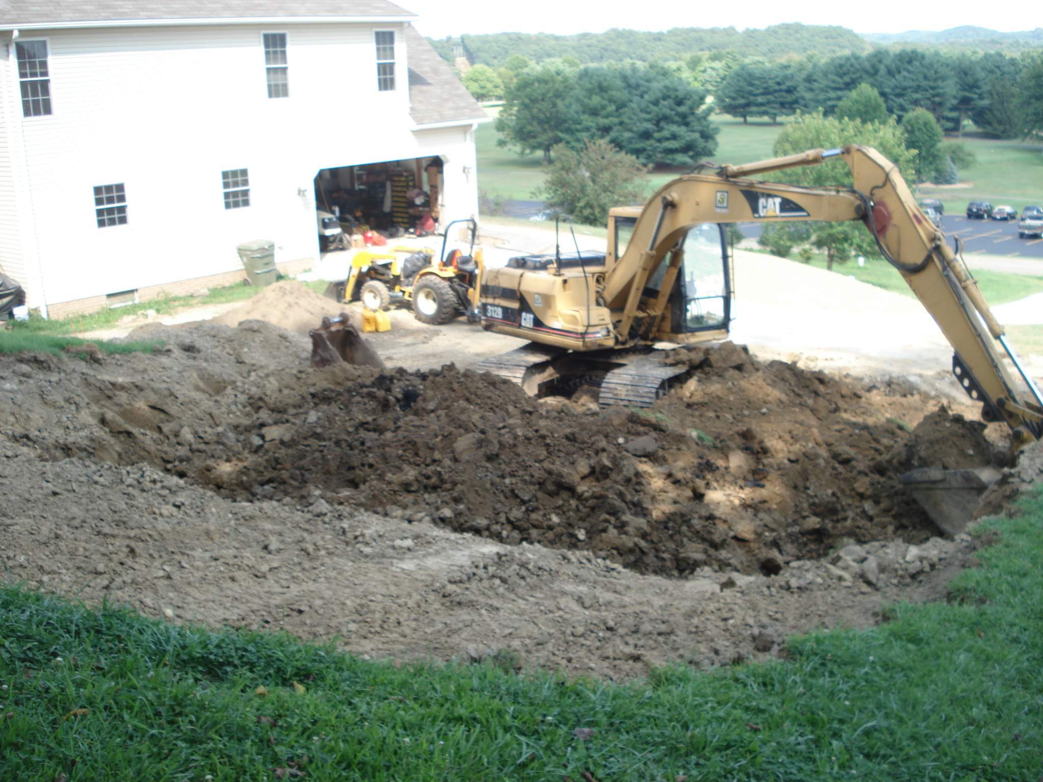

With all the attention you've paid to drainage and sealing, your walls will probably be OK. Particularly for a long run of wall, one or more deadman anchors can help prevent buckling. Alternatively one or more buttresses on the inside of the wall can brace it (but break up the smooth wall run). Here is a discussion of some of the issues and solutions:
Retaining wall - Wikipedia, the free encyclopedia
One of your pics shows a huge, paved parking lot just below the house. You must throw really big parties; its nice of you to provide paved parking for your guests...or maybe that's contractor parking?!!

Bob - tks for the link - good info!
The parking lot is for the golf course right across from me....gets to be a bit aggravating listening to all the happy chatter and knocking balls around when I'm on the hill slaving away!
