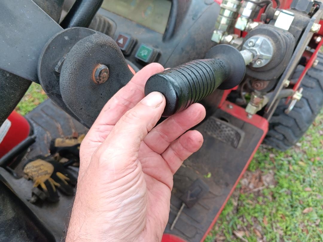

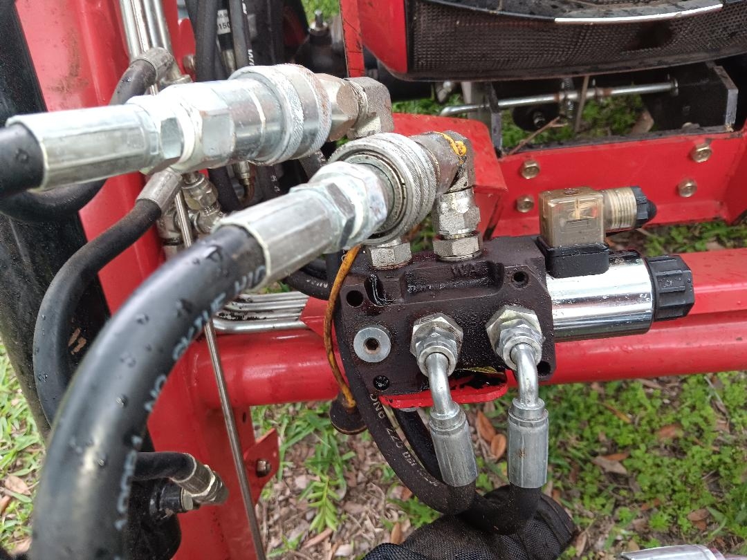

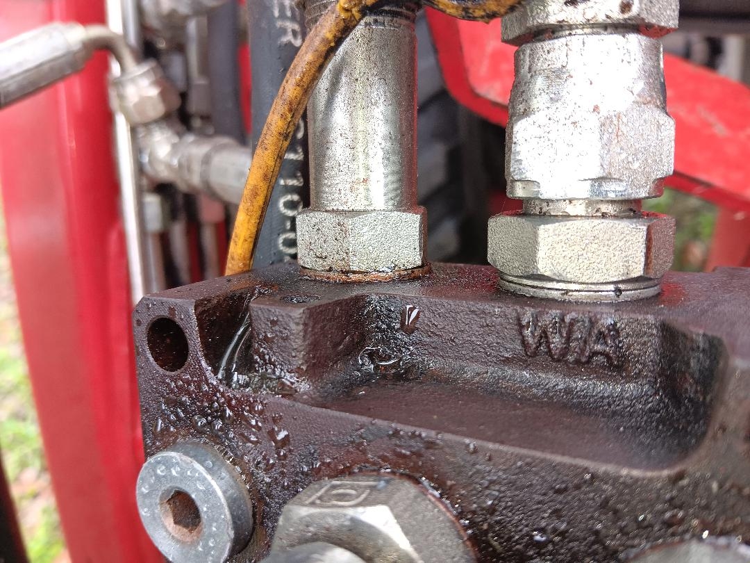

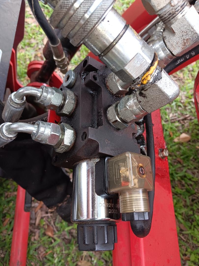

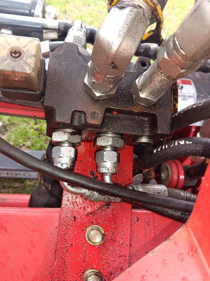

2021 Branson 2400H with push button on loader stick diverter valve.
Leaking at fitting.
Are these WR Long or factory from Branson?
Looks like crush washers like brake lines? Or O rings are bad.

   / Branson diverter #2
Have you tried tighten the fittings a bit more? Often it helps with sealing washers.
If not, you can either get copper washers or dowty washers.
EDIT: I would try to clean everything as good as possible and then try to identify the leak more accurately.
   / Branson diverter
They tell me it's a BZ00723B
   / Branson diverter

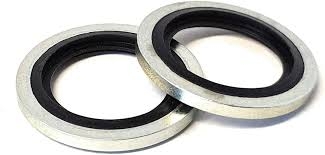

Looks like 2 different sizes. Did tighten but still leaks slightly, where does ones get these washers?
   / Branson diverter #5
Just google "dowty washers" or "bonded washers". Probably Amazon has tons of those.
Threads looks like 1/2" BSPP to me which would mean a 1/2" washer but you may want to take one of the washers out and measure.

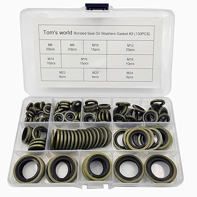

   / Branson diverter
These I assume?

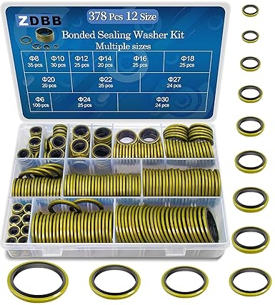

   / Branson diverter
Just ordered these. Hope they work.
