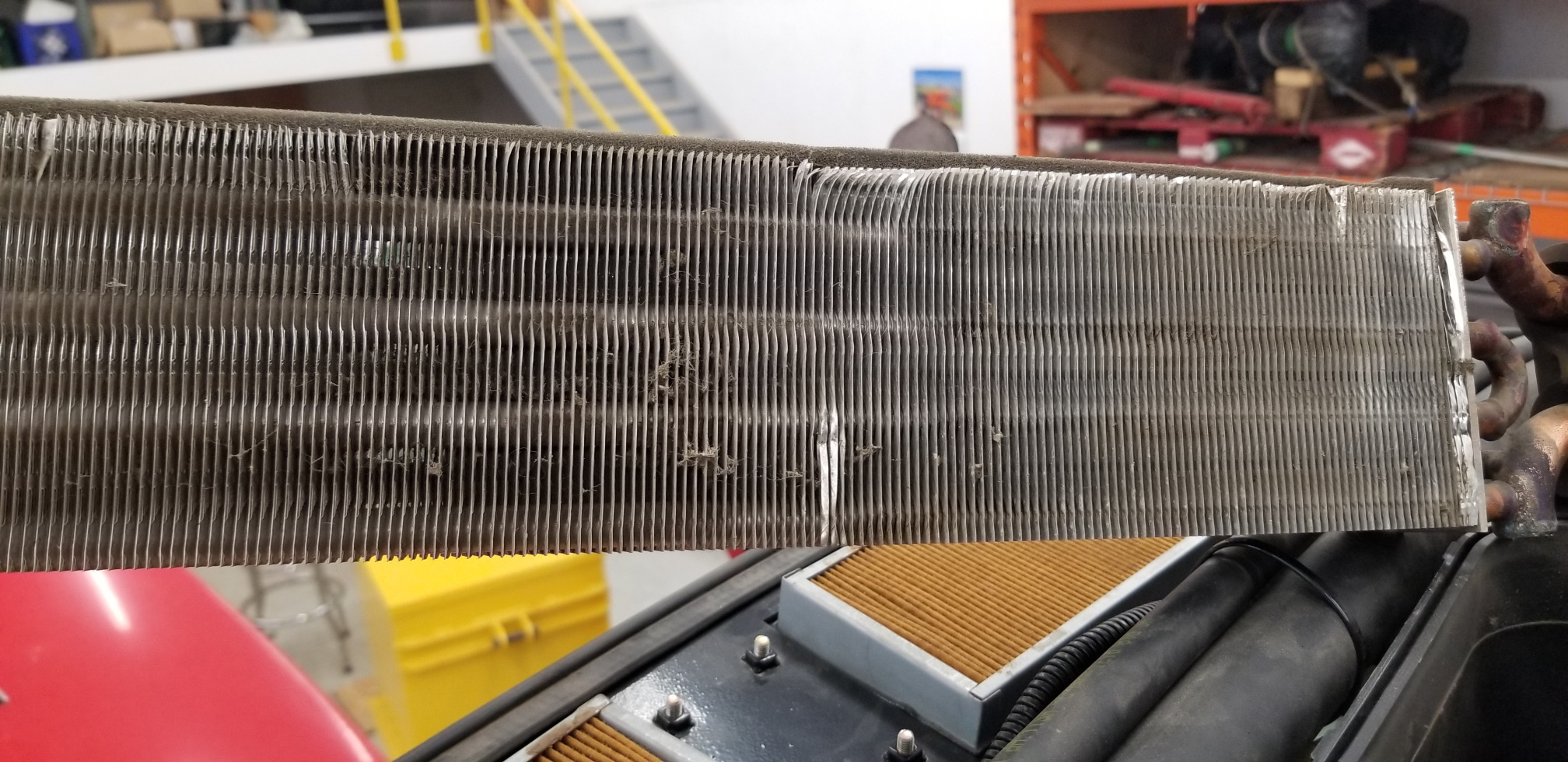

Did you ever pull apart the AC unit in the roof and clean out the evaporator and heater coil? I've worked on these tractors since they were new. The AC constantly recircs some of the inside air without filtering it.

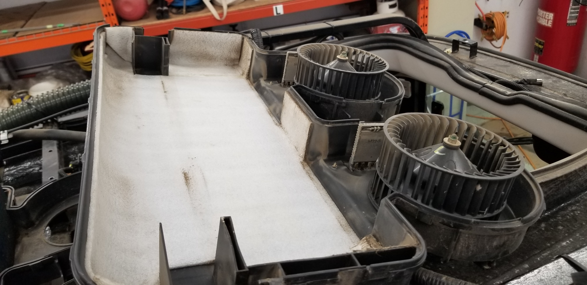

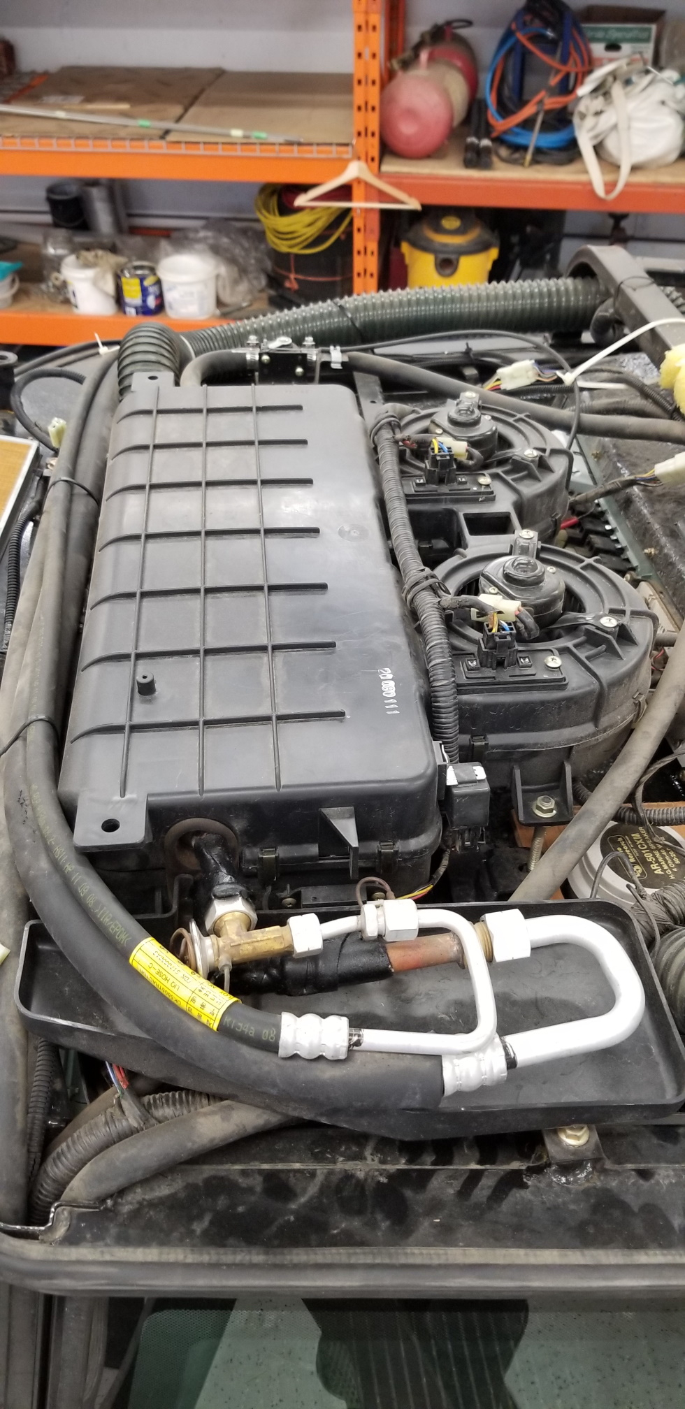

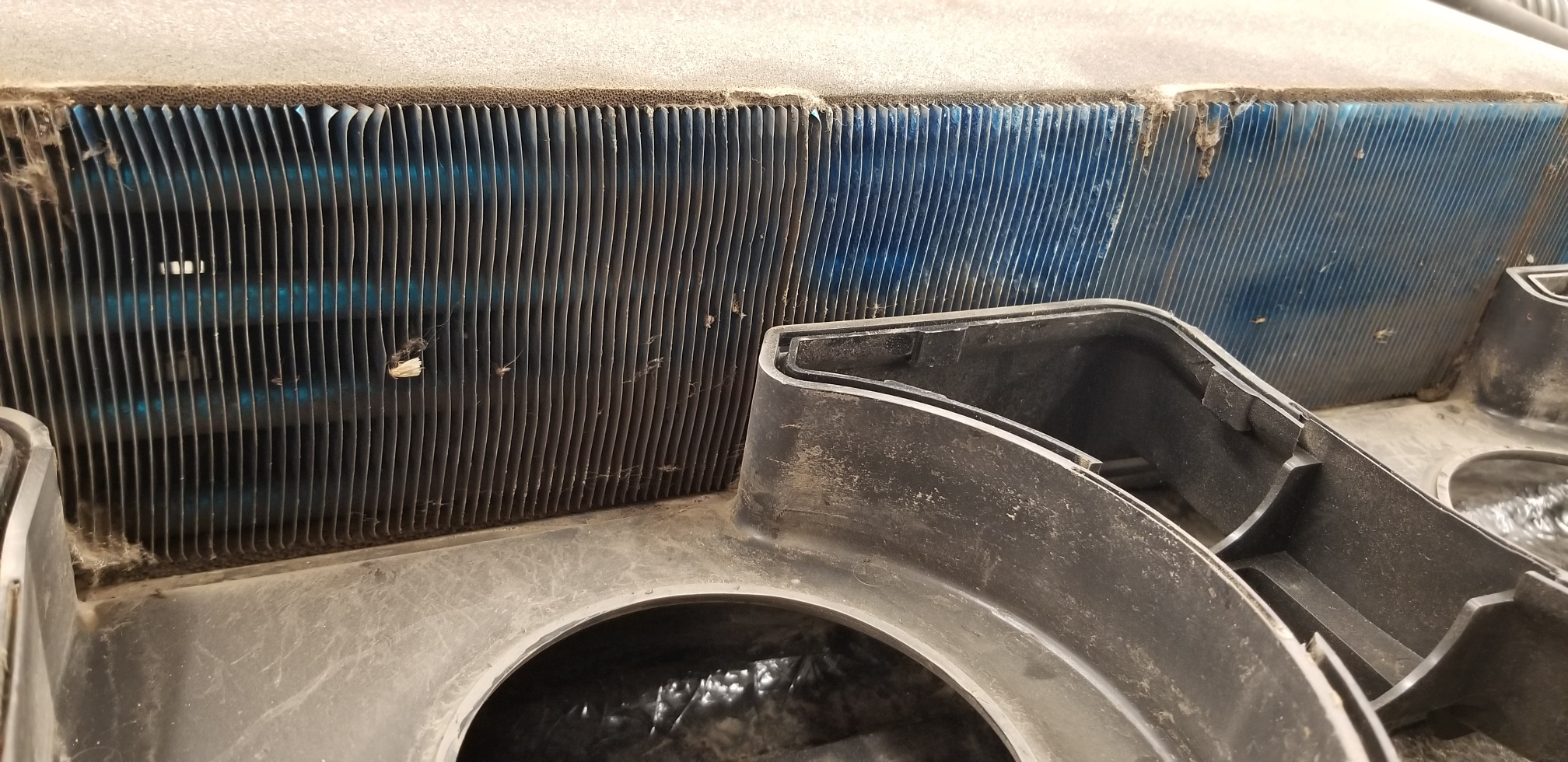

#39
Yes, i thought i had posted some photos of the evaporator and heater coil. But i did open up the enclosure and blow out the dust and dirt, which was minimal. I will take the front end apart so that i have good access to the condenser and reclean it as well. Bush hogging mature growth can put a lot of stuff up into the screens. The problem is that it is a major job to get those rads separated to do a good cleaning. Poor design of the oil cooler, condenser, rad, battery and air filter arrangement on this tractor. In fact the battery and air filter box are in front of them and block more then 60 percent of the surface area. Images show them as found not after i cleaned them up.
