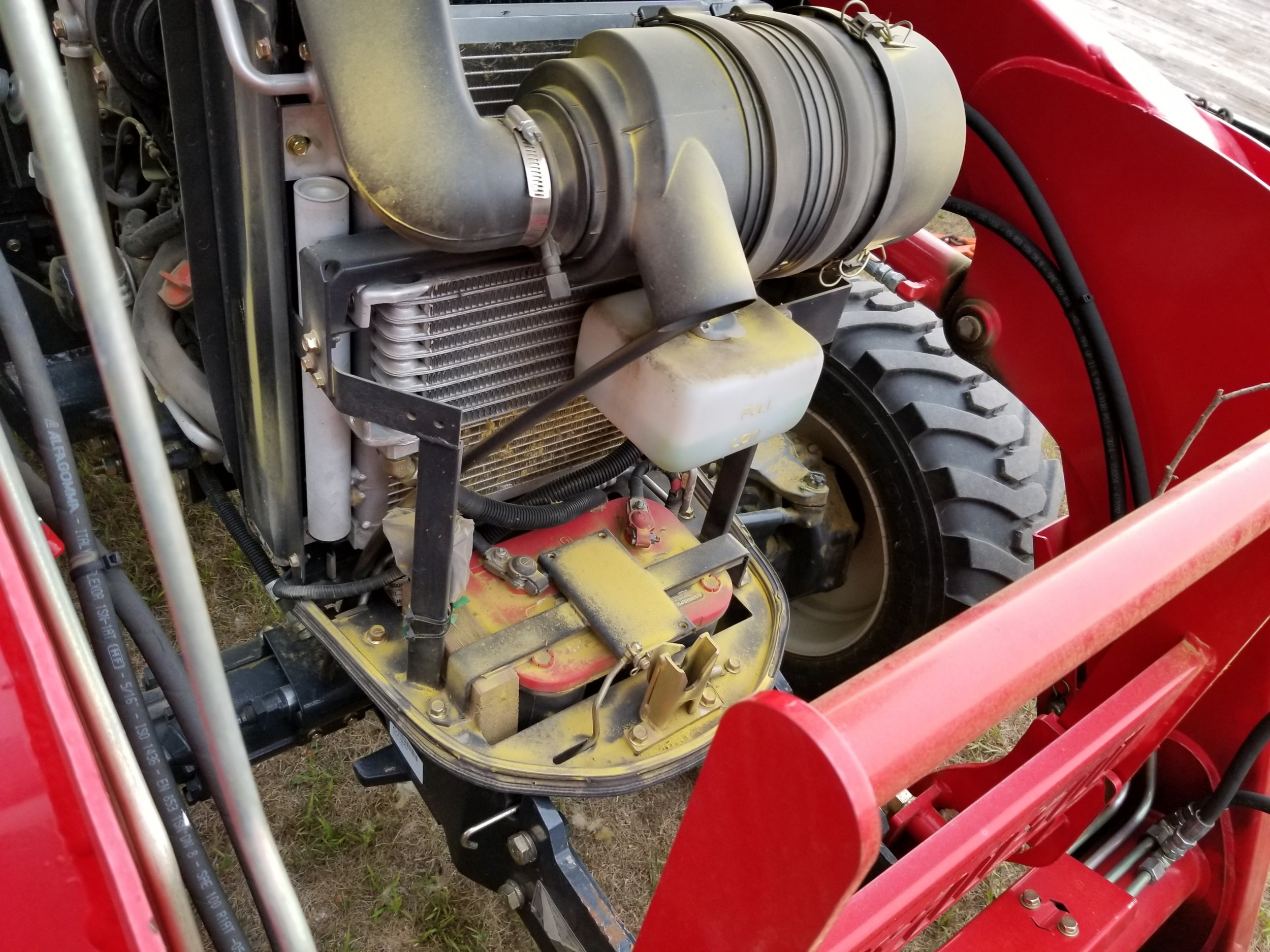

Hi Slim, I wish my tractor had the access yours does. For one to even get the front grill off, you have to remove the metal grill guard first, as you cannot lift the grill up, but have to remove it forward. Second, your battery is dropped down into a box, where the 6530C has it on a plate at the same level as the bottom of the rads. and then everything i behind screens. I will post a photo of this once the tractor is back home. It is to be looked at today to see if the AC system has any leaks.

Those look interesting, I have not seen anything like them in my travels but will look on Amazon here. I picked up the tractor today after the AC was looked into. Seems I must have a very slow leak, as there was only 6 oz of gas in the system and it should be almost 3 lbs. They pumped the system down to dry it and test for leaks, but the system showed none, so it must be very small. They put in the dye and refilled, so it is a wait and check in the near future to see if the dye shows up the leak.
Here are some images of the front of my unit, and you can see that it is not at all easy to get to any part of the system to clean, not without doing a fair amount of disassembly.
I will also have to watch the relays and fuse to see if they act up again.

Slim, is that yellowish stuff pollen or is it just dust?
That was all pollen. There were some seeds clinging to the lower area of the condenser, and a bunch of seeds clinging to the outside of the grill, but those blow out easily.
   / Branson 6530C seems to be hot under the hood #31
Wow Dc, your access for cleaning is worse than mine (which looks almost exactly like Slims). And I thought mine was bad and a pain to clean. It was necessary to pull the radiator to clean it on mine. It looks like a nightmare of a job but it really isn't that bad if you just look at it and approach it systematically.
