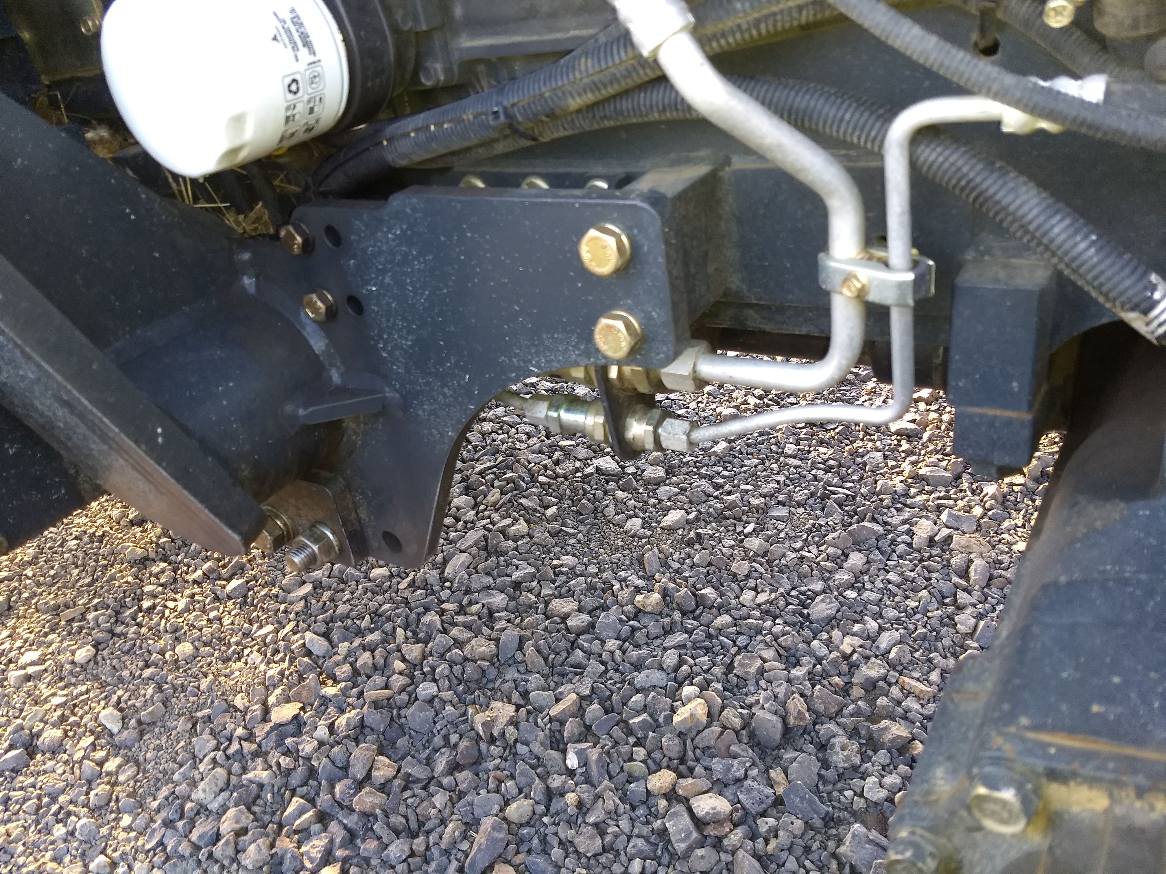

He was wondering what those "block valves" are. He has never seen them before. He noticed the line hot on the infeed end to the one on the evaporator feed line and cooler on the discharge side. I did a search on the internet on "Block valves in auto AC systems" and came up with nothing. I can tear them apart when we take the system down again, but I hate tearing apart things that may not need torn apart. There is also an identical one on the suction line to the compressor. Could they be check valves that prevented all the Freon from leaking out when I changed the hose?

Those "block valves" look like ball checks that I have seen in hydraulic systems. They are strictly mechanical and are in the line from the condenser to the evaporator and the line from the evaporator to the compressor. View attachment 664920 If they were check valves though, one would seemingly have to be installed backwards to work as a check to prevent freon from leaking out when opening the compressor end of the system. They are overly complex to serve just as a manner to join line sections. They really have me curious. (??)

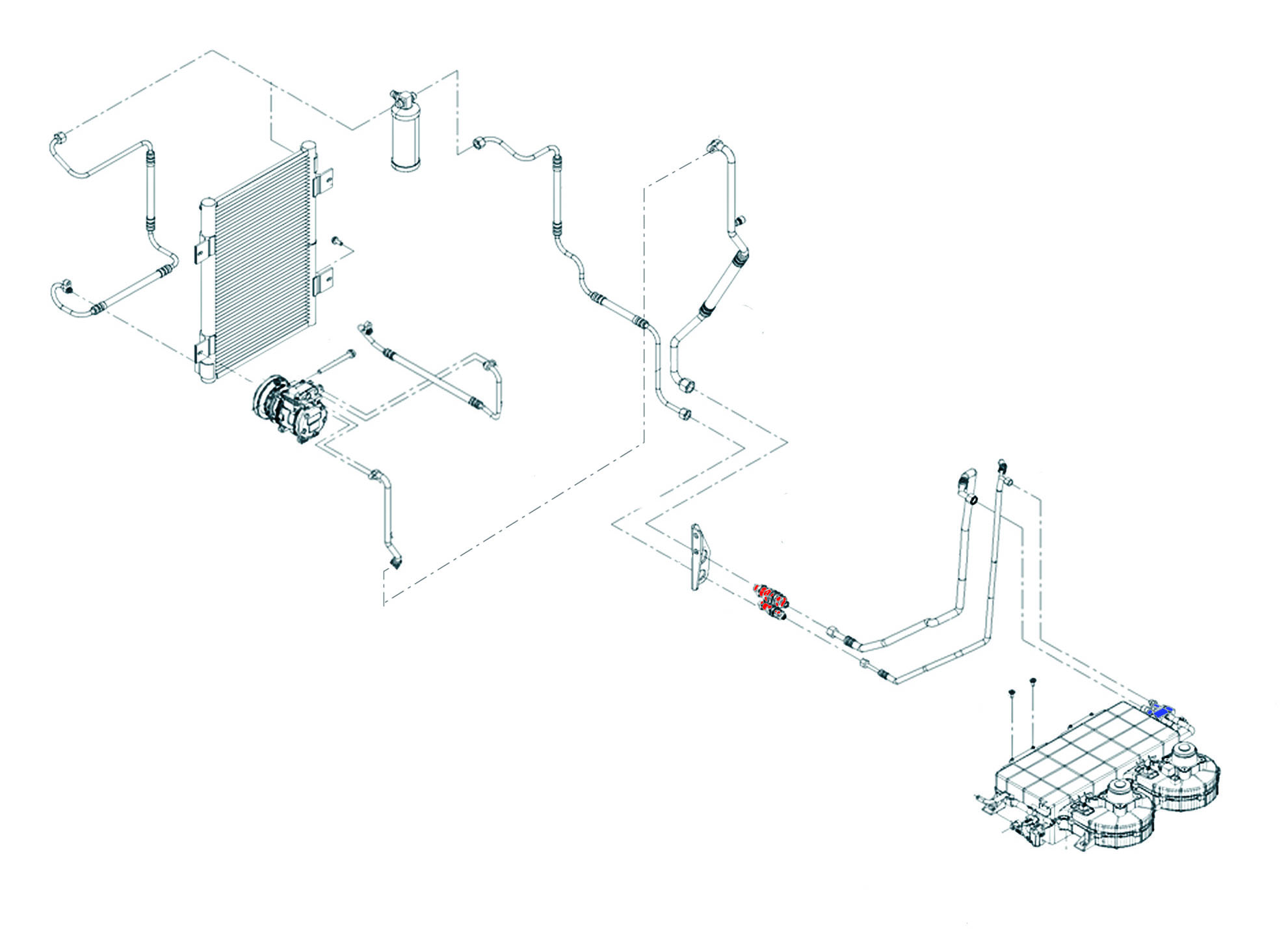

In looking at page K25W-201504 of the 20 series service manual which applies to the 4720, the "block valves" look like they're just bulkhead fittings, not valves. Here's a picture of the diagram to help envision the schematic of the pattern, and I've colored the "valves" red. The expansion valve is on the evaporator, and I've colored it blue:

Those "block valves" are shown on page 194 and 195 as keys 5&6. they are called "Q/C 7/8" and Q/C 5/8" and do have a Branson part number. They could indeed be just bulkhead fittings and they have a bad translator. It is funny that the parts diagram doesn't show the expansion valve or the dryer receiver, yet I can buy them if I call the dealer. And my tractor definitely isn't exactly the same as all the things they show.

Cougsfan I took the Q/C to mean quick coupler. Most likely like the couplers that are on some vehicles requiring a plastic tool to release a spring band to pull them apart.
Fuel Line and A/C Quick Disconnect Tool, 6 Pc.
If you get a chance post a photo and that could be confirmed or dispelled.

I did post a photo of these block valves in an earlier reply, TractorGuy, but it came out as an attachment. I will try again.

Here's a good clue from Wikipedia:
A type of externally equalized thermal expansion valve, known as the block type valve, which features an internal sensing bulb (often the valve's metal body, particularly when a stable and hunting-free refrigerant flow control is required), located inside the suction line connection and in constant contact with the refrigerant that flows out of the evaporator's outlet, is nowadays often used on automotive evaporators.
