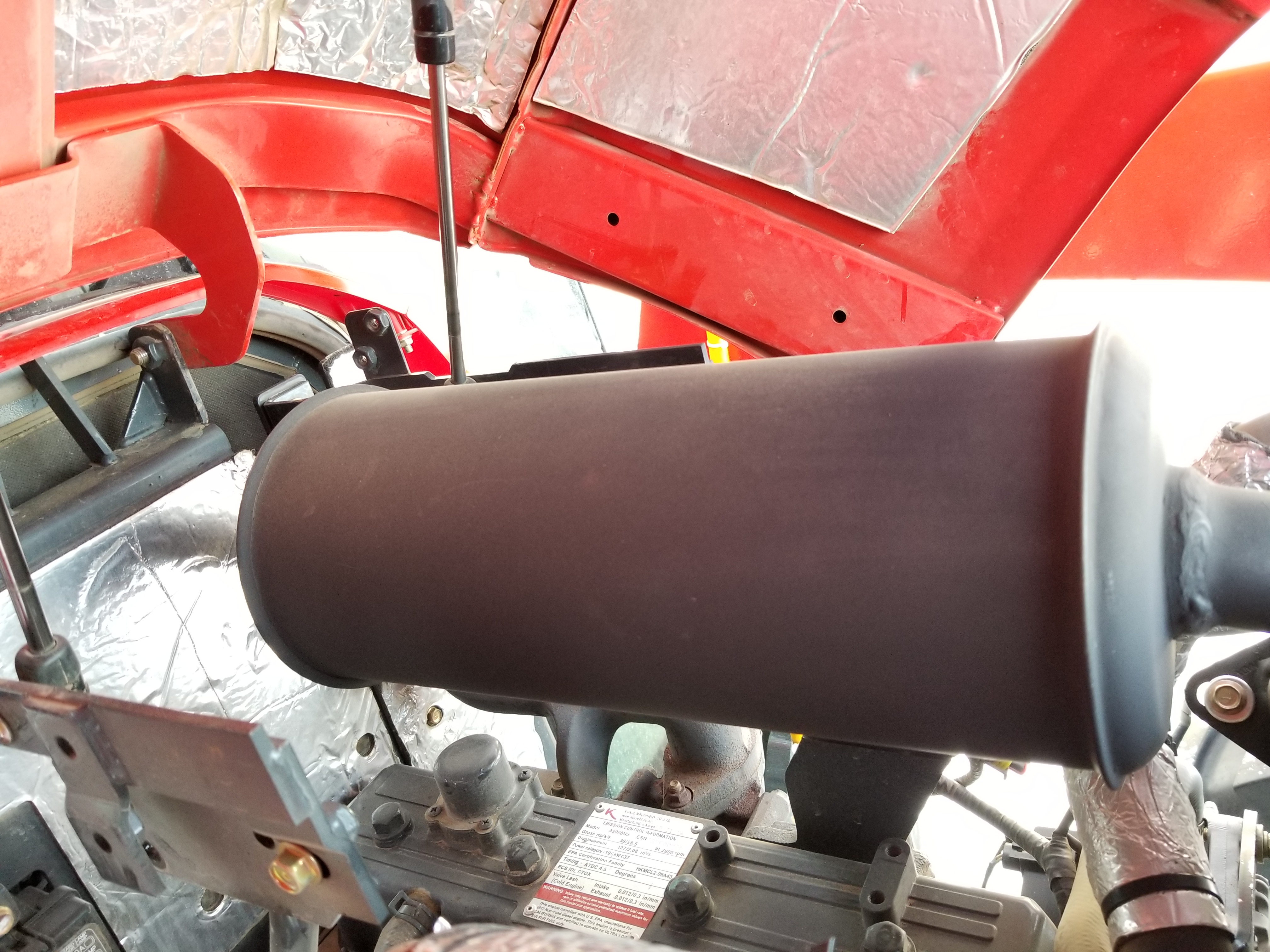

I doubt it will matter, depending on what your shop does. My guy cut the existing pipes completely off of the Stanley muffler and welded on his own pipes. Maybe you can kind of see it in this pic:
He welded his pipe more or less directly to the muffler body, just using a slight stub to weld onto.
That's why I was thinking it probably wouldn't matter for your install. But obviously you want to go with whatever your shop wants, they have the plan.

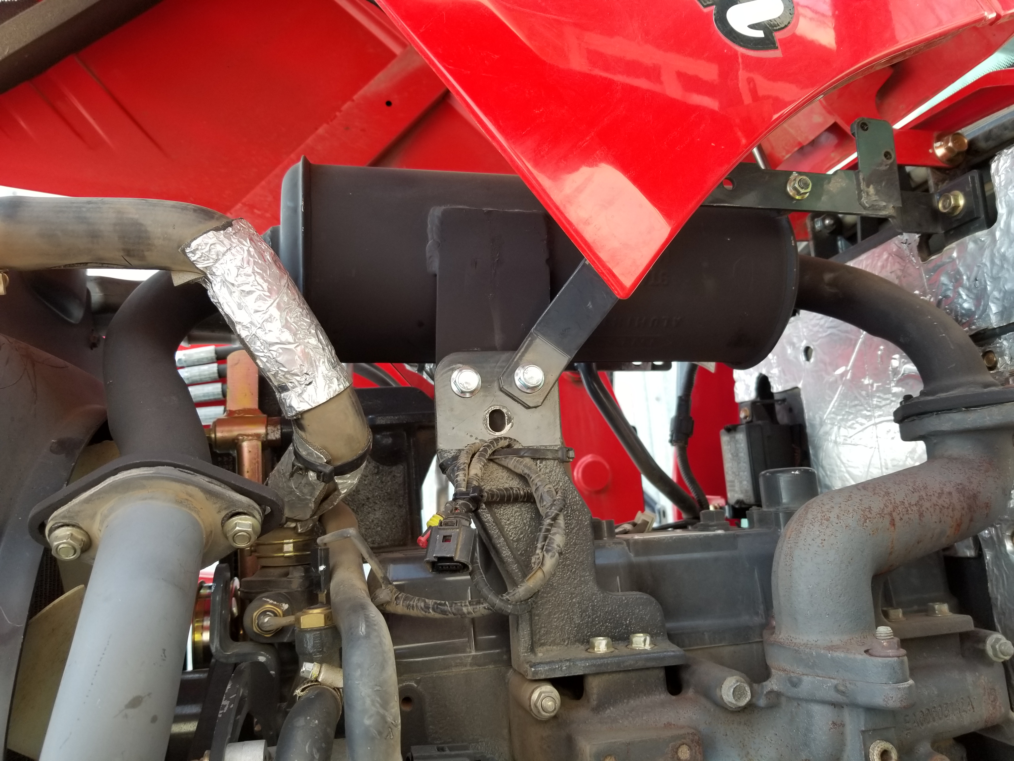

I was able to get the flanges made and picked them up today. I reinstalled the DPF and am taking the tractor to the muffler shop next week. I am planning on taking a few days off to get this done. Probably Thursday and Friday. That way I can stay and help as he is a one man shop. Work gets in the way of progress sometimes but I do like eating so can't complain to much.

Exhaust mod complete. We ended using a turbopack type muffler. It looks like a glass pack but it is not a straight thru. Sounds really nice, not too loud at all. Not much different than with the DPF. Turned out good but we did not paint today. I will paint it another day when weather is better.
Tomorrow morning we are doing the second PTO dyno test. I will post results tomorrow night! Thanks again for all the help to everyone!

That's a nice and clean install! Very nice K5!
A coat of paint and I would say it's a factory install. :thumbsup:
