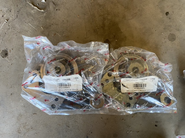

I am at somewhat of a standstill waiting on the Knuckle arm and thought I would share a funny little story about this upgrade kit.
The kit I received was apparently for a tractor with two left sides and no right side. Did not know they existed. Anyway, when I called the place I ordered from he said oh it was my fault I put that kit together. Unfortunately, I am out of the right side knuckle arm but have some on order. They are on back order but I will get a ETA and call you Tuesday. Well, I did not hear from him so I called Wednesday and asked if he found anything out. He said no but he will send another email and call me.
Yesterday I called again and asked if he heard anything and he said not yet but if I don't hear anything by noon I will take one from another kit I have and send it to you. He then said he hates to break up a complete kit. 😂
I told him I understand, if it makes you feel better send me another complete kit and I will send you this one back. My tractor has a left and a right side. He said well, let's see what Branson says. So I have no idea if it is coming or not.
Now I know I am not very smart but if you have the part in a kit that you screwed up on putting together in the first place and sell it to a customer, go on and make that customer whole. But maybe I do not understand the big picture. :ROFLMAO:

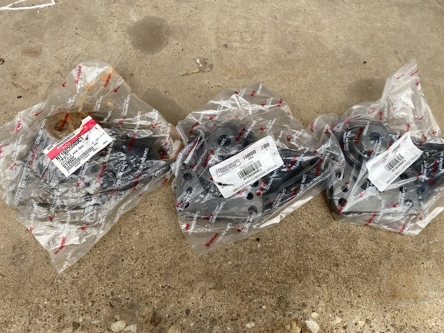

Project still on hold. I finally talked the parts guy into opening another tie rod upgrade kit and send me the right side knuckle arm. I received it and went to install today and low and behold it is a left side in a right side package. I now have a total of 3 left side knuckle arms and 0 right hand.
We are back in the cycle of waiting on him to get with Branson on Tuesday so they can reimburse him to reimburse me. Lol
At least the part number was correct so at least there is progress.
On a positive note I did receive the new loader valve that will be nice for whoever ends up owning this tractor. I got a 3 spool valve with joystick for loader and a extra spool for third function. I already have the hoses made up with fittings to go to the front of the loader.
How about just turning the left knuckle upside down for the right side? LOL Don't you wish it were that easy?

The latest update is Branson is sending UPS to pickup the knuckle arm that was packaged wrong and when the correct one is back in stock they will send it to me. I have my doubts but I will give them a chance before I send it all back and try a different way.
/ Branson 4520 rescue project!
#97
Well Branson finally sent a label for me to send back the wrong part. It has only taken a couple weeks to get a label. I will be 90 before the actual part arrives. Lol Anyway I took the old knuckle arm to a machine shop to resize and taper the hole. That way I can continue going back together and change it later if a new one ever arrives.
