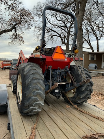

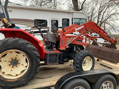

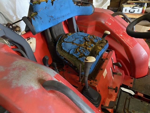

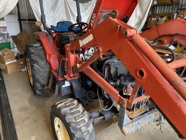

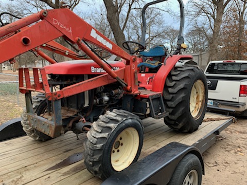

As many of you already know, I committed to taking the challenge of getting a 2003 Branson 4520R back to work! What a big dummy I am! :laughing:
The easy way would be jack this dude up and drive a new tractor underneath. This poor thing has been abused! It looks like it spent a few years at the bottom of a lake somewhere! Every lever is ceased or otherwise inoperable.
I have no idea what all is wrong with this thing so no promises it will ever go again.
The known is as follows:
1. Injector Pump not pumping.
2. Nothing electrical works except the fuel feed pump.
3. Every hose will need to be replaced.
4. Leaks from just about everywhere.
5. Loader valve will need updating.
6. Tires will need some repair or replacement.
7. Seat is toast!
8. Missing floor panels.
9. Body needs quite a bit of work.
10. Missing draw bar.

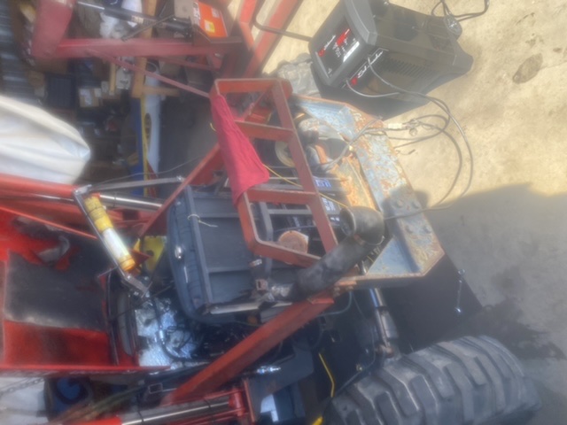

The first step is to get into the shop. Not easy because of all the stuff I keep for who knows what reason. Anyway, I decided to get a battery for it and replace the cable ends. This allowed me to use the starter to back it off the trailer into the shop.

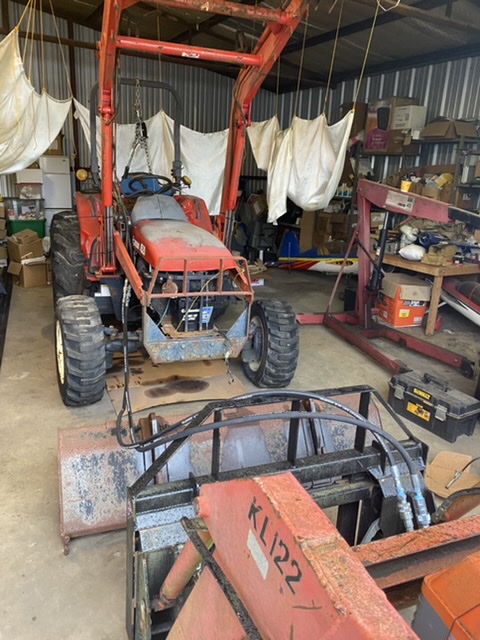

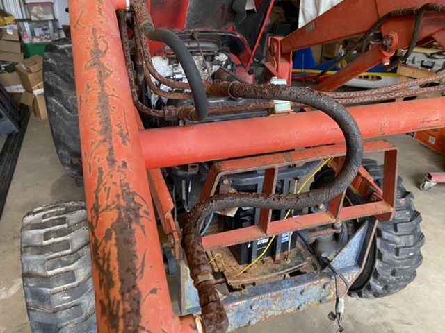

Now I need to get the loader secured out of the way for safety. I started with a Come Along chained to the ROPS but quickly realized BAD idea! So I made up a couple of hoses and connected to the old Kioti third function valve to perform the lift.
After a lot of 50/50 Acetone and automatic transmission fluid and some gentle persuasion(a big shop hammer), I managed to get the bucket off to reduce weight.
Then cut angle iron to support the lift cylinders.
Now I can start working on it. I will update this thread with progress as I have time to work on it. The first goal is make the engine run. If that fails, the rest is useless. :confused3:

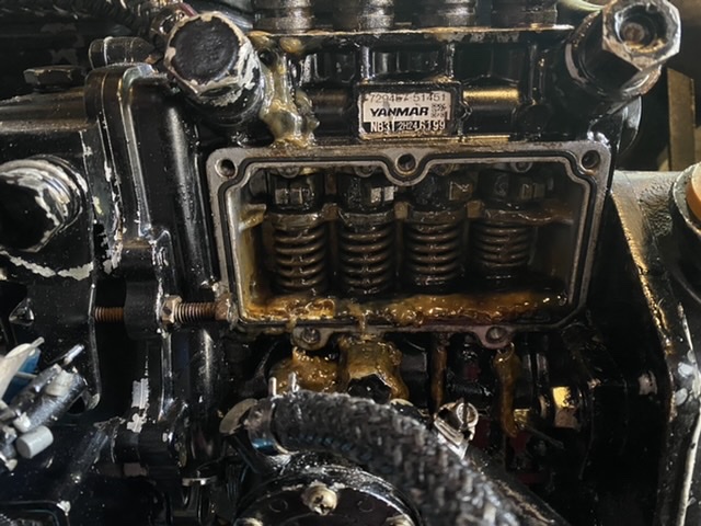

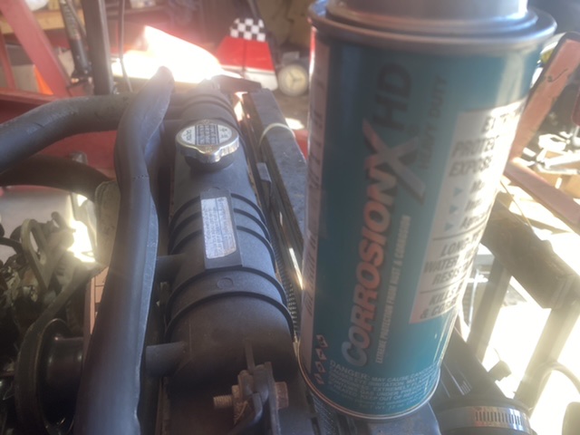

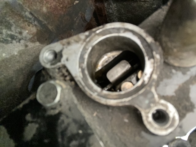

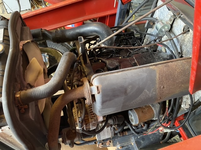

Well, I took the stop solenoid off and the fuel delivery rack was definitely stuck. I removed the side plate of the injector pump and found plunger 1,3 and 4 stuck up.
I removed the check valve for number 4 and filled with acetone automatic transmission fluid mix. Then used a brass punch to drive plunger down. Reinstalled check valve and it stuck again. So I used some of my Corrosion X that I only use for special occasions because of the price of that stuff! Put it together again and it freed up. Repeated process for each plunger till they all are free moving.
I then ran a hose to a new 5 gal Diesel pail with two gallons of diesel and a can of sea foam. I bled the lines and it smoked but would not fire off.
The fuel filter is bad but allows fuel to flow. I decided to bypass it for now with a inline filter. Then I removed the check valves again and used some more Corrosion X to make sure they moved freely in the body. Put it all back together and bled the lines again.
Hit the starter again and she fired up! She smoked like something crazy but as it warmed up it started to clear.
The radiator is dry so I shut it down to let cool. Started it up a few more times and I think the engine will live again!
192D1C12-102F-4C3C-94E2-C771CDA31D61.jpeg 3066D923-A2A9-4CCF-BD1C-93B4EFB793AF.jpeg F0B15037-FA1D-4372-B969-DFC18AECC99B.jpeg E1734625-CFF6-4D70-9C1C-413DE1DDA875.jpeg
I will get some antifreeze in it next weekend and start working through the wiring issue so I can start and stop it with the switch. Then I will have to fill with hydraulic fluid and replace all the lines and power steering lines. The clutch is stuck so I need to get all that sorted so I can steer and get it out to free up.
A lot of work to do yet but happy so far with the progress!
