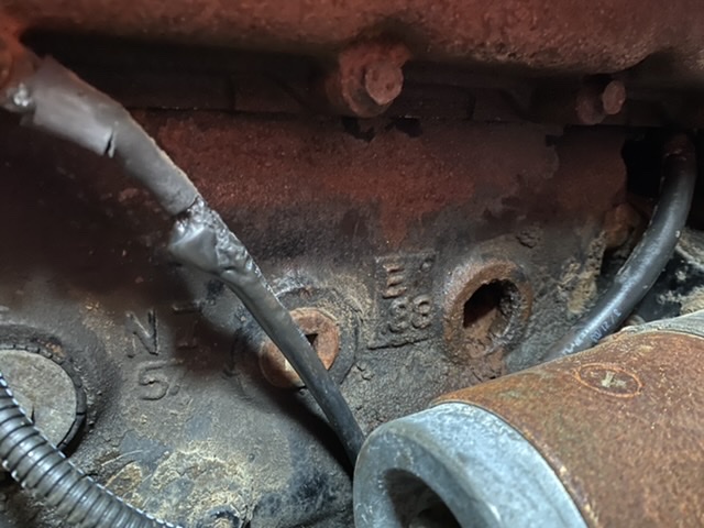

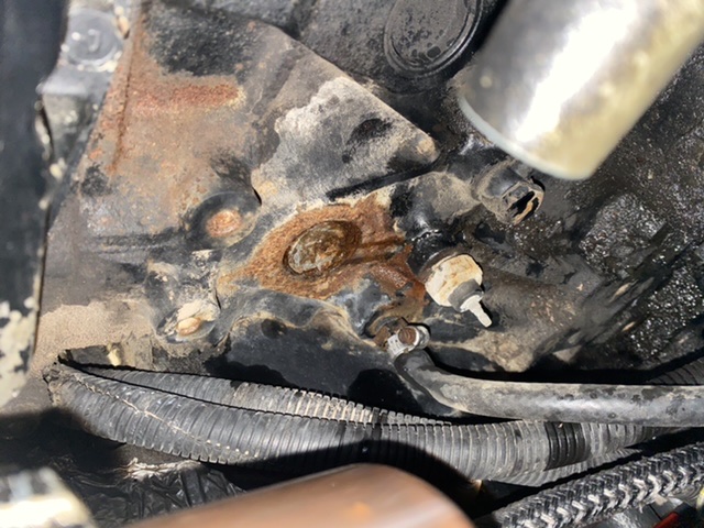

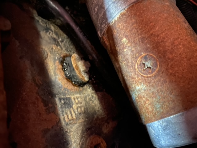

I wonder if the waterpump repair was the reason the freeze plugs and radiator went.
Did it look like their custom gasket job (being kind) blocked any passages?
/ Branson 4520 rescue project!
#69
Everything was open. The failure for plugs and radiator looks like it was from tap water in the system. I will flush with some automatic dishwasher powder to clean system well. Once it is cleaned good and determine no more leaks I will fill with antifreeze.

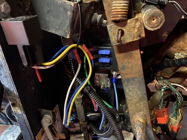

I bought my 4520 new so I have all the original manuals. The service manual has some wiring diagrams and electrical troubleshooting help. I'm not sure it's specific to the Yanmar engine or not.
#73
I would love to have a good wiring diagram. The service manual I have is for the 10-20 series. Closest I could find in the manuals that Asteral posted here.
I still have to get the dash to power up. None of the gauges are working.

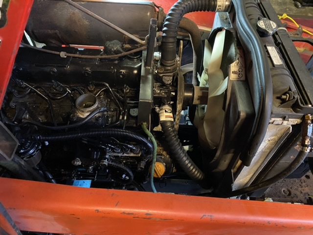

Managed to get the new hoses back on steering valve. What a PITA That was! I cleaned the tank and installed new filter for it as well.
I got the water pump installed and ready to flush the block. I will pick up some dishwasher powder this week to flush with. I do not have running water at my shop so I have to get a little creative.
I decided to rig up a 5 gal drum I had to flush with. The suction side is a little off the bottom so I think the rust will settle out while running. We will see how well it works later. Thermostat was removed for optimal flushing. It is a little low tech but here is what it looks like. :ROFLMAO:

Made a little more headway today.
Replaced the fuel lines from the tanks to the fuel pump. Got covered in diesel but it is done. Apparently women do not appreciate the smell of diesel as much as I do. Wife said I had to take a shower before I sat anywhere. :ROFLMAO:
Installed the power steering tank and mounted the cylinder back under the tractor. Bolted the frontend back down.
I ordered the tie rod upgrade kit and was getting ready to replace when I discovered a issue with the kit. Anyone else see a problem?
Anyway that will have to wait as what I need is on back order.
I put 4 gallons of distilled water in my flush system and added half a box of dishwasher powder. Then fired up the tractor and let it circulate. Worked better than expected. Here is a video.
The dishwasher powder held everything in suspension very nicely.
Good news is no more leaks in cooling system. Also the power steering system works with no more leaks.
Now when the correct knuckle arm shows up, I can get that fixed and it will be close to time to drive it out of the shop and free up the clutch.
That is it for this week. Slowly but surely!
