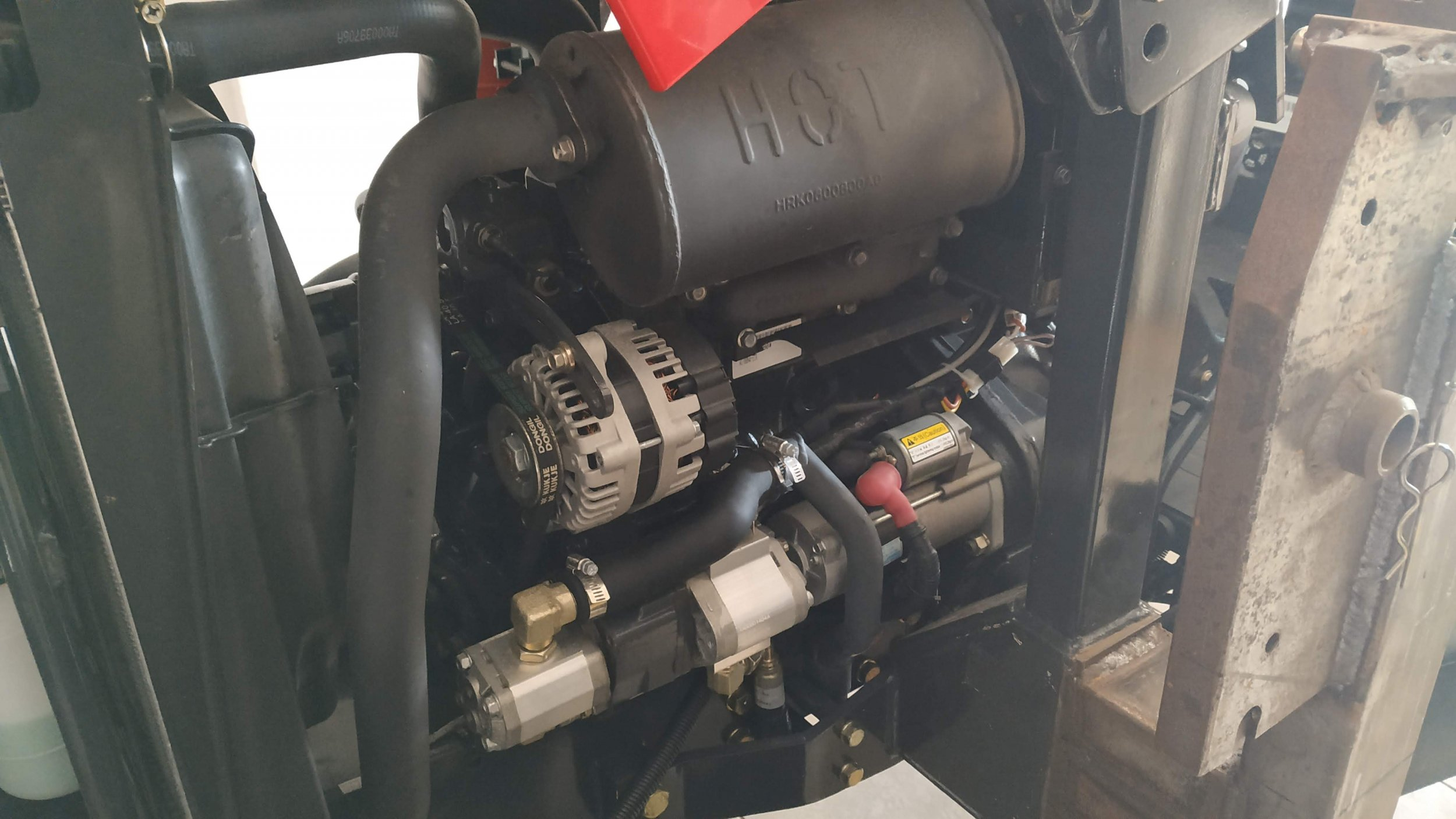

   / Branson 3510 (2004) lost hydraulics (three point and front end loader) #14
Both pumps are mounted on the engine, on the left side.
There is a rubber manifold the connects both pumps inlet side to the suction pump coming from the transmission housing. This is the rubber part that Fixastuff mentioned that's is, indeed, prone to cracking.
I believe my tractor uses the same engine as yours, so the pump setup might be similar. Here is how it looks on mine, with both pumps visible under the alternator.
#15
I’m wrong about pump location, it’s at the engine. I’m going to try to prime it w/oil.
Mike
#16
Thanks Ptsg, I located it
