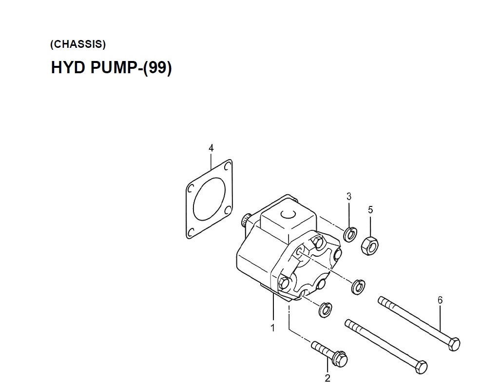

I agree, I’m attempting to remove the pump. I found two long “through“ bolts and two nuts. I removed them all, pump moves around a bit but will not come out. I’m flying blind here, is there a more to it? There is what I’d describe as a cover ( the bolts and nuts fasten the pump to this cover, should I remove that cover? At this point I’ve removed the suction and pressure side hoses/pipes along with the two long bolts and two nuts/washers. Feels like the shaft is connected to something or captured by that cover I mentioned.

   / Branson 3510 (2004) lost hydraulics (three point and front end loader) #29
You can take the entire pump as an assembly.
The parts manual is not very clear, but looks like it's two longer bolts, one stud hiding behind and a short bolt. All the other ones just hold the pump together.
Here is a picture from the parts manual. Hopefully it helps you:
#30
Great picture, those are the two long bolts, but I have two small nuts, slight difference. I’ll try a bit of pressure to try to get the shaft to release. Pump is loose just haven’t gotten the shaft to release it’s grip.
Thanks again!
