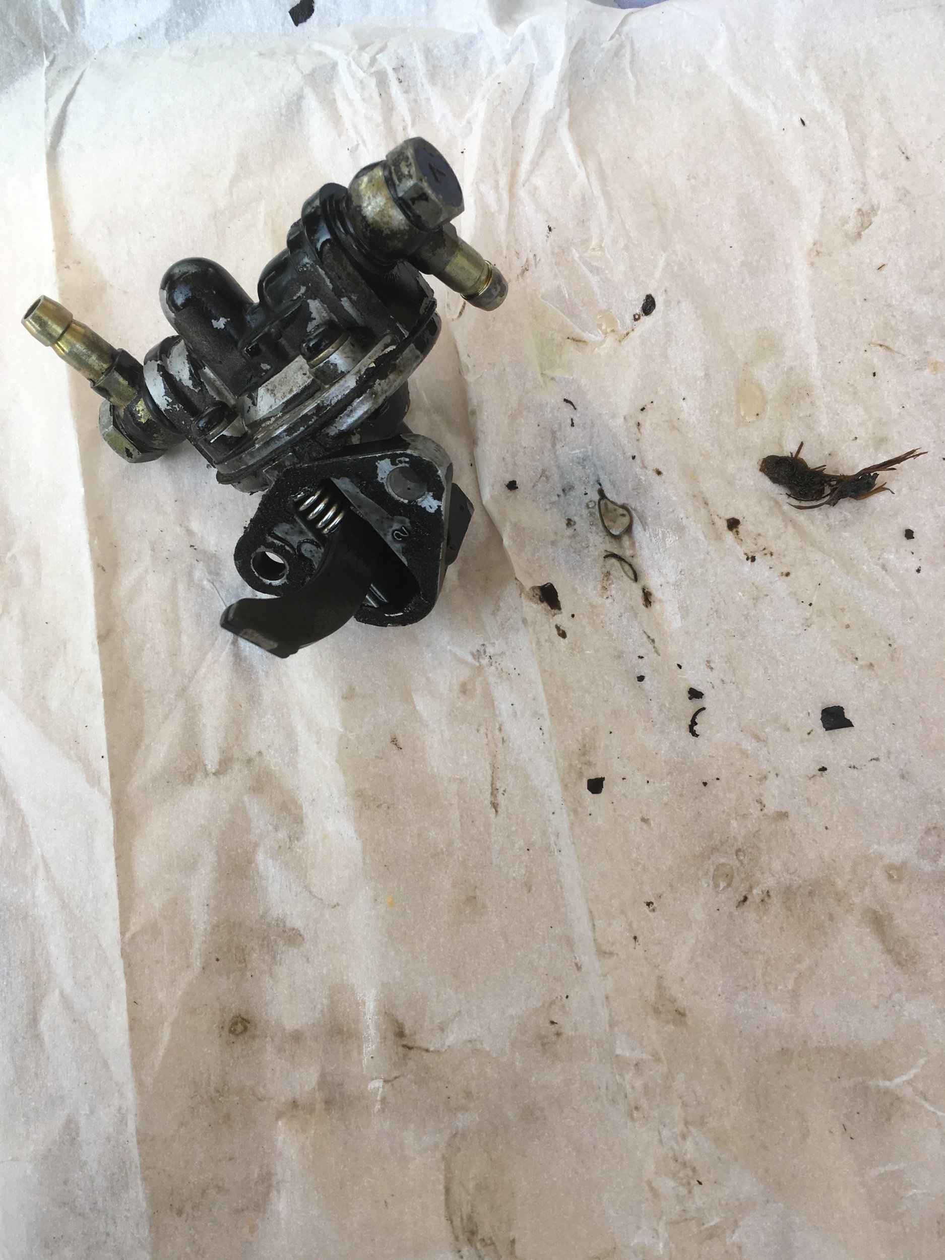

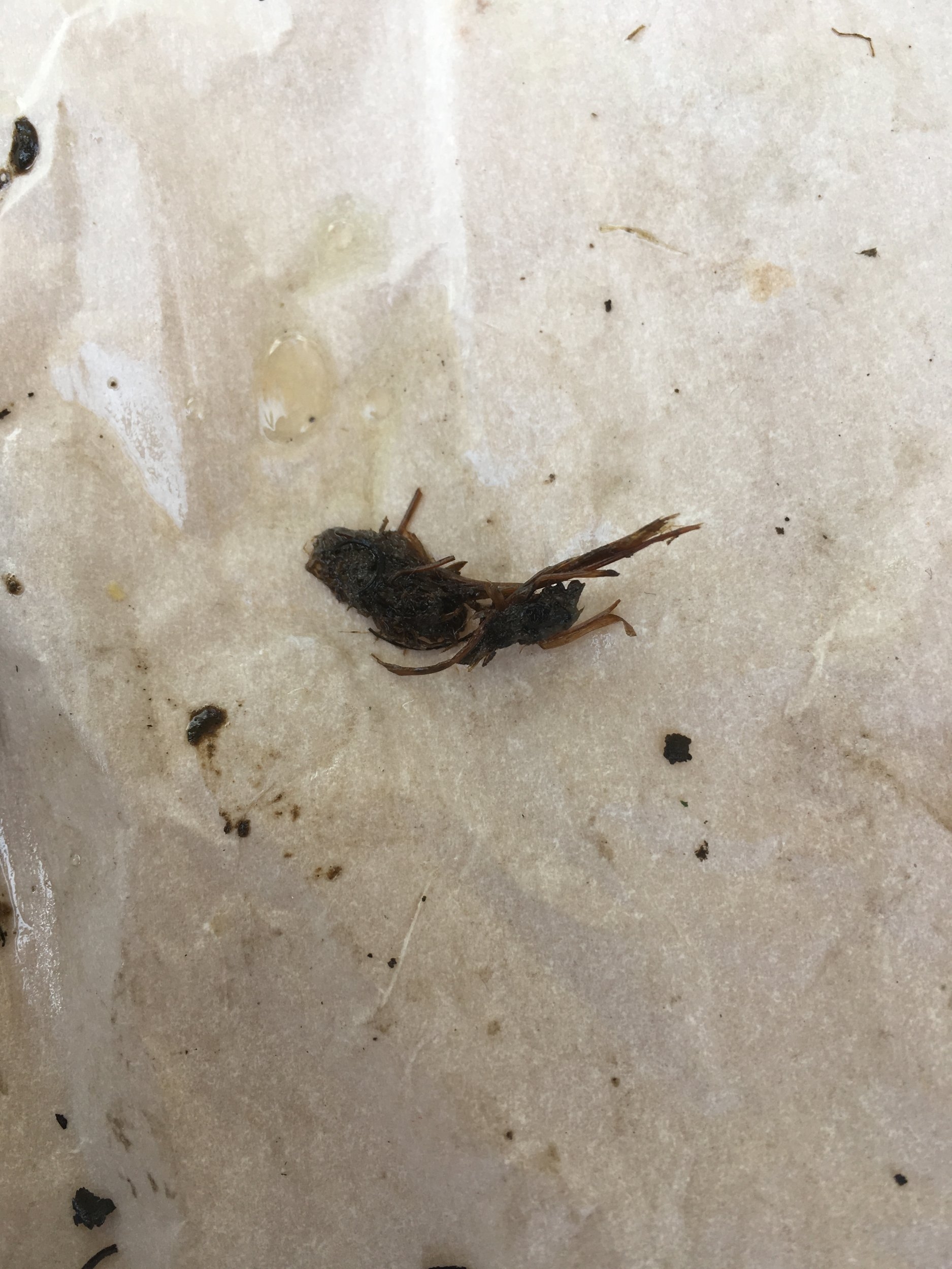

Tractor shows all fuses good, fuel shutoff solenoid getting 12.2 v, new fuel filter, air filter, will idle and drive about 100 ft then die, I am wondering if fuel pump or injectors are bad?
Dead bug in the fuel pump would cause that. Ask me how I know.
