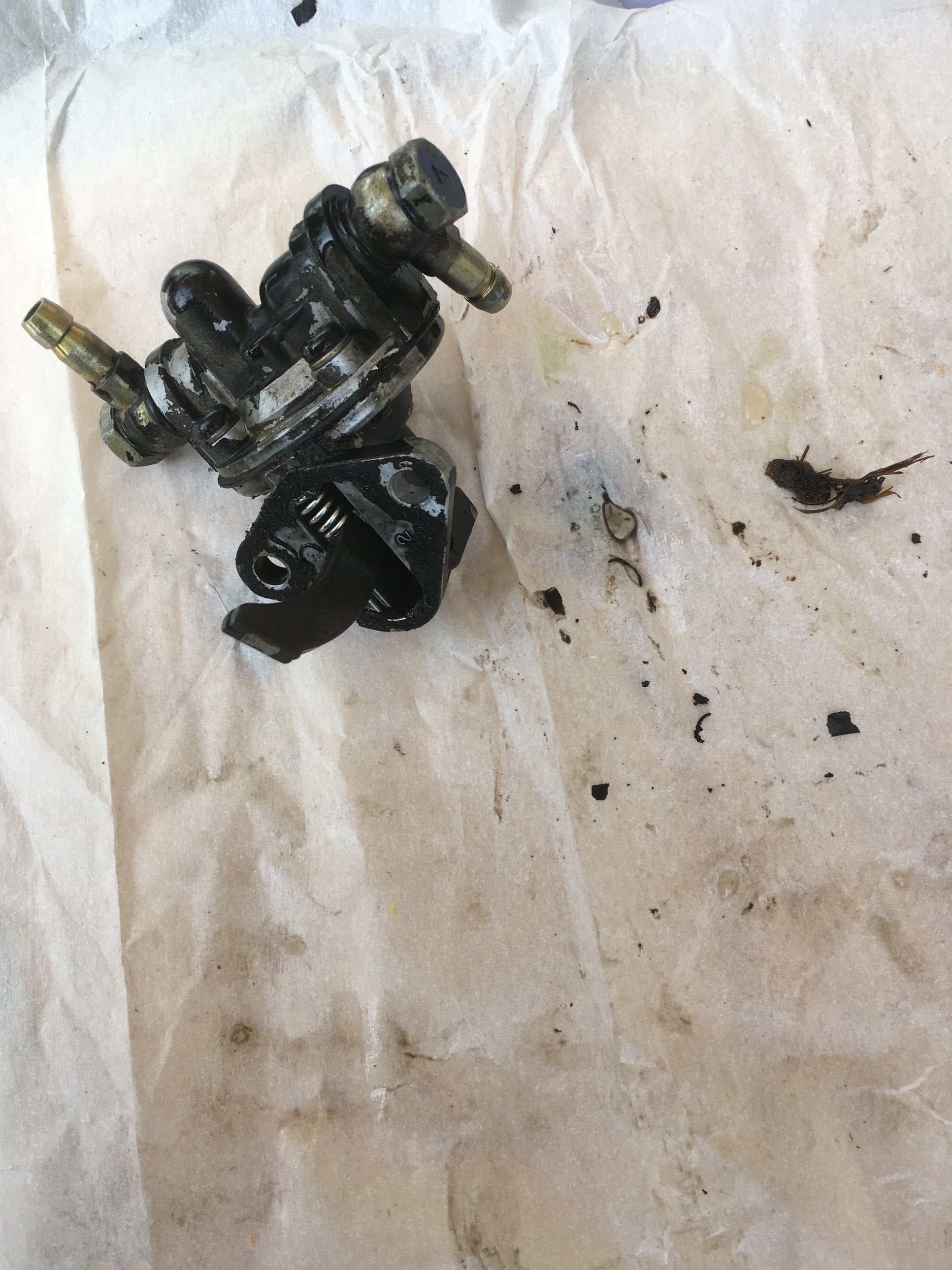

   / Branson 2910i tractor dies while in use. #17

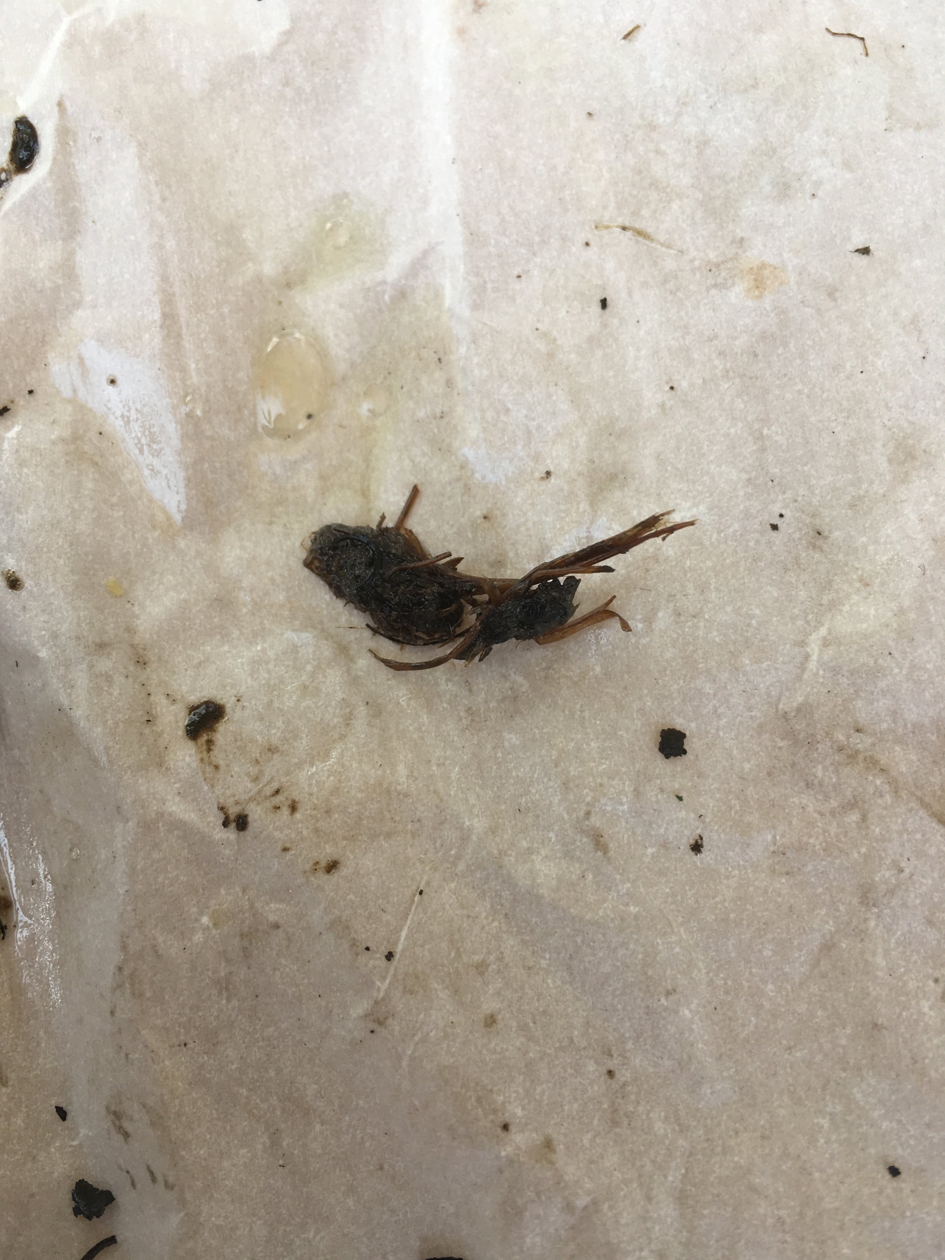

Tractor shows all fuses good, fuel shutoff solenoid getting 12.2 v, new fuel filter, air filter, will idle and drive about 100 ft then die, I am wondering if fuel pump or injectors are bad?
Dead bug in the fuel pump would cause that. Ask me how I know.
#18
Maybe that’s what has happened, the engineer died.lol, sorry but I need to laugh helps me not to cuss problem, that I probably created.
   / Branson 2910i tractor dies while in use. #19
True but she said that happened a few years ago so something has changed.
The fuel may have softened the rubber to the point that it now makes a complete seal of any air venting into the tank.
Similar problem on my old Jinma 284... the fuel screen on the inside of the tank had gotten so bad over 20yrs that it wasn't allowing enough fuel to flow quickly enough into the fuel filter. So it ran with the amount of fuel in the larger fuel filter I had added to the tractor, but then couldn't keep up with the flow. Replaced that screen with some stainless steel mesh, and has been working fine.
   / Branson 2910i tractor dies while in use. #20
Try running the tractor with the tank "cap" removed, if that solves the problem drill a small hole in the plug to vent the tank.
