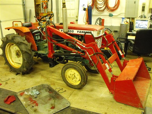

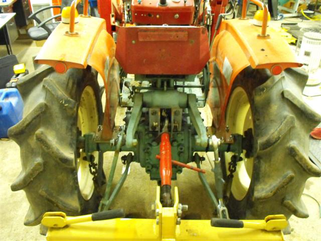

All back together. Forgot how nice it was to have brakes that work:laughing:
Drove it around tonight to check for leaks. So far none but nothing got hot to really tell yet. Just glad it went forward and backward like it was supposed to.:D

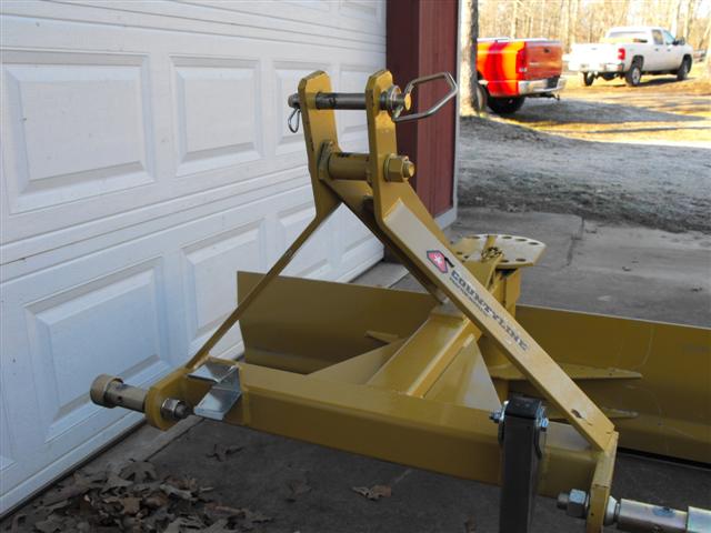

There are several Quick Hitch threads on TBN. In summary, it is a framework you install instead of an implement. Then (assuming a lot of stuff) you simply back up to your implement, raise the QH to hook the implement's pins with its hooks, and drive off to start work. One advantage I like is you can nudge the implement into alignment shoving it with the QH. This saves time.
Here is Tractor Supply's listing. Harbor Freight's seems identical but comes with no accessories, at a third the price.
Here's a picture of mine in use. Note the extreme angle between the tractor and the mower. An ordinary hookup wouldn't allow that extreme angle.
And here's how I obtained the extreme flexibility to allow that angle. For this application, I used a chain in place of the QH's upper hook.
There is more variability in implement width than you might expect. Here, I shimmed my little disc to make the pins as wide as the QH's hooks.
Finally, here is a rear pallet fork assembly I cobbled together that fits on the QH. It is real handy to just back up to that attachment, pick it up, and go move some heavy object like this box blade.
I suggest start a new QH thread in here, or add to an existing one, so QH discussion will be easier for others to find.

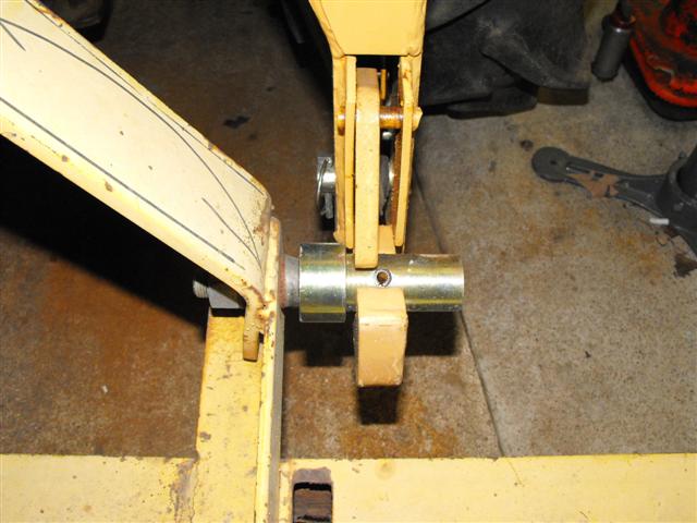

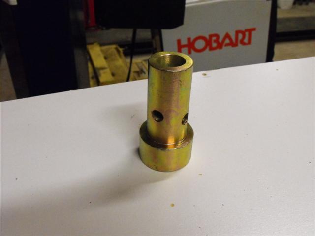

What did you have to modify on your implements? Normally guys just had to spread the legs a bit on a HF hitch with a hydraulic jack to get them to fit everything.
/ Brake overhaul
#49
I used these adapter for all of my implements. They extend the width of the pins just enough so you don't have to spread the implement.
