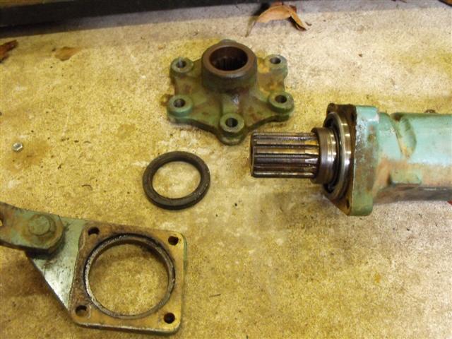

Finally got the axle hub off the shaft. Had to use a wheel puller, lots of penetrating fluid and a hammer. Took about a half hour of tightening and tapping on the hub to break it loose. Yep, the seal collar was corroded as bad as the brake collar. Would have been a waist of a seal to just put in a new one without changing the collar. It would have just chewed it up over time. Now I have to get the collar unstuck from the axle.

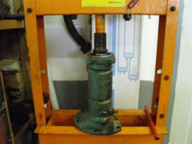

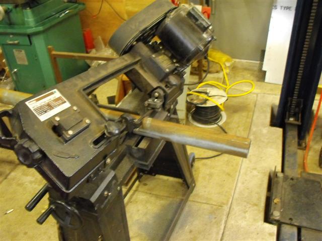

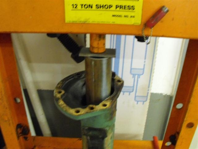

Had to use the press to get the collar and bearing out. I tried to use pliers and tap the collar but it wouldn't budge. I cut a 13" piece of 2 1/4" pipe to fit down into the axle housing to press out the bearing and seal collar. Pretty easy if you have a press but would be a real pain if it was still on the tractor. Would probably have to use a torch to heat the seal collar to break the rust bond.

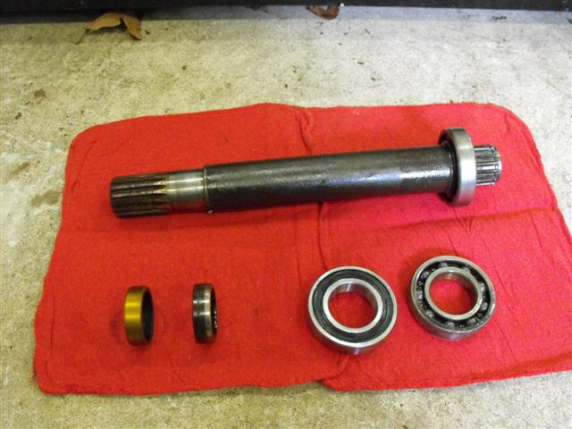

The new bearing is sealed (like the brake outer bearing) but the old was open. Also, the new seal collar is coated. Guess they figured out eventually the collars will corrode and destroy the seal.
Also, the axles on this tractor are really thick. I doubt a 20hp engine will ever be able to snap one.

Something got into the outer seal on the left axle and started shredding it. Given enough time it would likely have worked its way into the inner seal and then the bearing. All that stringy stuff is pieces of the seal. I won't know till I tear it apart if there is more damage. I did notice a small amount of wet dust starting to show up around the hub but thought it was just normal minor leakage from age.

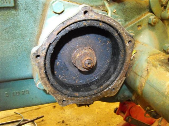

The left brake is worse than the right. This time, I'm leaving out the drain plug in the bottom of the housing so the water can drain out. I don't plan on driving it in a rice field and even if water does get in, it's got a way out.
