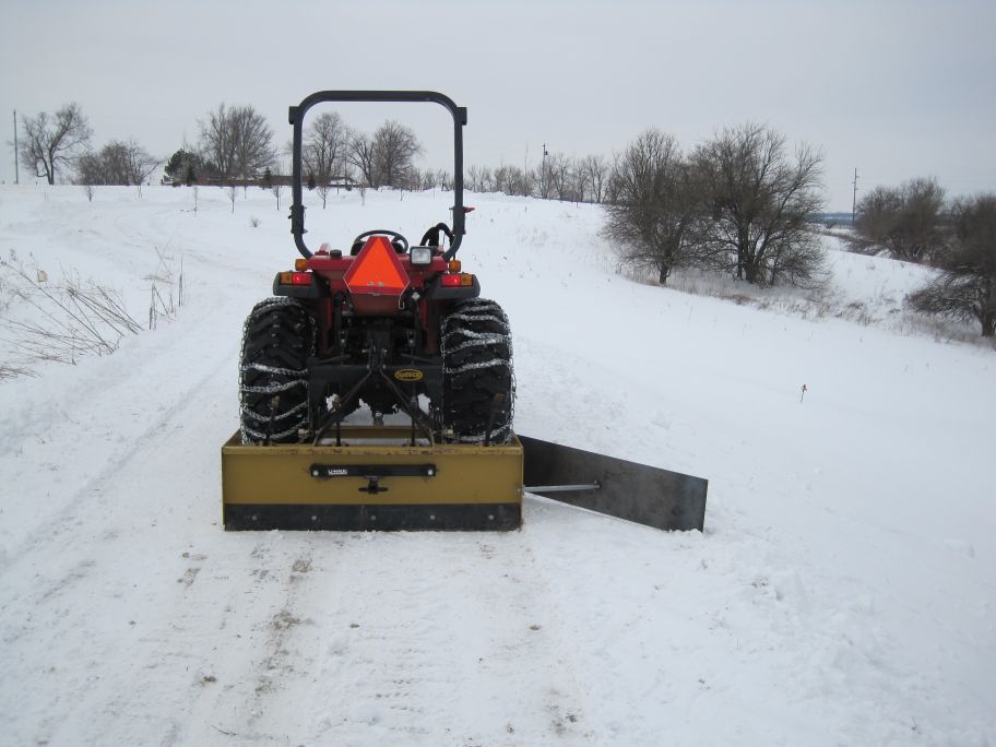

When I say "gravel that's blown off to the side", I don't mean much further than 12 - 18" from the wheel ruts.
No rear hydraulics on my 1533 so all adjustments are going to be manually done.
How would the box blade move material from the side to the center seeing as how the blade is straight? I would have thought the blade would have to be angled back in order to move material in that direction. As well, why would the box blade be less likely to skip/bounce over the center hump vs a scraper blade?

I haven't found a boxblade or rearblade to be a better choice rather they perform different tasks and both can be necessary. I would think you need to have both implements and maybe a landplane/graderscraper too.
Which one to get first?
If the most severe problem is recovering the gravel on the side then get a rearblade.
If the most severe problem is potholes in the drive get the boxblade.

For keeping up a gravel rd, you need a scraper. You can change the angle left to right or change the tilt up and down from the seat. I have a rake and a box blade, the rake is OK for touching up. Box blade is almost worthless on a gravel rd, just leaves it flat destroying the crown. If you need to rebuild the road from pot holes and ripples, a scraper is the only way to go.
Completely unfair to the boxblade. A capable operator can actually build a good crown. Don't let your BB rust in the shed, take it out and actually learn how to use it!! I'm sure you'll be pleasantly surprised.
Hint1: lower the scarifiers and tear through the potholes
Hint2: not all scarifiers need be lowered
Hint3: use draft or position control if so equipped (to keep BB from digging too deep)
Hint4: for crown work, set one lower lift arm on the tractor a little higher than the other. Then work the road 1/2 at a time (higher side of the BB in the center of course).
Hint5: light finishing/smoothing work can be performed in reverse by adjusting toplink to raise rear of BB higher than front.
