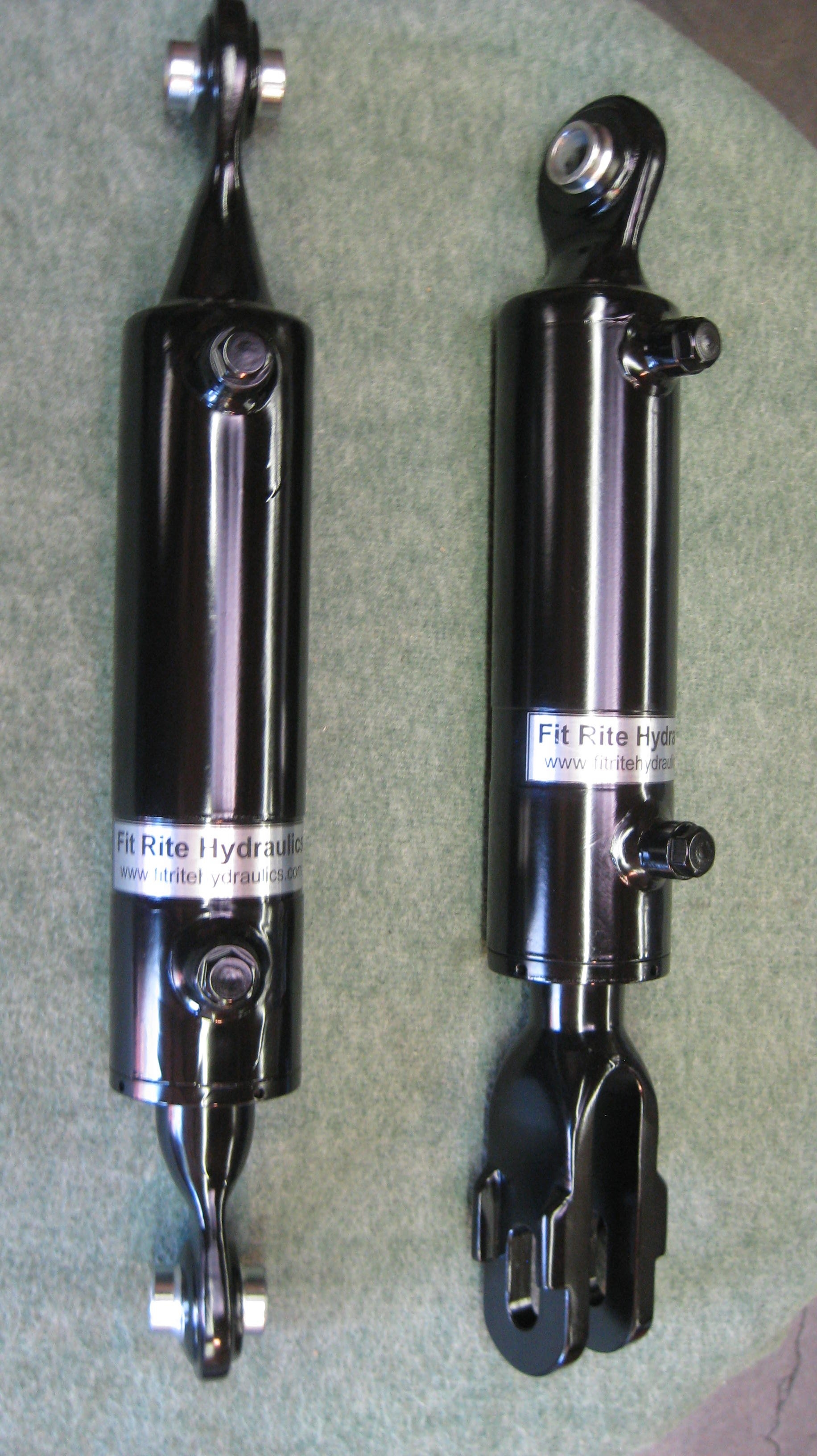

Fellows, I plan to add three rear remotes to my tractor specifically for a box scraper. Two remotes will control the top and tilt on the tractor, one remote for the cylinder on the scraper that controls the scarifier depth.
/ Hydraulics Requirement for Grader/Box Scraper
#2
I am interested in opinions on the configurations of the valves. I have the option of float. Do you think it is needed for any of the remotes? Is there any other considerations to adding remotes specifically for the grader box.
Thanks for any help.

To add, I already have a top and tilt kit and a Frontier box grader. Both were original equipment sold by John Deere for the 110 TLB. The box grader has a cylinder that controls the scarifier depth. So, I will need three remotes. I was just wondering how helpful the float feature would be for any of the three as I have never used such a set-up. I have some experience with a plain box scraper on my smaller Kubota, no rear hydraulics on that one.
Every rotating hydraulic actuated ripper set that I have ever seen is intended to be either raised up or locked down in the lower position. The scarifiers were never intended to be used in any in-between position. If you need a different depth, then hand adjust the scarifiers in their mount.
Regarding the side link, I have only seen 2 of the OEM T&T sets for a 110 and neither of them had the slot & guide setup to match the left side link.
Last thing, the top link is not built to provide the optimal working range. The ones that I have seen provided about 2" of retraction and 6" of extension from the implement level point front-back. The side link is designed to be fully retracted when level, so all you get is tilt down on the right side. :(

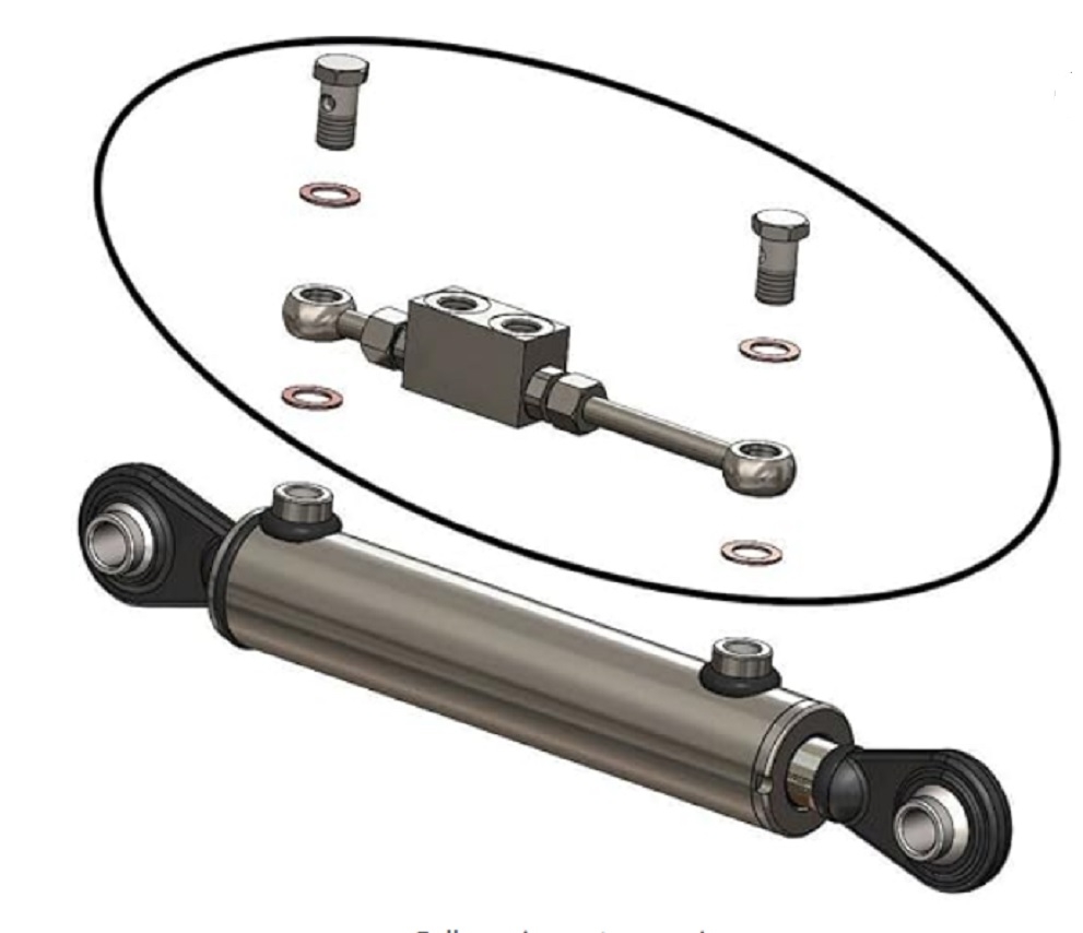

...I was just wondering how helpful the float feature would be...
If your cylinders have double pilot operated check valve like below; then float would not work until you remove it.
Me personally, I don't see a need for float. If I did, I would just use my front end loader, in float, dragging it backwards. Some people use float on their toplink on mowers. I just don't connect the top links to my mowers...
Without writing a book on the subject, everyone's surface that they work with is not flat.
If you are looking for a smooth surface and the grade transitions as you go around a corner or in a Y in a drive surface or S curves, depending on how drastic the grade differences might be, having the implement follow the ground vs following the tractor can make for a far superior finish with the side link in float. You are looking for independent motion from the left and right sides through the transition areas of the grade.
Without using the float feature, you often end up either digging in or dropping material where you do not want that to happen.
If all a person works with is flat or very gentle transitions, then no big deal. But if you have more drastic changes, then making use of the float feature can make for a very nice finished grade.

Well to be sure I don’t know if my T&T is JD OEM. I bought it and the Frontier box grader at auction about four years ago. The owner had a 110 and an array of JD attachments for it that appeared to be unused. The story was that he was starting a business years ago but got sick and later died.
My assumption is the T&T is original JD. It does have a slot on the side link. I have only the cylinders, hoses and lower lift arms, no attaching hardware.
