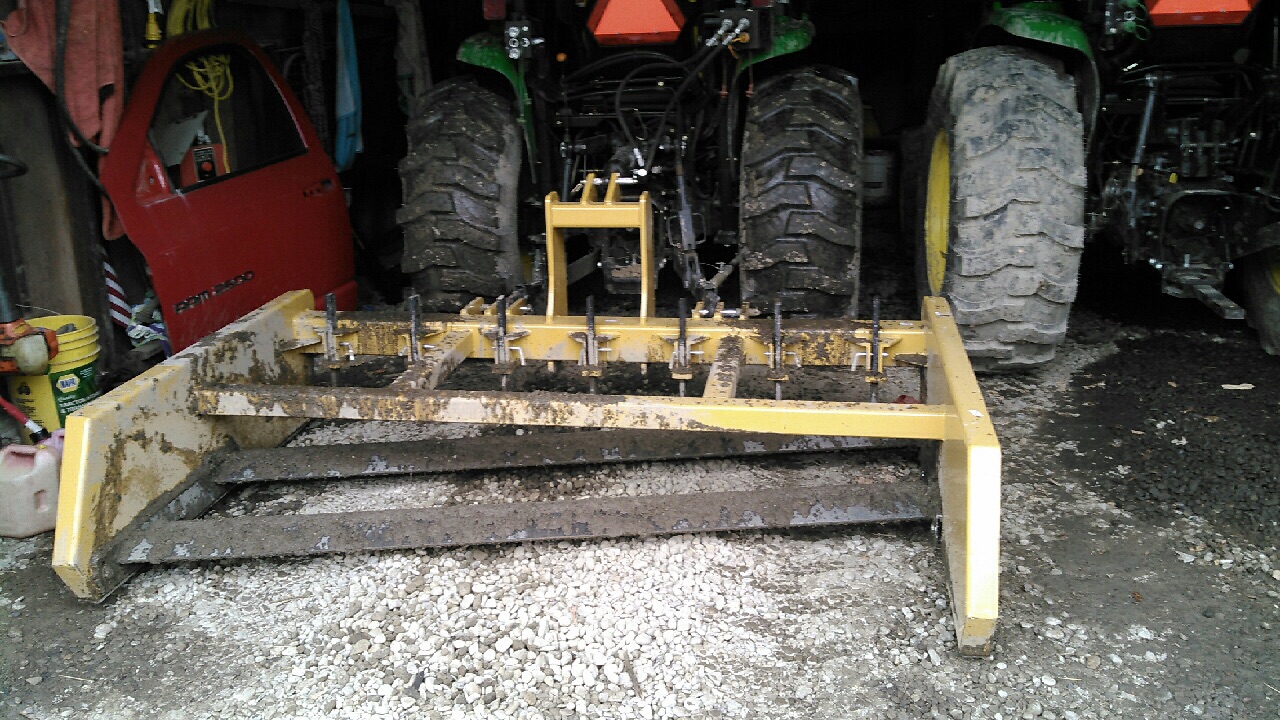

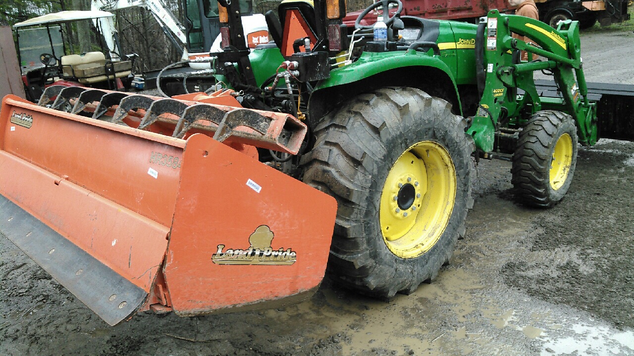

If you have a 4520 I would suggest a 84" implement being either a box blade or grading scraper . I have a 84 " cammond industrial grading scraper with teeth that weighs in at 930 pounds, and a landpride 84" hydraulic box blade that weighs about 1200 pounds . I use the grading scraper about 80% more than the box blade. I use it to maintain about 2 miles of gravel roads in a campgound as well as a couple parking areas. I had a 72 inch 650 pound box blade and I felt it wasn't enough for that size tractor. Cammond is now called superior fab and I feel they made a quality product for a reasonable price
