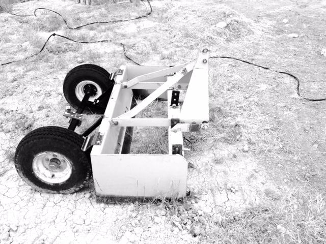

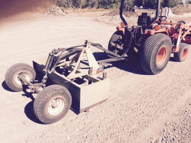

Might suggest an implement that sort of "falls between" the 3PH box blade and the drawn box blade and that would be the 3PH box blade with the gauge wheels behind and with a hydraulic top link. I have used all three types and, can honestly say, that the gauge wheels make the box blade into a useful implement.
I've added a removable tongue to mine which converts it into a pull type making it it slightly more adept at leveling a large area but not quite as maneuverable in tight areas as the 3PH mode. The length of the tongue helps to smooth rough areas.
The 3PH box blade with gauge wheels shines because the 3PH can be left to float so that the blade doesn't follow the tractor undulations and the gauge wheels run on leveled dirt. The hydraulic top link provides depth control for fine cutting. Also, the additional weight of the gauge wheels provides cutting power in hard soil when needed on either type box blade.

Do you have a photo of this? I've pondered doing something similar since I got a hydraulic top link.
The boxblade pix show gauge wheels with a cylinder which is used with the add-on tongue. The gauge wheels can be rigid mounted without a cylinder if used as 3PH with a cylinder top link for cutting depth control.
Castering gauge wheels on a landscape rake also add a lot of versatility especially with the angle control cylinder.
Edit: The last pic shows rigid mounted gauge wheels as an earlier version. Having the wheels close behind the blade keeps the unit compact but still adds a lot of weight for cutting hard soil.

Mr. Npalen, the box blade on wheels looks fantastic for finesse leveling.
Now you have me thinking..."Hmmmm...could I cobble one together (with the hydraulic back wheels)??? ..." !!!
You wouldn't need a hydraulic cylinder on the gauge wheels if you had one as the top link. This is assuming you would be using the box blade on the 3PH. The cylinder on the back only becomes necessary when using the box blade as a pull type.
I mention that because it would be easier to go with rigid mounted gauge wheels. Also might mention that some guys will mount the gauge wheels further back from the blade which may make for even better leveling in rough ground but you lose some compactness.
