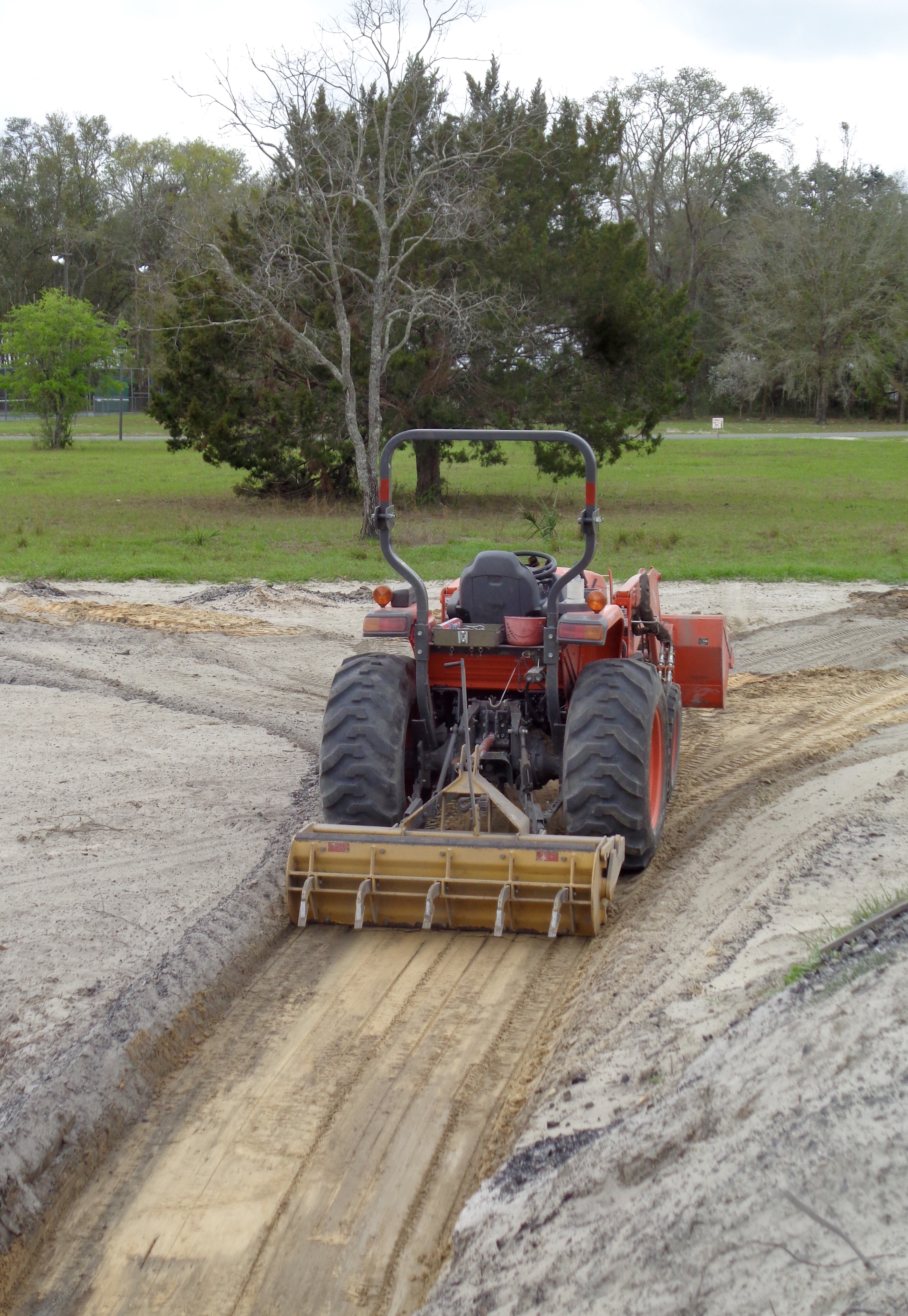

Box Blades optimally are slightly wider than tractor's rear tires.
If narrower, you cannot pull down the same "aisle" repeatedly because space for the rear tires is not cleared.
Limited to field smoothing, width would be less important.
Weight is your friend in ground contact tasks.
Box Blades need to be 100 pounds weight per foot of width in order to cut soil well. (Construction Box Blades are 200 pounds per foot of width.)
Many 48" Box Blades are sold to newbies on basis of price. Often they do not cut, or cut 1/4" per draw. Sometimes they break. Determine the Land Pride model number and research weight on Land Pride's web site, Only the heaviest 48" Box Blades approach 100 pounds per foot of width.
Moist soil cuts much easier than dry soil.
Your tasks involve moving/transporting soil. A Box Blade is designed to transport soil short distances. It is one of the right choices. A rear/angle blade, would be another right choice.
Learning to operate a Box Blade efficiently takes time.
A Box Blades is the implement most frequently employed as Three Point Hitch counterbalance to loader bucket loads.
A light Box Blades is not heavy enough to keep rear wheels securely on the ground during a max lift of dirt or other material with the loader bucket.
I trust you have functioning 4-WD.
Width of Rollover Box Blade in Photo 60"
Weight of Rollover Box Blade in Photo 630 pounds

For dirt/trail work, I find a box to be horribly frustrating compared to the blade. There is a use and advantage to the box on dirt trails, and that is that the near surface roots will be grabbed by the teeth and torn apart so that you keep working down to level an area. But other than that, if roots are not an issue, my blade will cut into dirt and pull more/faster than the box by far. The blade can also be angled to move dirt tone side or the other while the box is not capable of that. Both can be adjusted to slope left/right behind you, but if you want to bit in hard and level a sloped trail the rear grader blade will run circles around the box.
If you look at Jeffs photo up a few posts you see where he is cutting in nicely with a box, but also look at that super soft sand he is working in. My dirt here would LOL at the box if that was the goal! But the grader blade would cut in and start rolling 6" thick scabs of dirt if I fully dropped it. I almost need to use both, explode roots with the box, then do the dirt work with the blade.
