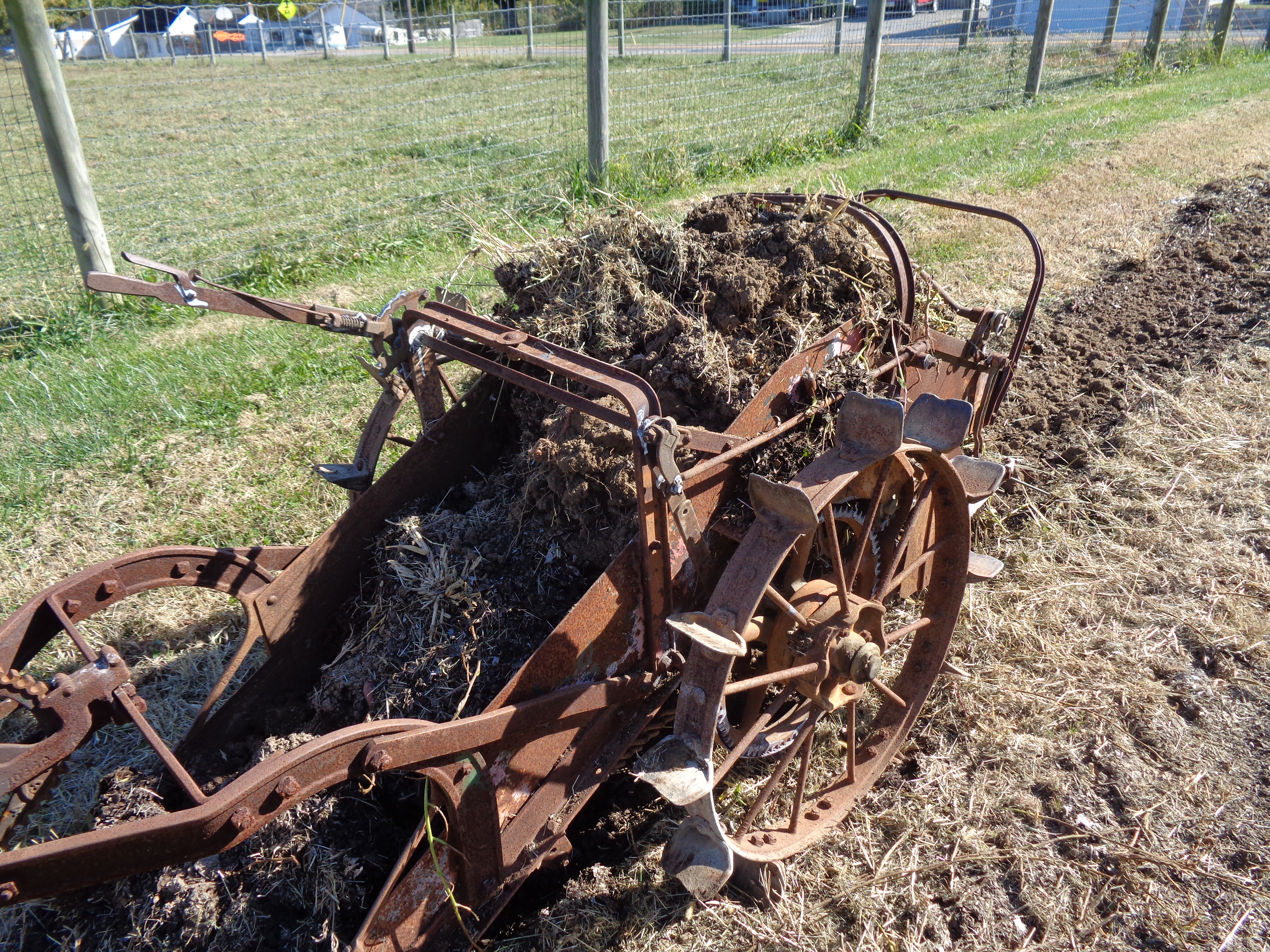

I'd imagine the A-C B is set up with a 1 row cultivator. And I imagine the foot print would be rows no less than 5' on center. Yes, you could go narrower when plants are small, but as they grow, you'll more than likely run over them when they bush out. Evenwith something like a C, or CA with 2 row cults., it'spretty much like my old BN Farmall, and 42" was as narrow was one could go. Here, that would be a lot of open wasted space. That's why I use the 2-wheeler's. A lot of plants like the peppers & onions, even cabbage can be set 30" on center, growing more, in less space, and less weeds to deal with. If weeds mature, that will only create a larger seed bank in the future. There is going to be a lot of hand work involved, no matter what you use, to get up close to plants.
It's a little more work, but I mark out rows with the cultivator on the Bradley. Trickle some fertilizer in the row, then run through again to stir it in the soil. But, when it comes time to cultivate, I'm dead on, on row spacing to cultivate. Below are acouplepics of my David Bradley 5 hp Special, with hillers on the cultivator. These are 30" rows,and as you can see, does a decent job of keeping the weeds at bay, IF the weather cooperates. The important thing with these is, like my Dad alwaysused to say, " Let them do the work, don't let them work you." I've seen video's of guy's wrestling these tractors doing variousjobs. No need to do that, it's not that tough. Just go at a speed you can handle them, and just steer them along. One with a 3 hp engine will do the job just as easy, and use little gas. I've got 5 I have set up with different cultivators, for different stages of growth, or what I want to do. The cultivator with hillers is normaly the last pass, maybe even going over it 2-3 times ina couple weeks. Beyond that stage,plants will bushout, and shade in between rows to keep weed pressure down. Beyond that, I've got this spiffy little 1-wheeler I can get inas narrow as 10". Sure beats using a hoe..!!
Tillers are a great tool, if you don't over do it. Too many trips over making it fine can ruin the soil structure. And, if in the case like mybuddy who made his as fine as flour, after a good heavy rain, it got avery hard crust on top. He has a cherry CAAllis with 2-row cultivators. That crust was so hard, brand new 6" sweeps barley left a mark in the dirt. I bought a new bush hog brand reverse direction tiller last year to try a biofumigation experiment, and made 3 passes with it. With all of the rain we had, when I dug sweet potatoes, there was a 6" slab of dirt come with it, and literally plugged the potato digger, see picture attached.
This year where I tilled in 4 years worth of top composting to plant potatoes in, I just made 1 pass, leaving it a little more coarse. The ground is a lot more friable, and easy to work.
Some items you'll learn to plant in stages, such as sweet corn. Most you can plant 7-10 days between plantings. When one patch is done, a new one should be coming on. Years ago, Dad planted 6 different patches. We usually had sweet corn from late July, well through Sept.
The biggest point I'm trying to make is you don't need a large plot, to grow a lot of produce. Up until the last 2 years, when I convinced my market garden buddy to down size, and take good care of what he has, I was getting more produce from my little 1/4 acre patch, than he was from several acres. In the end, what matters is, the amount you actually harvest, not how many acres you put out. Start with a smaller plot, take good care of it, and see what you can handle. Then, grow in baby steps.
This year, I'm seeing a lot of people putting out gardens that never have. Many online seed suppliers show many items "out of stock". I've also seen in past years, many inexperienced newbie gardeners are really in to it, until it gets hot, and caring for a garden becomes more of a chore, than it's worth. It will be interesting to see how it all pans out.
