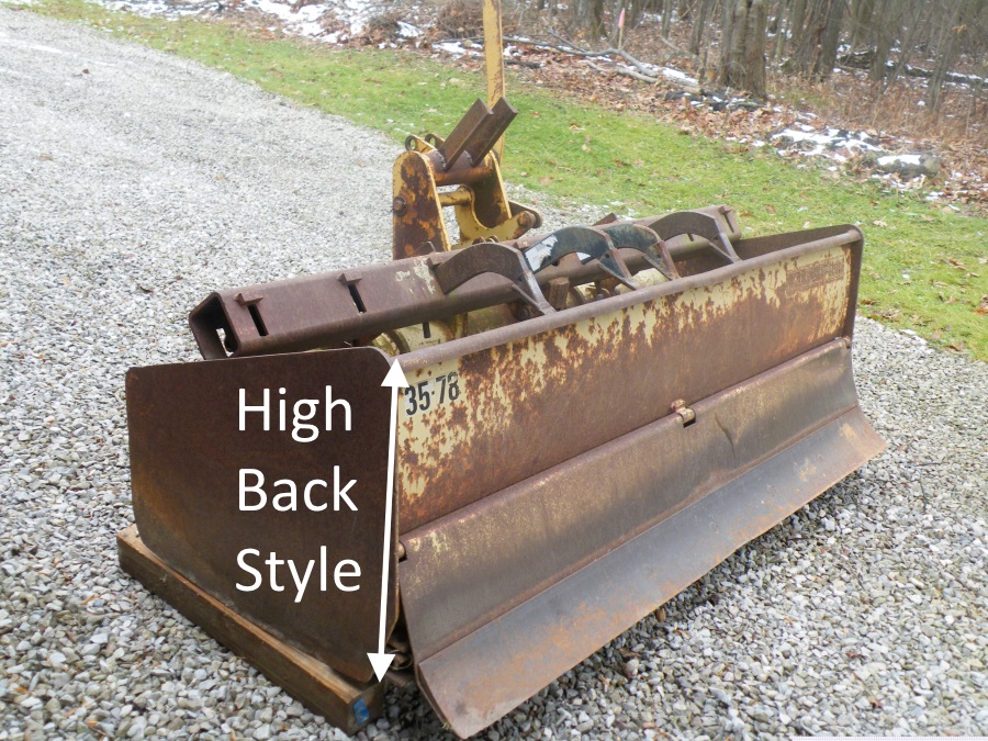

Also there there are two basic types, Standard and High Back:
If you have a big tractor you might like the High Back.
Define "big"
I should have said big dirt moving jobs, since a narrower High Back BB would work well on a small tractor.
