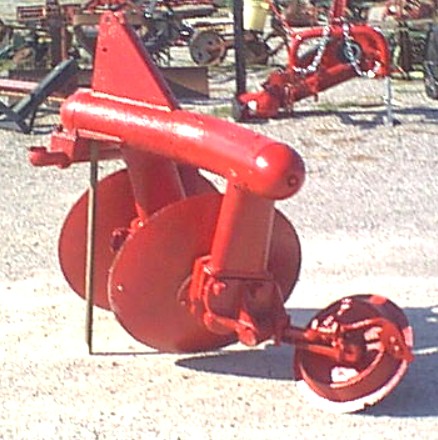

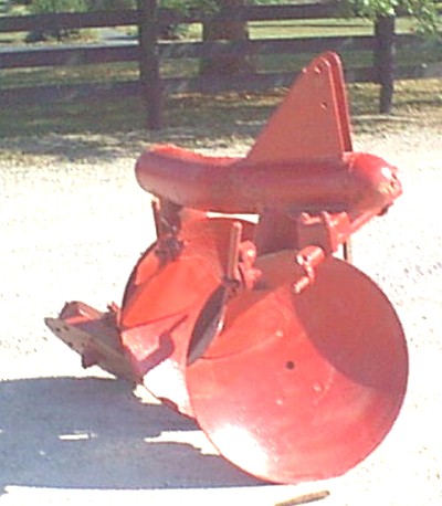

A tool like this was designed for "New Ground" and lots of top growth. Plowing without clogging and also cuts the roots into short sections. $695. Ken Sweet
