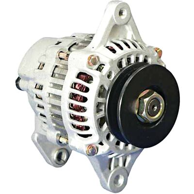

I took a better look today and here is what I found. The coolant level was a tad low which I didn't notice yesterday as it may have still been warm when I looked. I'll run it again today to see if the overheating was caused by this. I also did a better job of cleaning the radiator fins with a hose as suggested above. I usually blast it with my compressor every few hours.
The noise on startup isn't the belt or the water pump after all; it's the alternator. If I slowly rotate it by hand, it remains silent. However, if I spin it really fast, it screams like a banshee. I guess the bearings are going on it.
Taking a look at mycnhistore, the alternator is priced at just over 1500 CAD$! And a suitable aftermarket doesn't appear to be available from the usual online source or are just as expensive.I'm going to take it to a rebuilder unless someone has a online source for a new/reman.
How about $105 (US)?
/ Boomer 3045 Water Pump - Overheating #8
Bet it's less expensive to get it rebuilt. In reality there is little inside to fail. The diode trio or the exciter brushes or the shaft bearings, all easily renewed.
dang that's quite a bit cheaper. The part number doesn't match although it does look like it is correct.
Quick edit. The 3045 version is 70 amps while the TC45 is 40 amps.
/ Boomer 3045 Water Pump - Overheating #10
In reality alternators are generic other than connections output and mounting hole location and sized different as the output increases. So long as the mounting holes match and the output and hookup is similar, you should be good to go.

$1500 for an alternator has to be for a case of 8 of them. Absurd. If you can sort out the wiring issues most likely there are dozens of other alternators that would work just fine. Back to the overheating: Esp with that many hours you may want to check the radiator cap too. If it is weak and won't hold normal pressure that will cause overheating (which it did on a Kubota I was working on.) All that said, you probably have a dying water pump.
