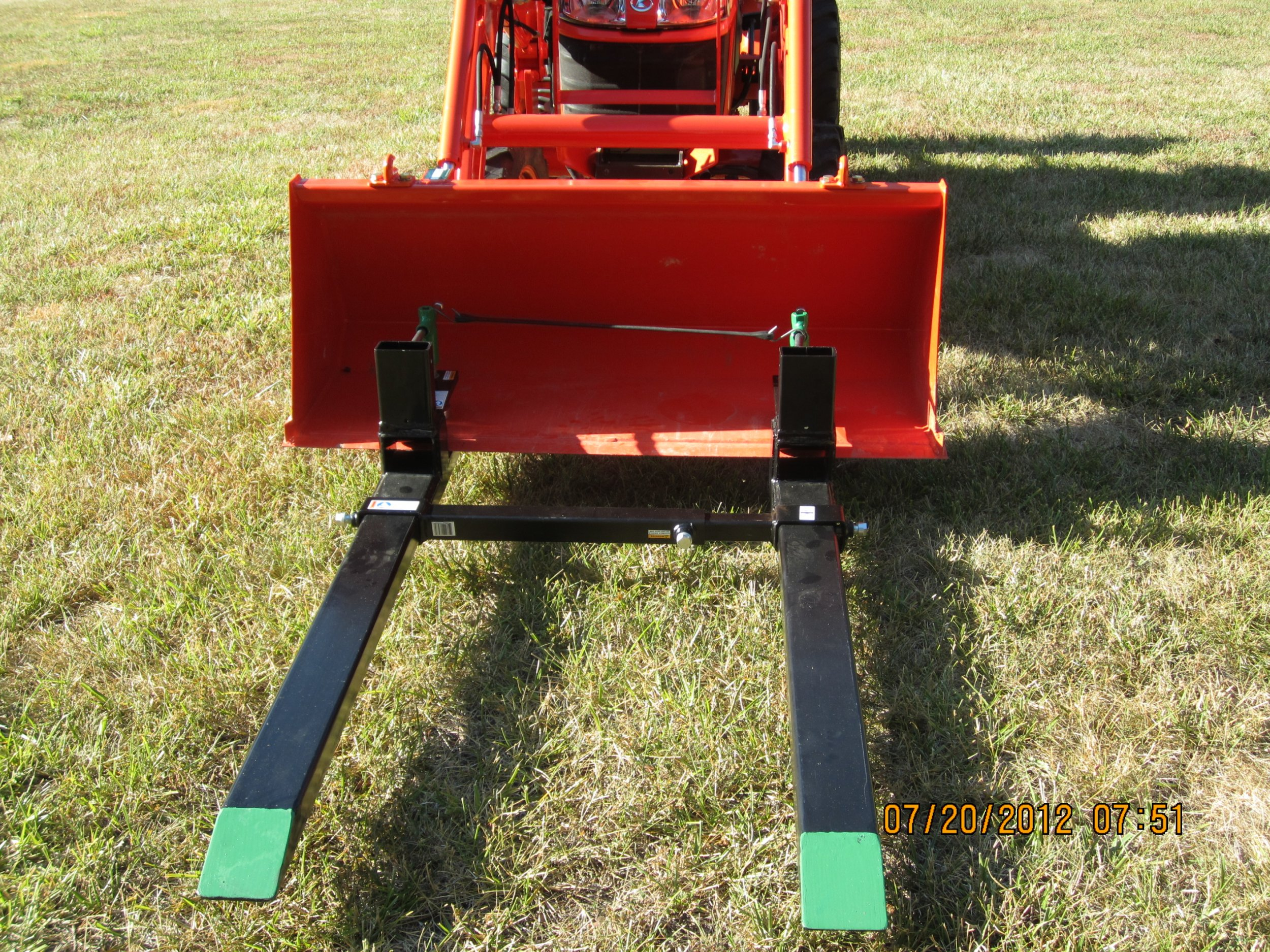

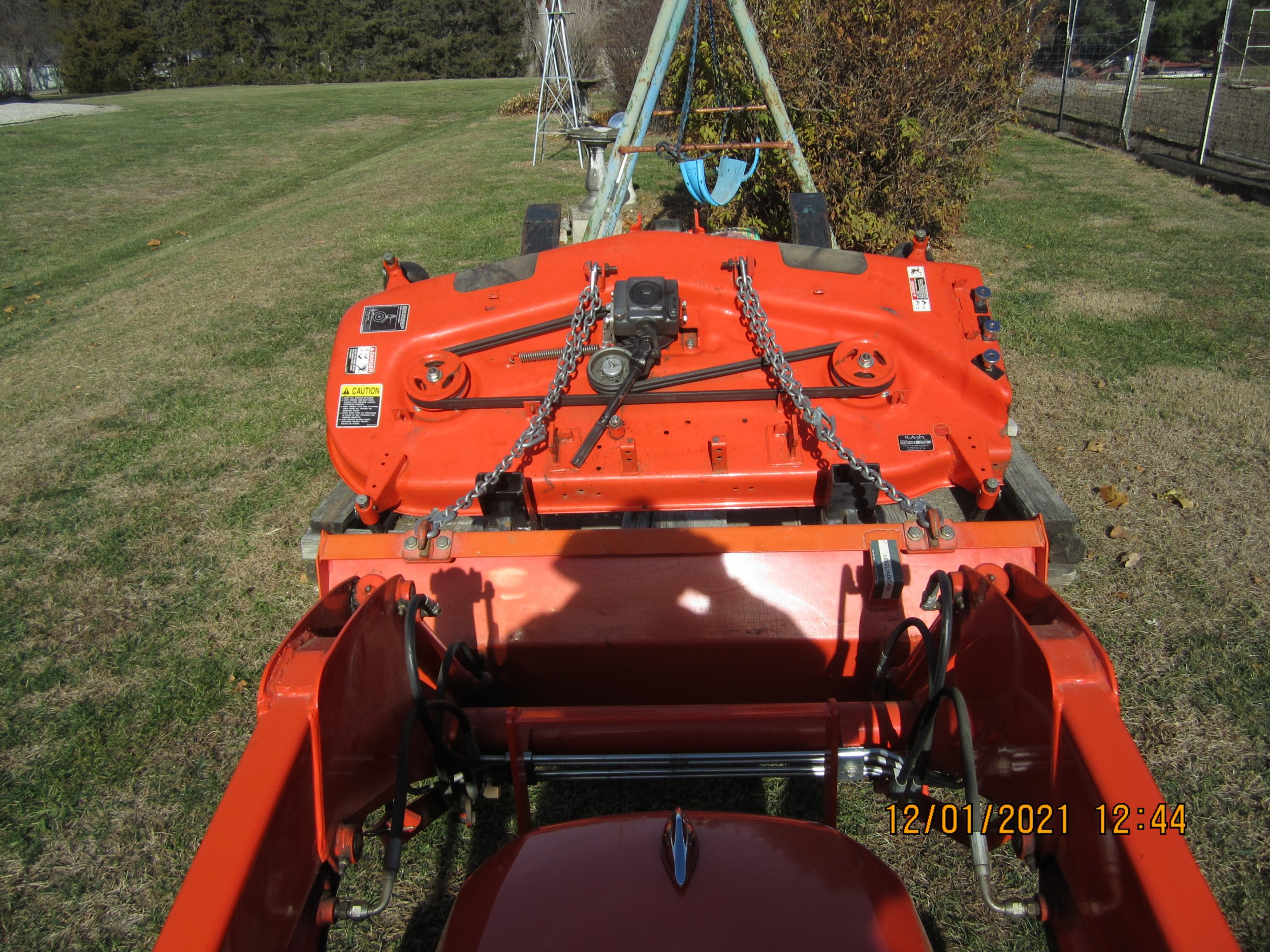

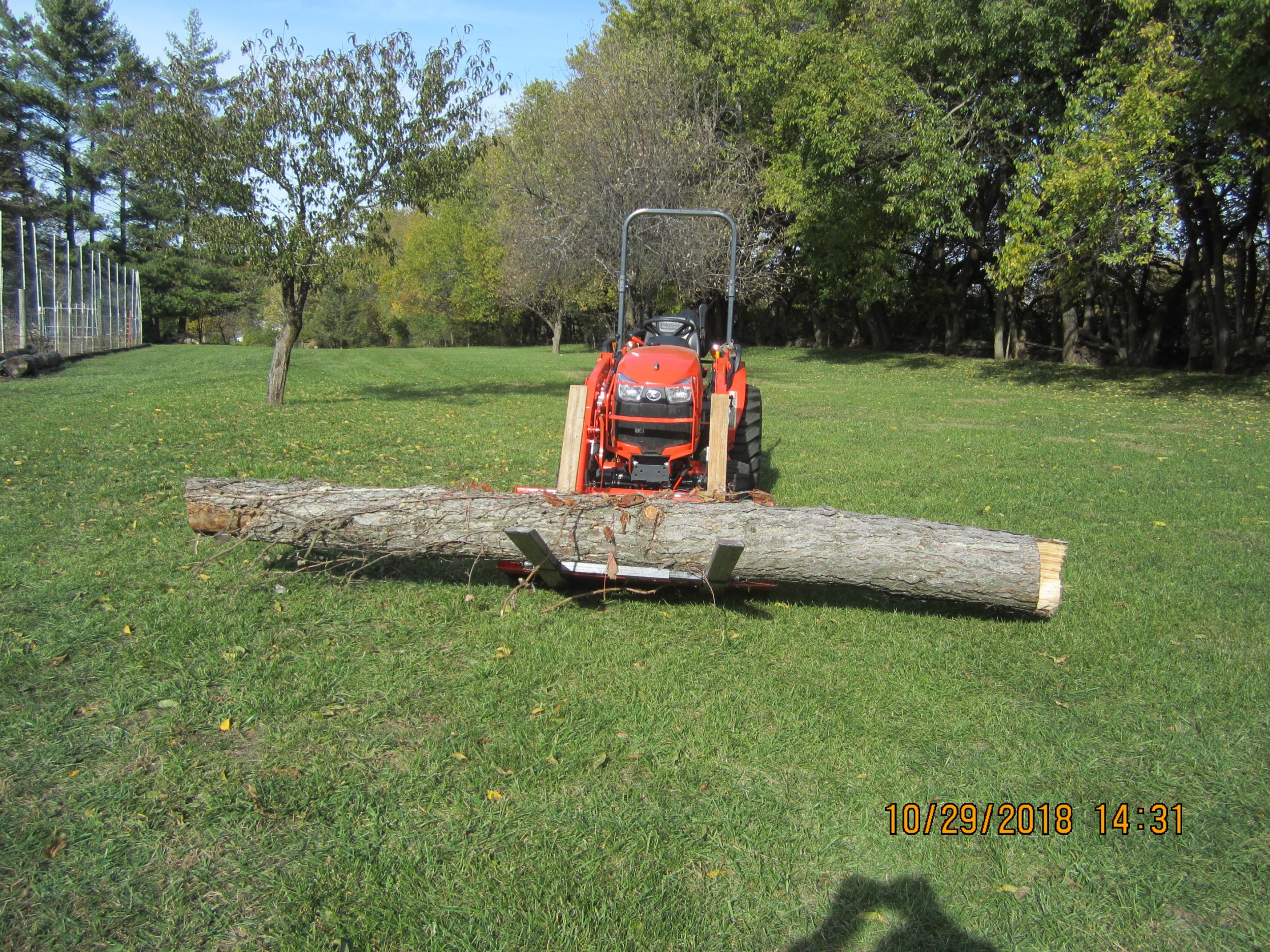

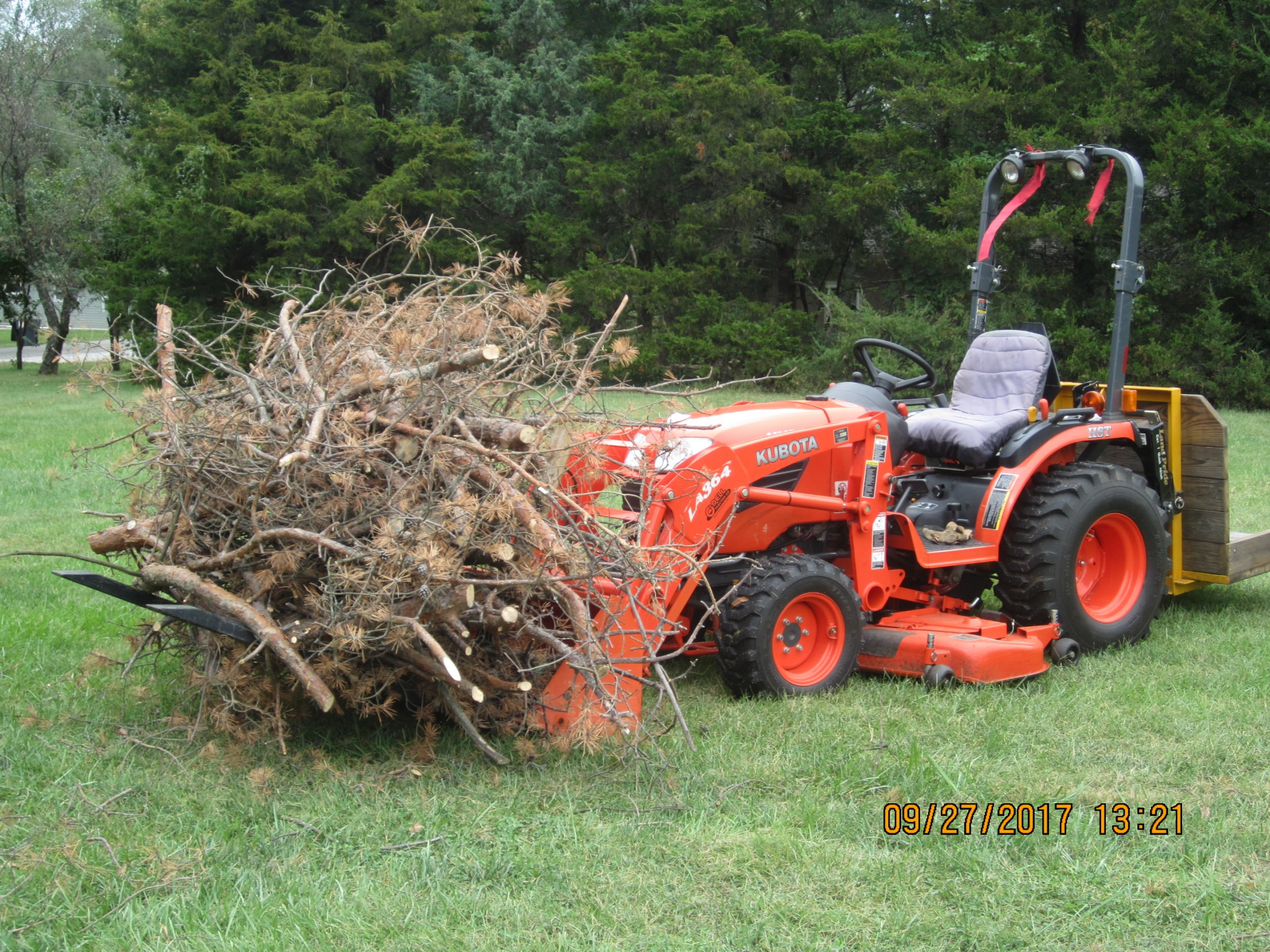

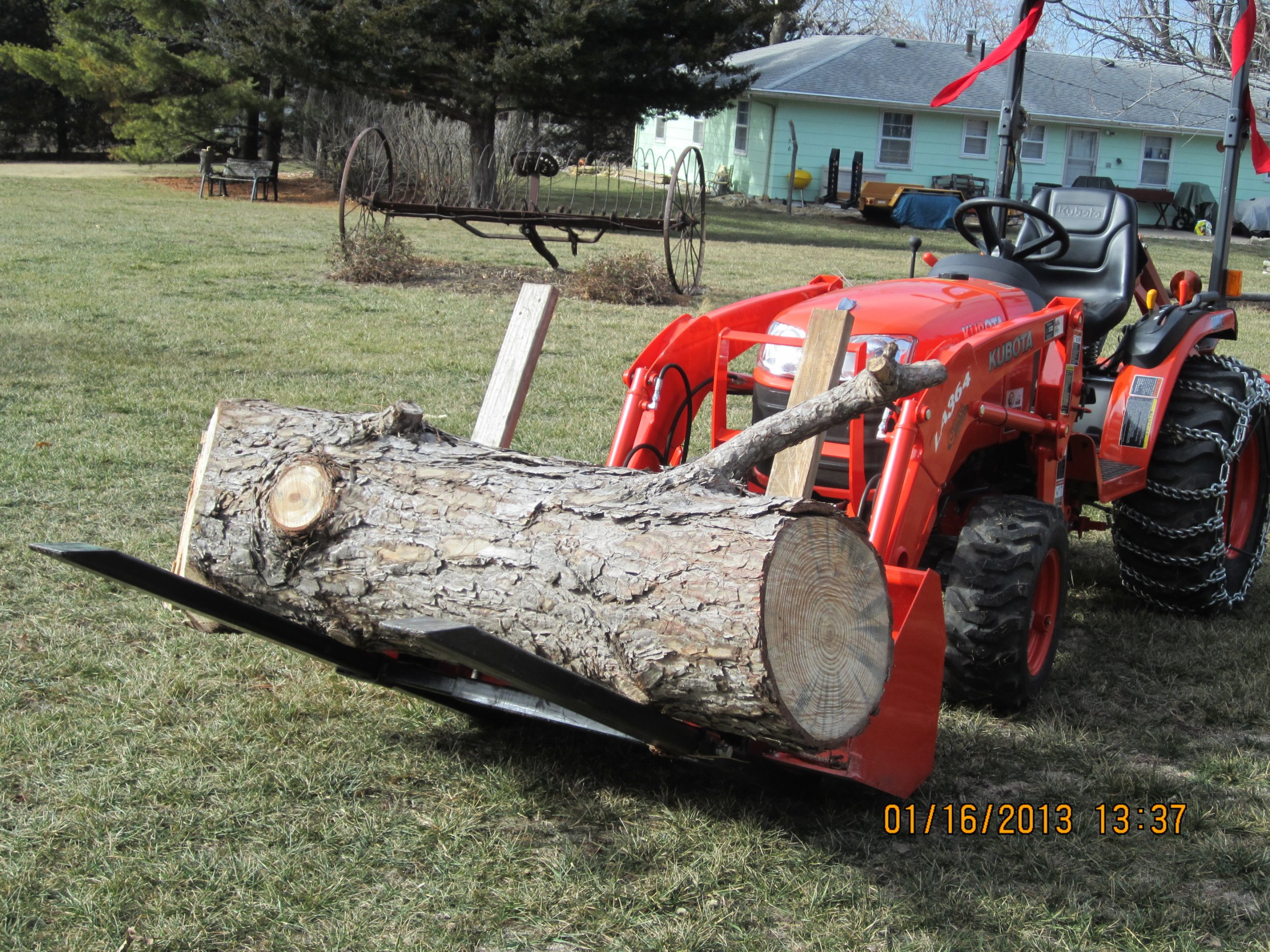

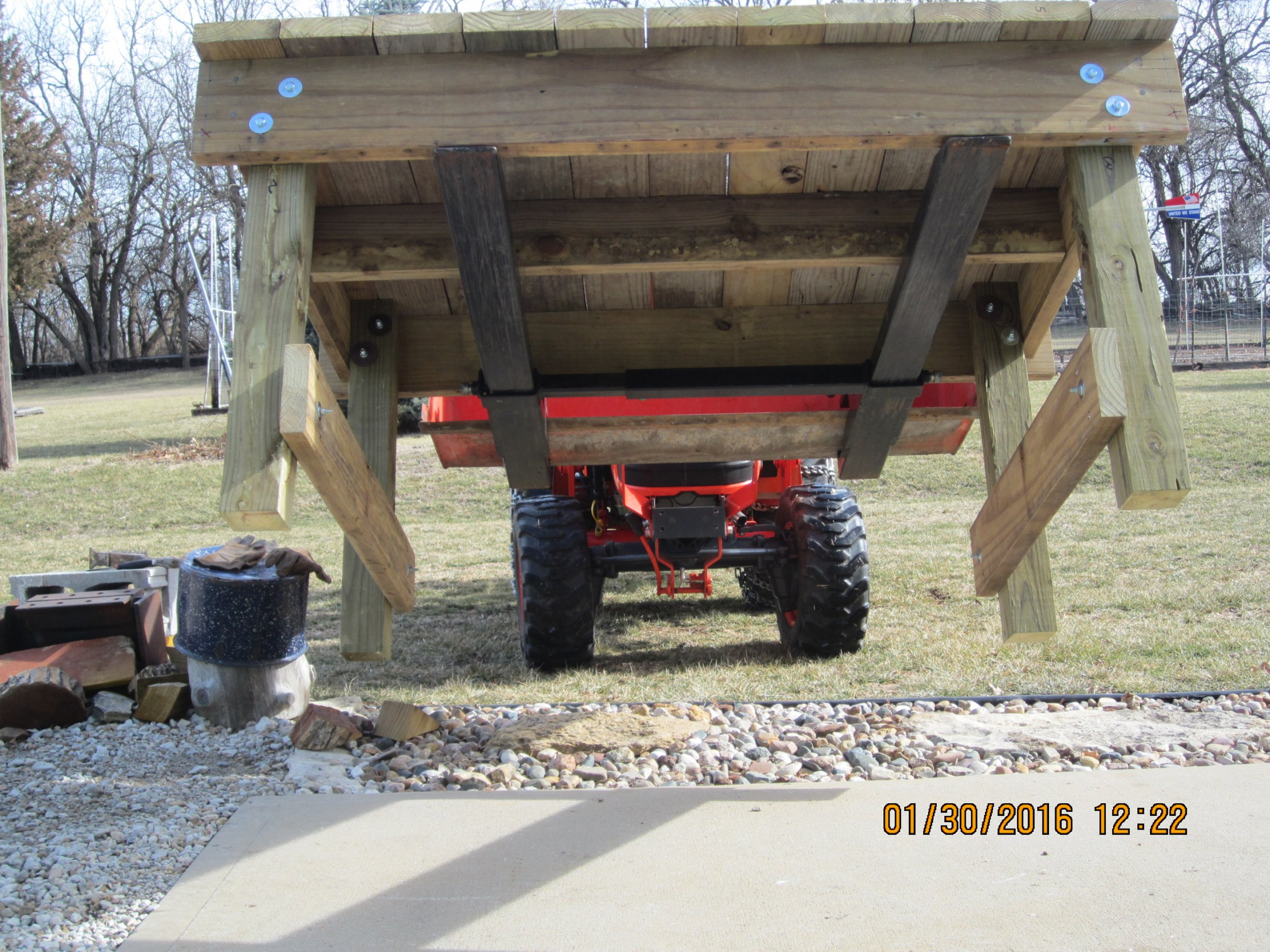

I've had clamp on forks for about ten years and find them quite useful on many occasions. Mine were from "Bucket Solutions" and are about 70 lbs apiece which is getting a little too heavy for this old man (89 YO 5'2" 140 lbs)) ...but I can still lift them. IIRC they are the 42 inch.
There are smaller varieties from different manufacturers. Again, I've found them useful for different things like moving hay bales, brush, heavy lawn tables. And "Yes" they are easy to store out of the way.

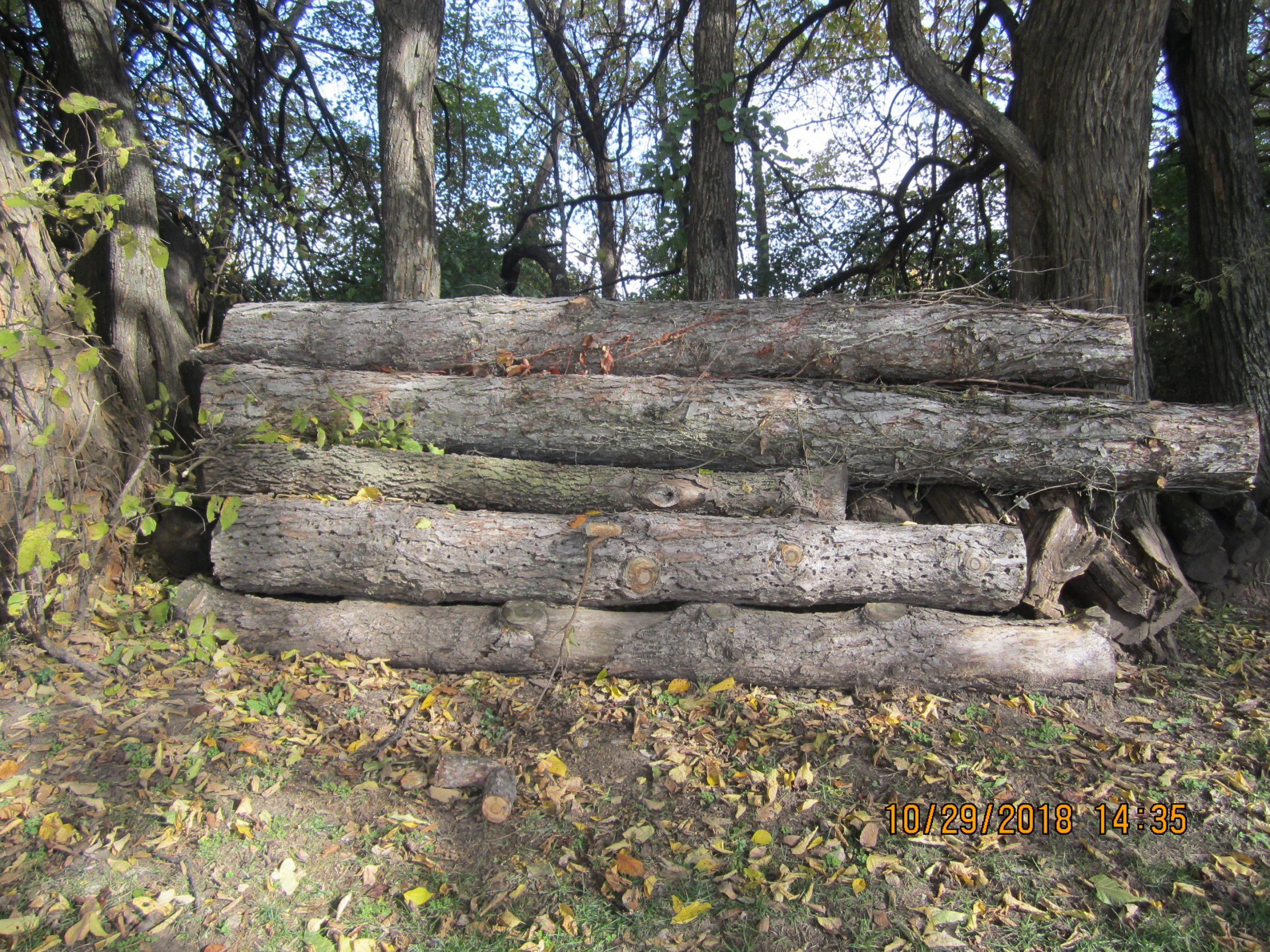

The B2620 with clamp on forks stacked these logs. How much you wanna lift?

I have a set of 48" bolt on forks for the HD bucket (has a 3/4" bucket edge too) and have used them a lot moving bricks and logs - probably more weight than I should have and they dimpled the bucket bottom but work well. Def get the brace setup like oldballs has or fab a way of holding them together - mine don't have that.

the stabilizer bar is a must
i advise chaining them to the bucket--this probably kept me from bucket damage. [ and keeps them in place]

the stabilizer bar is to stop the twisting. it does a pretty good job, too.
