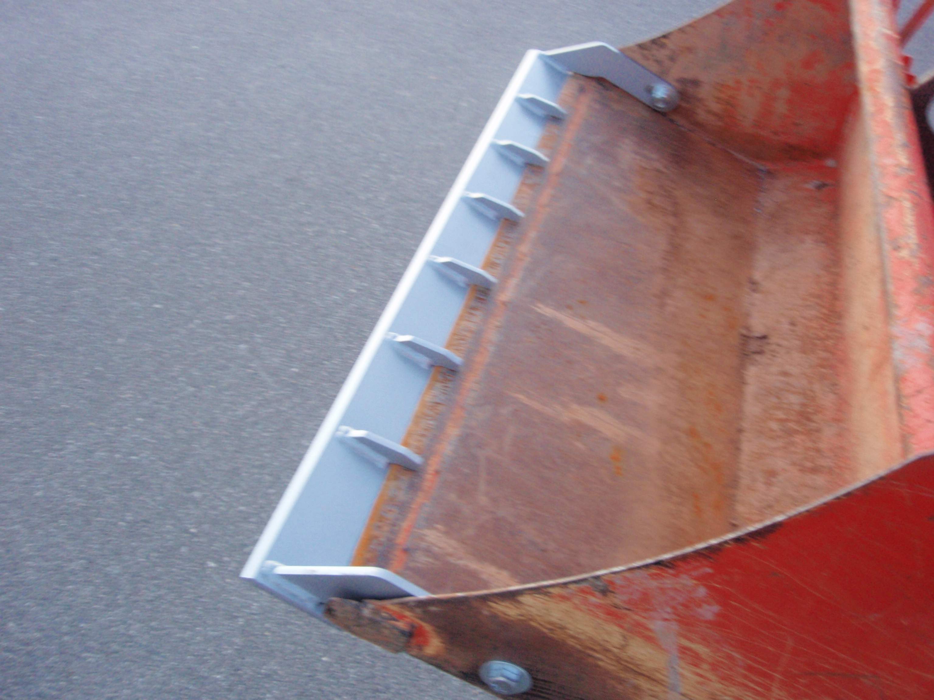

Ya I did it. Put one on my BX25-D. Everyone said there wasn't one available so I bought a longer one from my Kubota dealer and cut it. Here's a few pics of the process and the part number.

Nice job 4shorts, what was the thickness? How much do you figure it weighed after cutting? Thanks
/ Bolt on cutting edge for BX #4
I can't remember off hand the exact thickness but it's around 5/8th. I figure it added another 40 lbs to the bucket plus I added a top spill guard and it had no effect on the machines ability to lift a full bucket of anything that I put in it.
I put the reversible cutting edge on because the OEM lip wears fast on these buckets. I do 3-4 of them every year for customers, I have to cut out the worn section and weld in a new piece. I had a few where the bottom of the bucket was bowed because of the wear so the cutting edge adds to its strength plus prevents wear on the bucket.

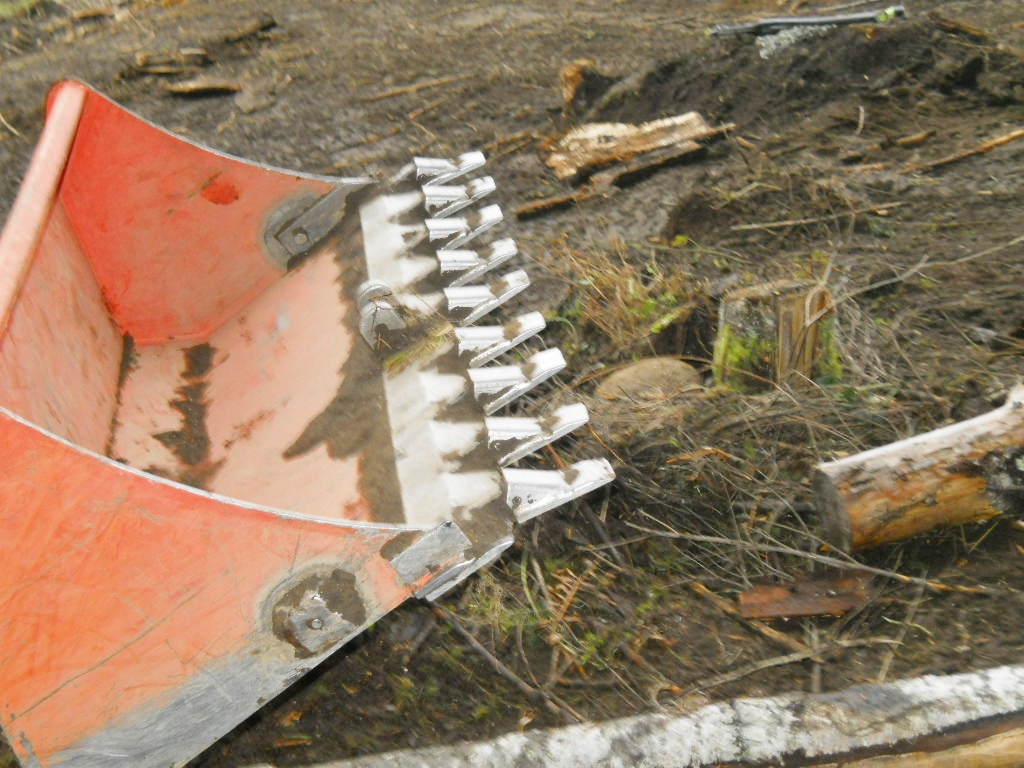

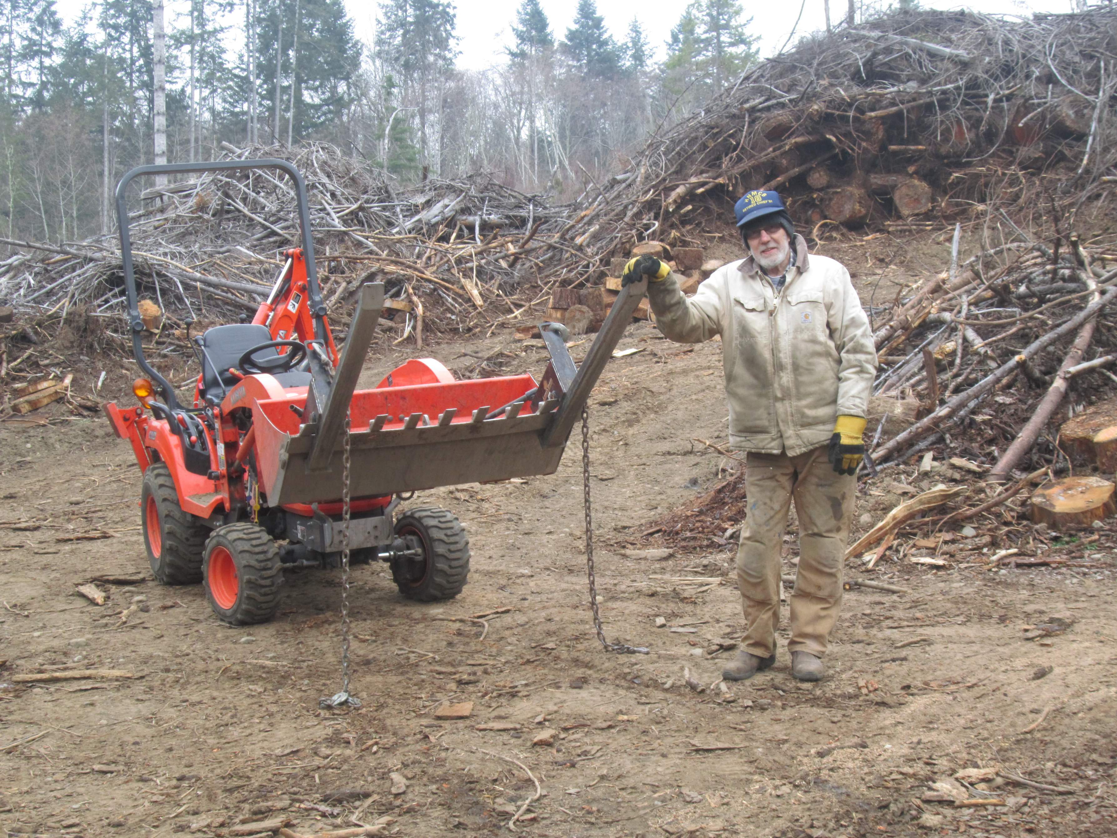

Here are some pictures of a tooth bar I made. I have not seen a commercial product that will do what these teeth will do. I can really dig with the FEL plus I spaced them so I could still use the clamp on forks. The 2 tabs in the center are to hold an attachment that is a class 3 trailer hitch. All so I do not need to unbolt the two bolts all the time. I seldom use the smooth edge anymore. The teeth are replaceable. The teeth help a lot when picking up rocks or limbs/logs.
Ron

Nice looking job Tractor Seabee!
Ron
View attachment 361416View attachment 361417
Yes Ron! Always impressive seeing the work you are done with your BX. I have a big pile of clearing debri at my place and you are an inspiration. :thumbsup:
