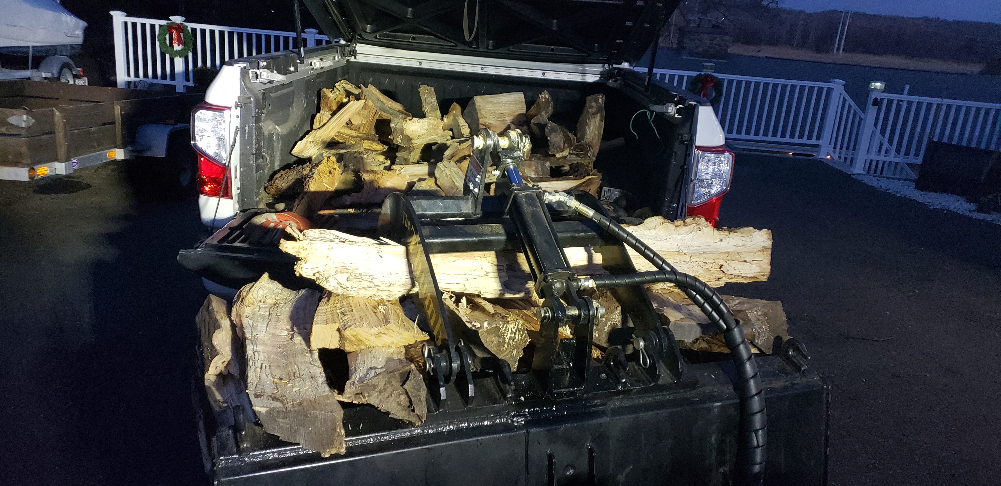

I just finished having the Thumb mounted on my pallet forks.
It is the 36 inch model and I figure the whole shebang with Thumb and mount weighs about 100 lbs.
Since the forks weigh a lot less than the 1 yard bucket on my M, I actual get more lifting capability with this set up.
