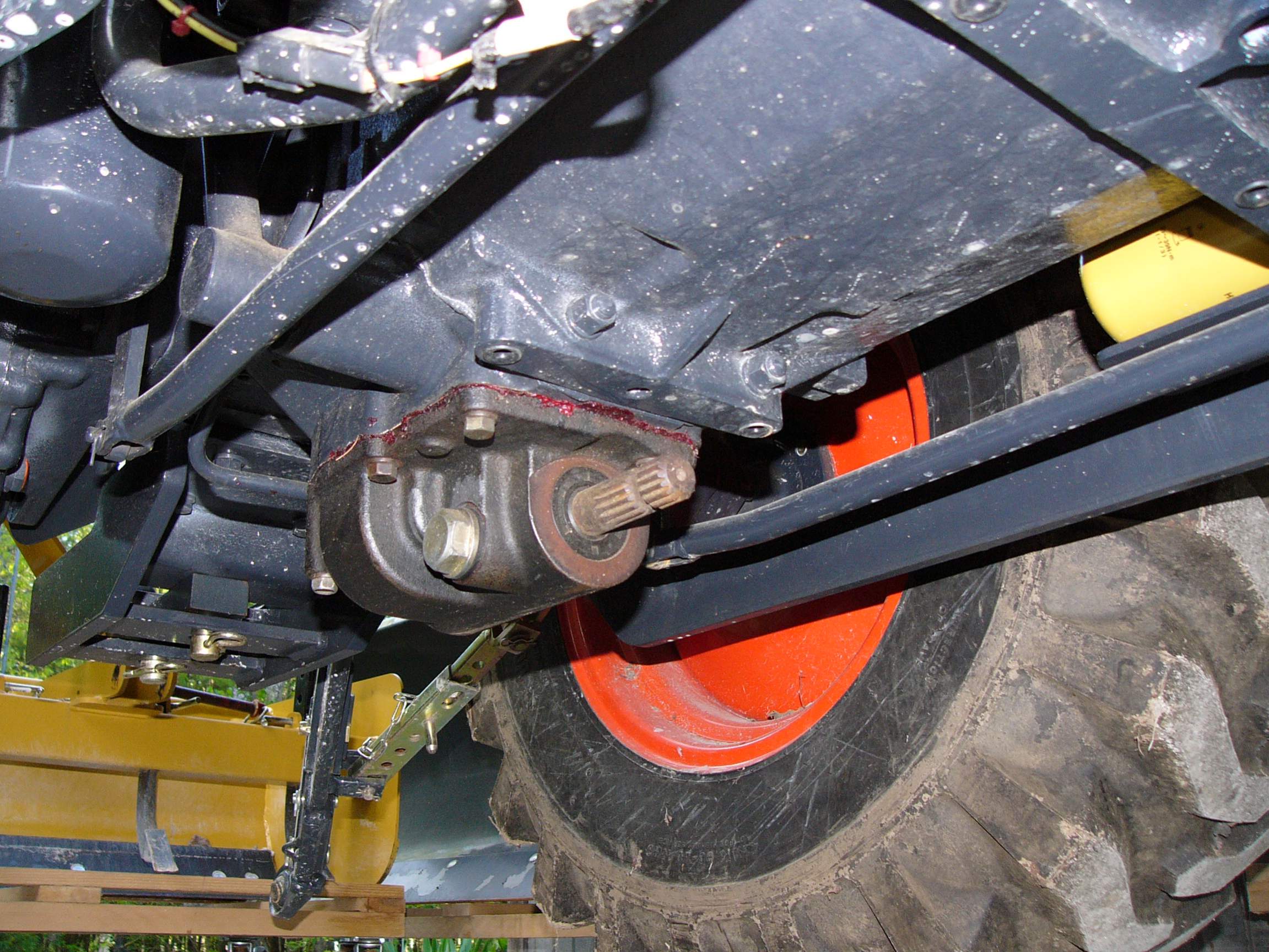

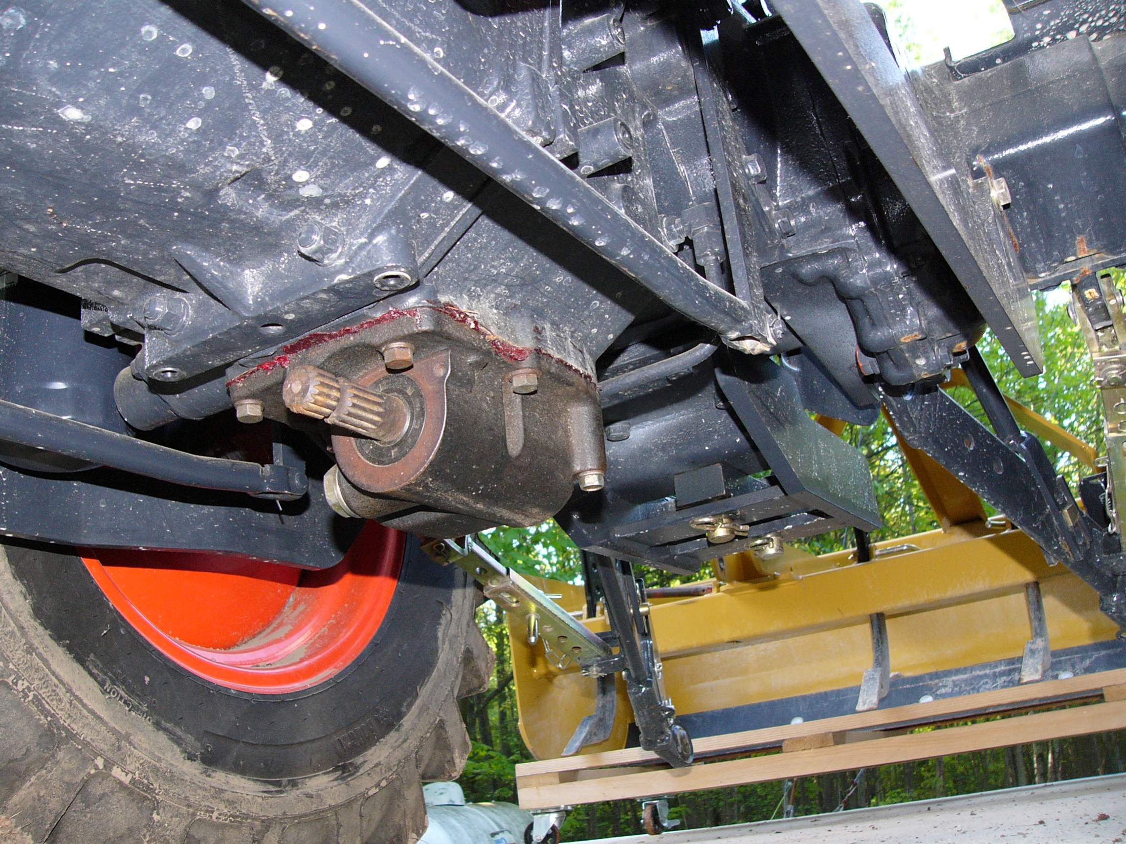

Life is full of surprises. I purchased my CT335 just a year ago, and though I didn't order this option,
I just discovered that it has a mid-mount pto. See attached photos. The only things that are missing
are the mid-mount pto engagement lever beneath the seat and the pto shaft cover. The newly discovered
pto does work but I just will not be able to dis-engage it to use just the rear mount pto.
MY question is: Is it possible to add the mid-mount pto engagement lever myself, assuming that I can get
that assembly from the dealer? I'll be checking with my dealer tomorrow, but thought I'd throw out the
question to forum readers for their comments.

Shouldn't be too hard to install. The pivot mount for the control lever is already on the frame under the seat, just a matter of installing the arm and attaching the linkage rod from control lever to the bell crank (control arm) going into the transmission. This bell crank is also installed at factory.
