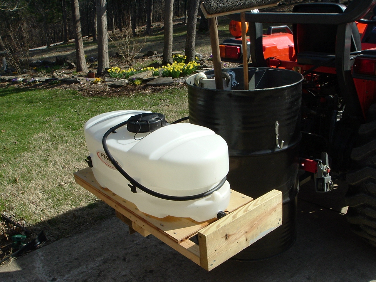

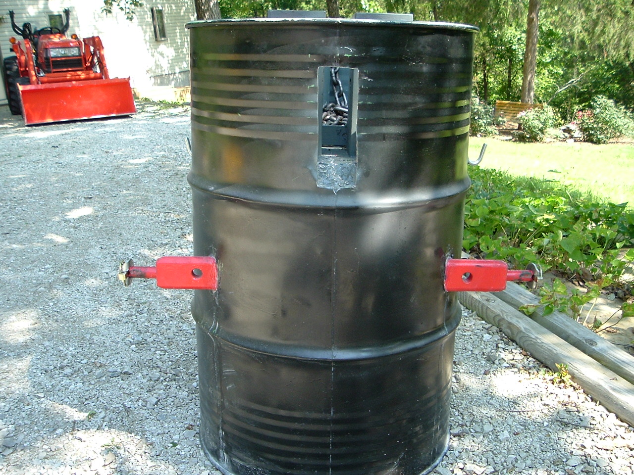

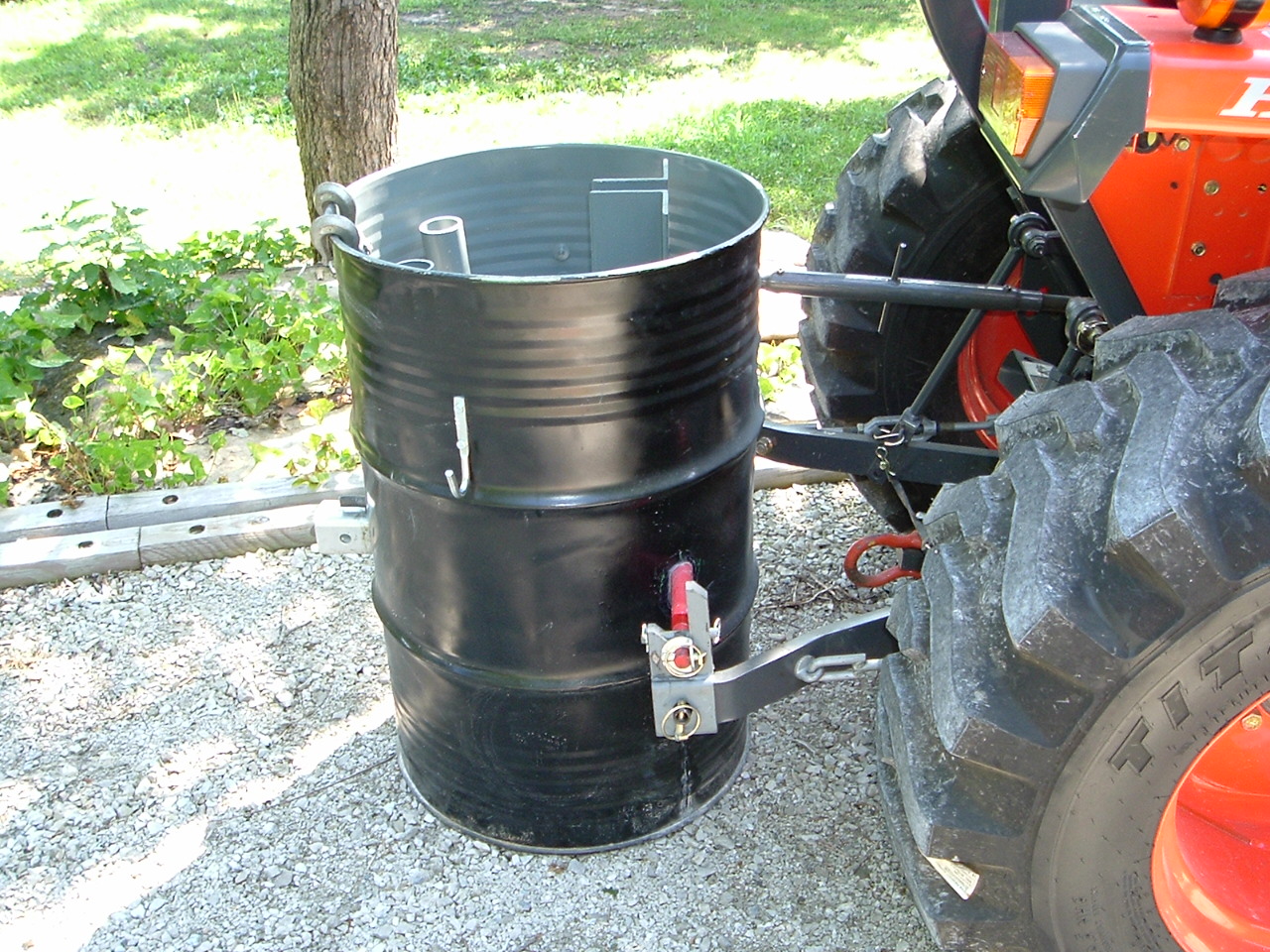

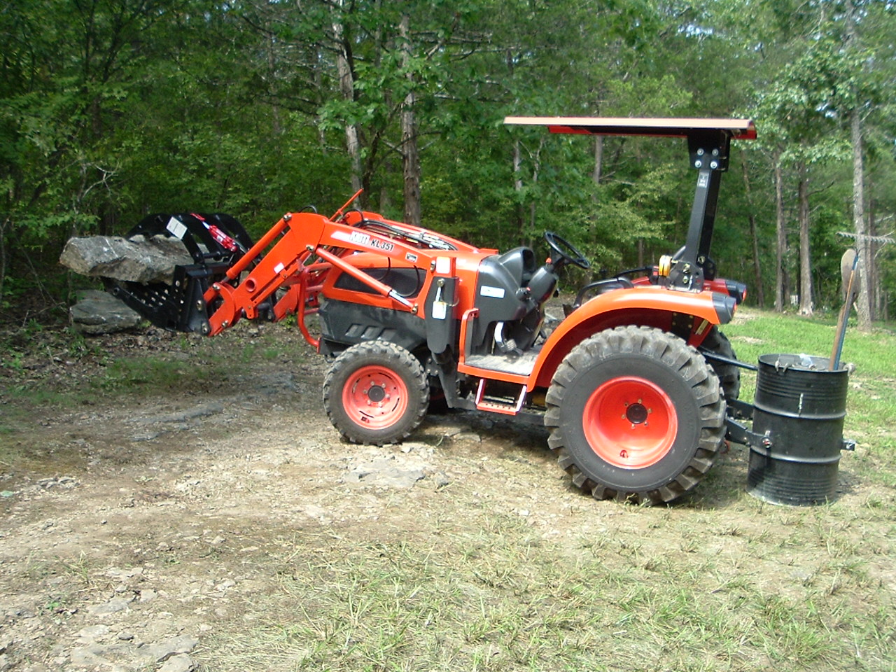

Or make one!:)

I find my ballast barrel very handy with the handle tool holders, and the chains storage places, as well as a place to put my chain saw. If you build one, you can make it any way you want to do what you want. I have about $100 in mine and with the 2 inch receiver in the rear I can "stick on" other items like my sprayer.:)
