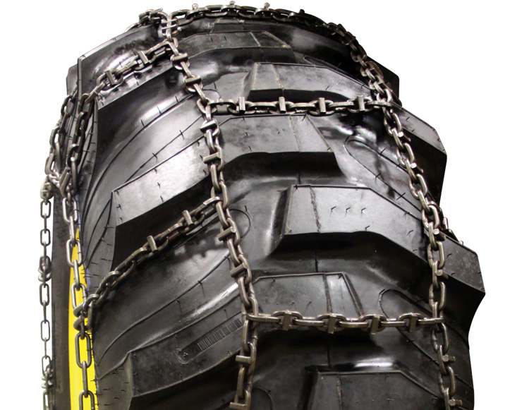

For the cost of new wheels and tires I would suggest going with something like the Aquiline MPC tire chain. It's designed for pavement and I think (don't have) the low profile will give a better ride than a standard chain.

Franko, I have not noticed any difference in traction between the metal and rubber chains while plowing/blowing snow over the years or had buyers remorse with the rubber ones. Please note I had the standard ladder style metal chains before and agree there are a lot more aggressive styles such as V-bar that would work great on solid ice. The rubber chains are not for everyone or every situation but they have worked surprisingly well.
The link is for reference to the metal chain styles mentioned above. 13.6-16 Tractor Tire Chain

On pure ice nothing is going to work as well a metal chains specific to the task. I've gone up and down some gnarly driveways and there are times I wished I had something besides the rubber chains. If safety is a question I'd error on the side of caution and stick with ice specific chains and live with the surface wear that comes with it. Also keep in mind your tractor is a lot smaller than mine, so once I get sliding it takes a lot more to get stopped.
Considering the cost I'd take the risk and try them for your particular situation. If they don't work I'm certain you could sell them for as many BX owners that are out there.

I run ladder chains on R-4s. They don't wear asphalt much if you don't spin, it leaves tiny white marks all over though that clients don't like. If you spin you will damage the pavement in a hurry. R1's are only better than R4's if you get skinny ones. Turf's have much more snow/ice traction. My other tractor has R1W's in a large metric footprint, I can't use it without chains on it in the winter, it simply can't move with any snow or ice on the surface. Even in 4wd with both front and rear diff's locked it can't get up a plowed driveway. Really embarrassing actually.
