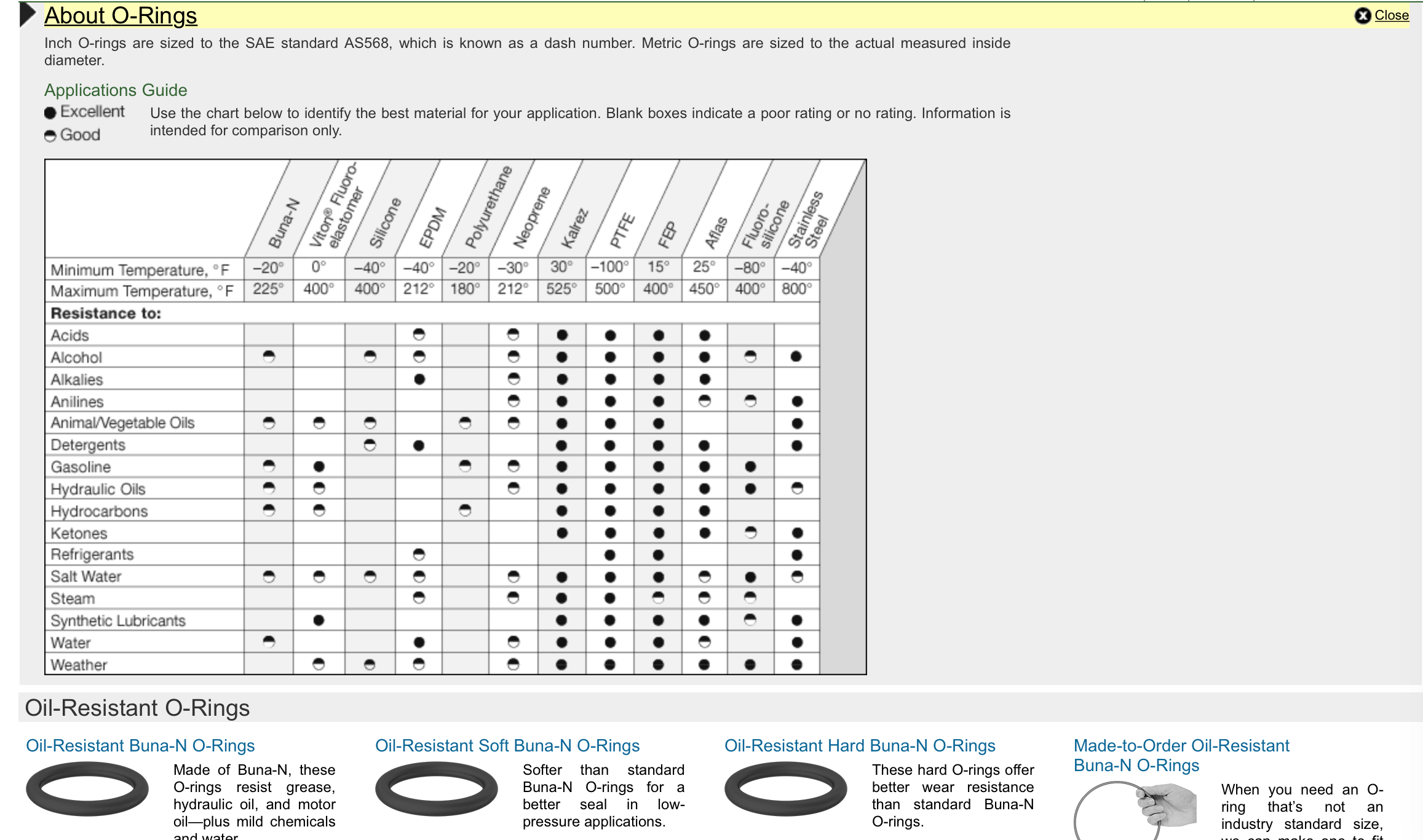

An interesting problem. I guess the first thing I would do is to make sure I had the right O ring material. Then Pressure and then Temperature. All of those are capable of being checked by most mechanics. An inline pressure gauge can be made up for under $50 and is handy to move around to different places for all sorts of diagnosis. I leave mine in the loader line.
On materials, O rings are often misunderstood & wrong material used. I had a lot of problems at one water treatment plant until we finally figured out that the tech was using vaseline instead of silicon grease to hold the O rings into place on the city's big power water pumps he repaired. Vaseline seems perfect, but there is some chemical reaction that caused the O ring to expand, lose hardness, and crawl right out of the O ring groove. Changed that and no more problem. We would never have figured it out if someone hadn't run short of O rings and tried to put some that were stored with the vaseline on them back into the O ring groove. We found the spares had all mysteriously become way too large to fit, and BINGO! we had found the problem!
Go to Mcmaster.com & look up O rings for a quick overview on materials.
rScotty

What type of seal material was being used on those water pumps? I 100% agree some materials are not compatible with oil but I also suspect vast majority of O-rings used in hydraulics are nitrile- Buna N or viton - fluorocarbon.
I still suspect surfaces not flat as main culprit since there needs to be a gap for the O-ring to extrude.
/ Blowing out o-ring, stumped, need help! #15
Rscotty
Oldnslo,
I don't know the original O ring material. In the water pumps I mentioned they were part of the supplied repair kit. Keep in mind that the application I mentioned was cold water, not hydraulic oil. I only brought it up so as to point out that there are some weird material compatibilities involving O rings.
To the engineer's surprise, the incompatibility between Vaseline and some O ring materials turns out to be a well-known problem. Check it yourself. Smear some O rings and put them in a baggie. It's not a little change, it's obvious. Or google.
Getting back to the OP's stump grinder. My preference would be not to use Buna-N - even the oil resistant types. Not enough high end temperature range. I'd rather go Viton there - but I have NOT checked for hydraulic oil compatibility.
