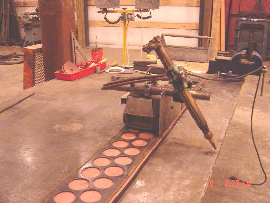

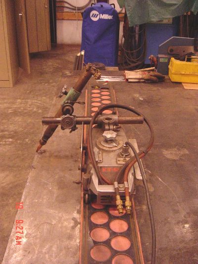

/ beveling plate #3
Yup, a tractor torch is the only way to go. I paid $50.00 for this one. :thumbsup:
I have one similar to yours, but no track. Do you think it would ride two small angle iron strips?

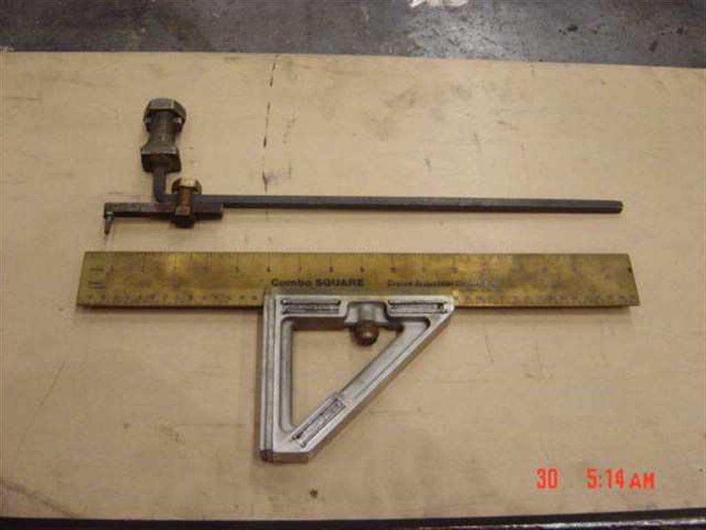

/ beveling plate #7
You can free hand that, or build yourself a burning bar. You don't need a magnetic one, just use a pair of vice grips. Maybe take two pieces of 1 1/2-inch flatbar 18-inches long, tack them together on edge at say 35-degrees, tack another piece in the center 90-degrees from the two others, this is where the vice grips will clamp.
Here is a magnetic burning square I've had for years.
I don't see why not, just use flatbar to maintain the width.

/ beveling plate #10
We used a track torch like that to cut our beveled plates for the plate tests we were doing in class. We'd clean them up on a large belt sander/grinder with a flat section. The track torch had a front pair of wheels with a groove in them that rode on a piece of angle as the guide track. The back wheels rode on the flat platform, unguided.
