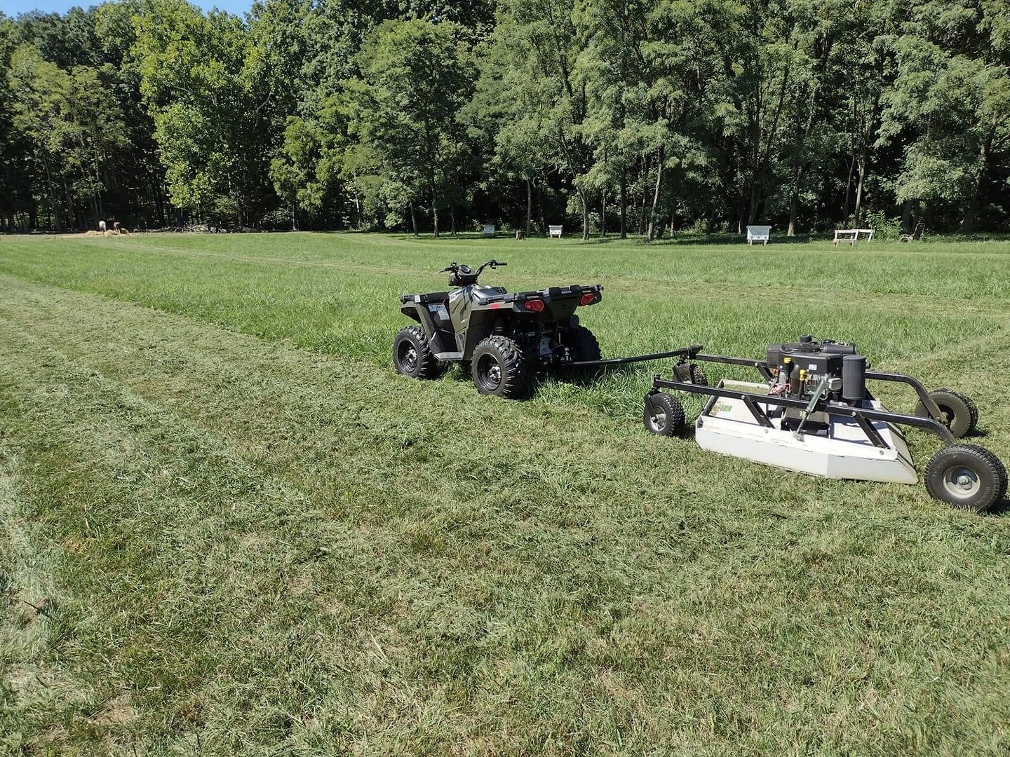

Our 57" Kunz mower is 27Hp and an absolute beast. I run it offset and our little Polaris ETX pulls it with ease.
