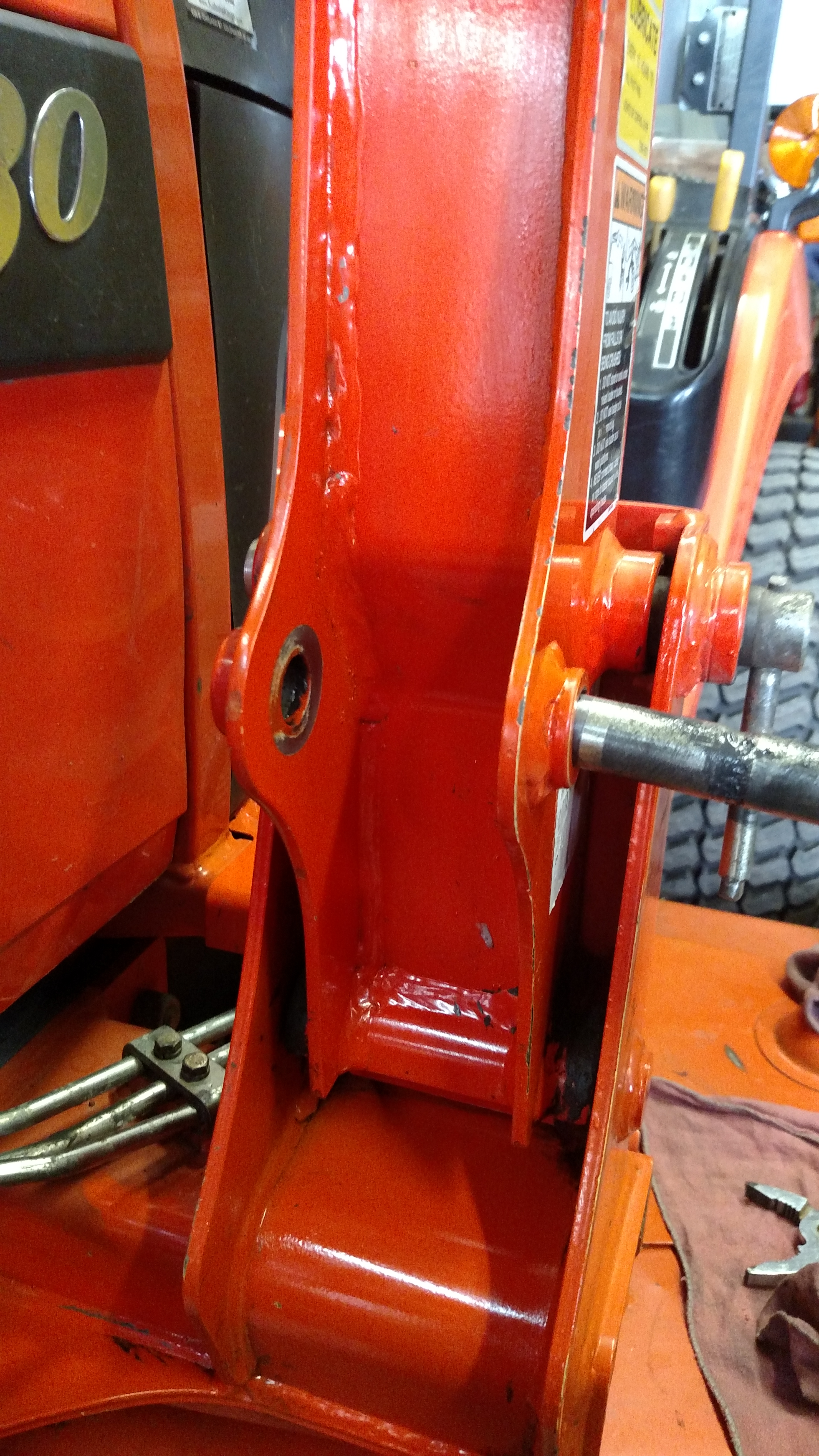

Now, I use these on just about everything, including my hands. But, to be honest, I have never removed the 'extra' grease from the joints. I simply dont care that much. What I do care about is the zerks. I use a towel to clean the zerks before pumping fresh grease. I also use them to clean up the grease gun when I'm done.
This weekend, I actually went around to all the recessed zerks on my FEL and cleaned them out. The hole they reside in were all full of old grease, dirt, etc. Took a small flat screwdriver to remove the bulk of it all and wiped them out with the Tub O Towel.
I have a video of how I grease here: Tools, Techniques, Tips 'N' Tricks - Grease! - YouTube
