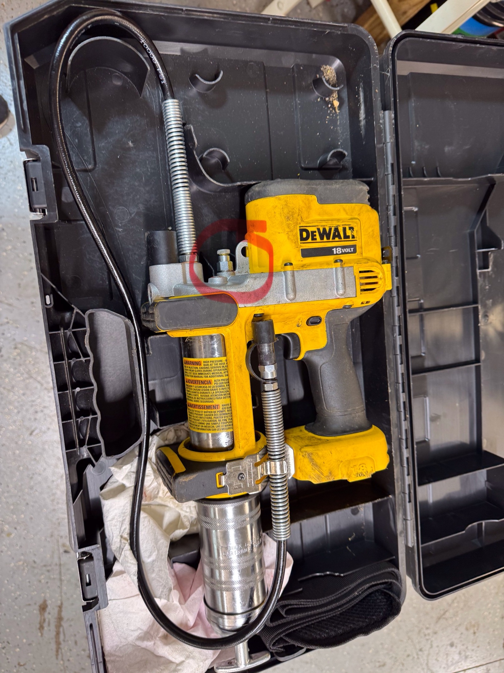

/ Grease - is there no better way? Can we talk about this? #166
In simple terms, I feel every 100 spent on grease will save 1000 of machinery cost later. So I do anything I can do to make it "easier" to grease. I'm not saying to grease too much, just that it's beneficial to remove (perceptions of) obstacles to greasing.
So next to the grease guns I have rolls of blue paper, ready to pull out, and a waiting bin. Leather gloves + nitrile nearby.
The actual grease guns are screw-on manual type (Fuchs in my case). So much less faff than the old type of cartridge, and zero mess when changing cartridges. 2 fresh cartridges are adjacent, and it really takes 10 seconds to replace a cartridge in the gun. Then a G-coupler on the main gun. Another has other fittings for odd zerks.
Minimal mess and no excuses for not greasing!
/ Grease - is there no better way? Can we talk about this? #167
Tried the horizontal storage. The oil that stays in the gun then runs out when you are using it, dripping onto everything beneath. If you happen to be laying under a piece of equipment, guess what's beneath...
Good point. I had not thought of that. I wonder if flipping the gun over every once in a while during horizontal storage would help keep the oil in the grease. In the long run if the oil leaks out, the grease will not be very effective at lubrication. Maybe all grease tubes should have a "best before" date on them.

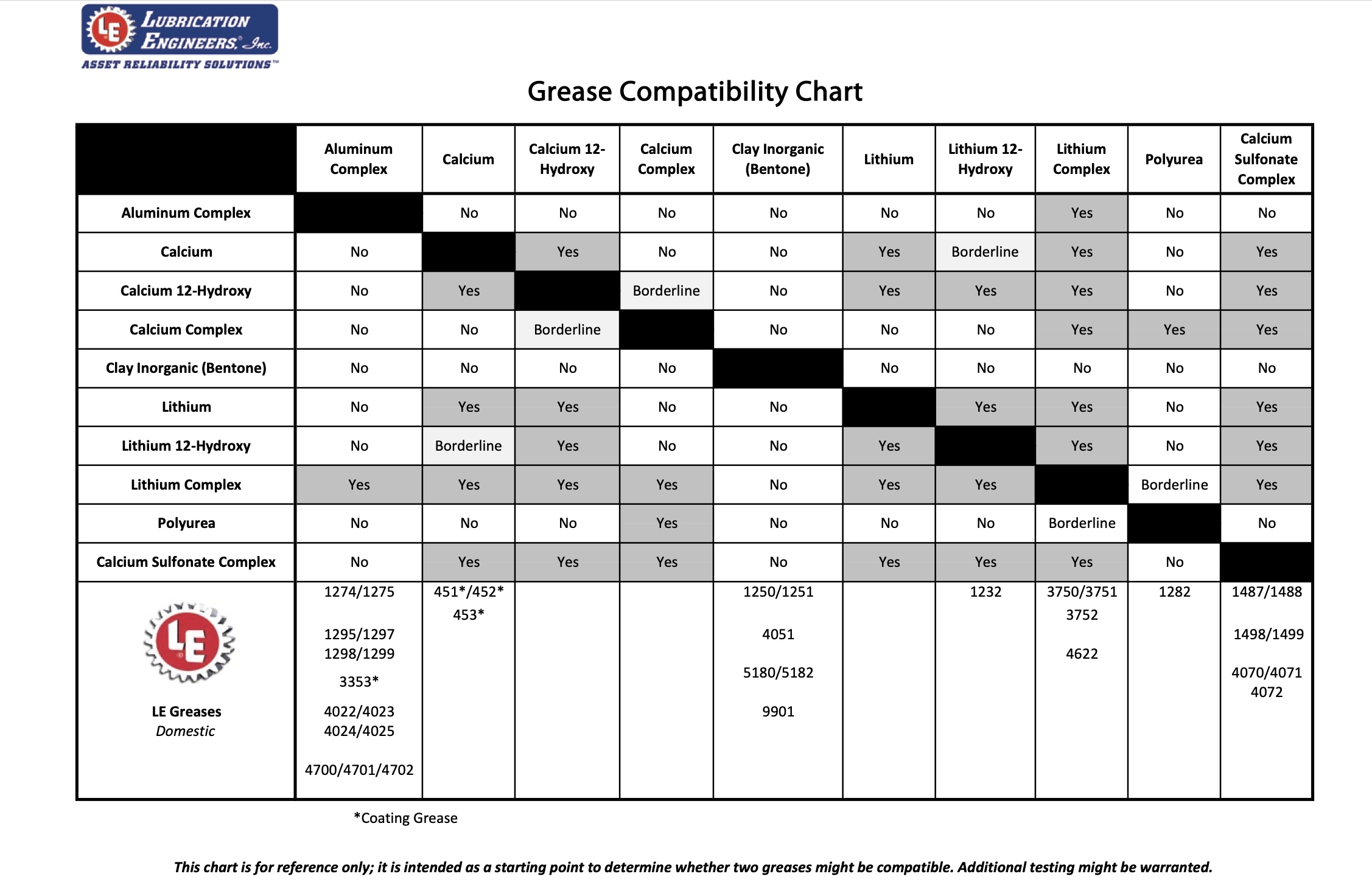

In the Texas oilfield and farm we used to have problems with grease compatibility - at least we thought compatibility was the reason that caused grease to harden. Loader bushing pins locked up by hardened grease were a big problem - we never could figure out why it happened some times and not others.
Of course lots of times we were greasing equipment without knowing what kind of old grease was already in there. We avoided aluminum based greases just because grease tables show they aren't compatible with most other types of grease.
Does any of that apply to Shaeffer's aluminum based grease?
From the chart, Lithium complex seems the most compatible.
How does one select "Lithium complex" at the grease counter?
Is there an obvious lable on the tube?
