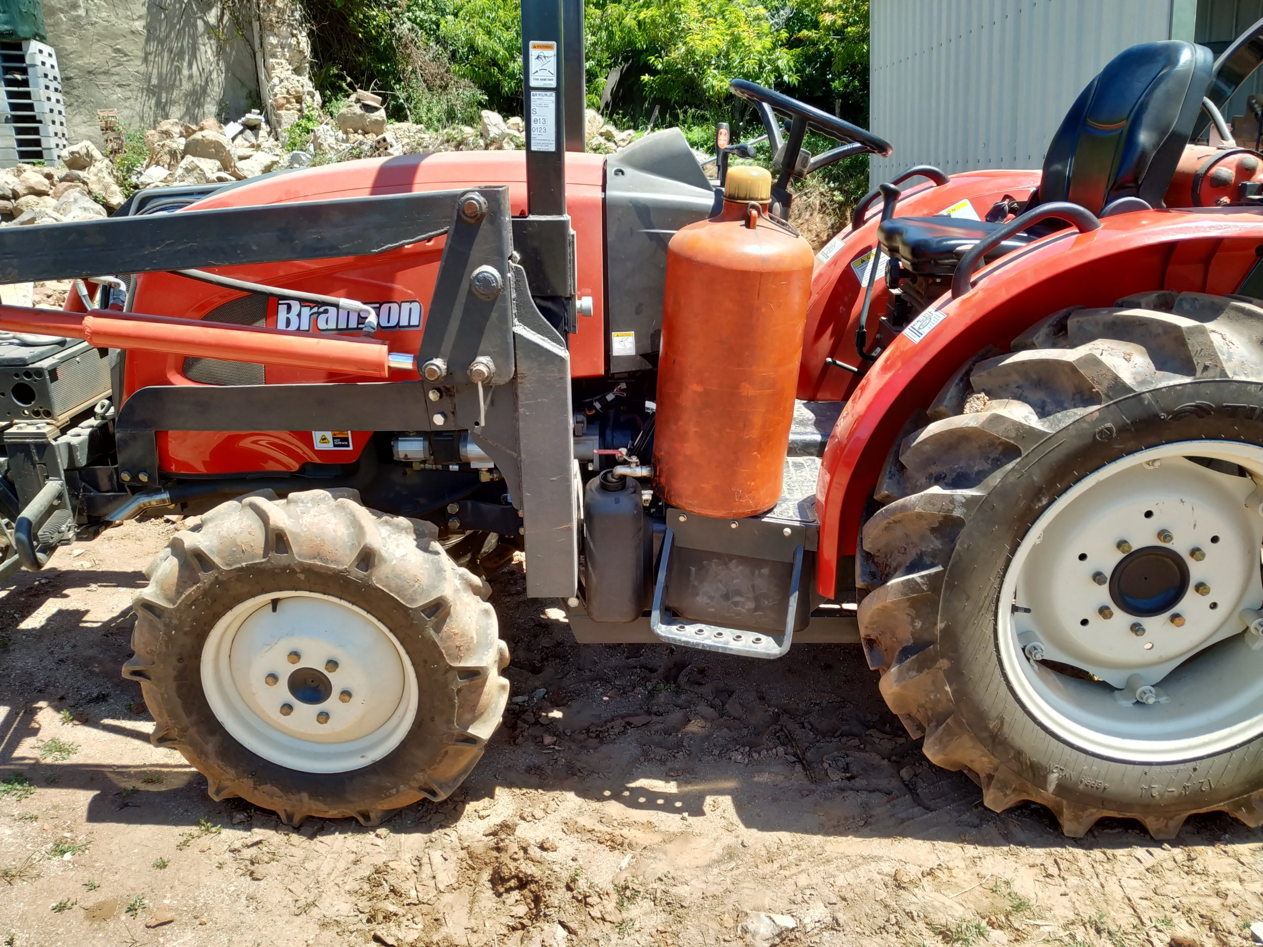

I just set my tank on the floorboard of the tractor, open the ball valve and wait a little bit.

Nice. Unfortunately some of us still drive orange tractors that fill like lawn mowers .
I have been using a 12v pump for 5gal can transfer. I'm in the process of moving to a 55gal blue plastic barrel with the same pump

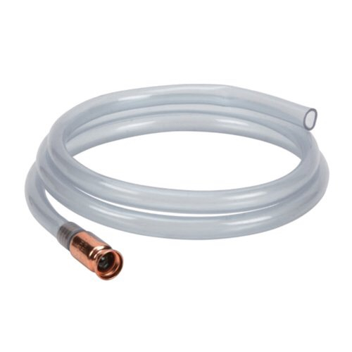

A “shaker siphon hose”. Self priming with a couple shakes. About $10.
1) Set fuel can on tractor (fender, hood, etc..) above fuel tank.
2) Inset check valve end of hose in fuel can, other end in tractor tank.
3) Shake check valve end of hose up and down a few times.
4) Go do something else for 3-4 minutes while can empties.

Siphoning is the best. But I use a longer hose, put the container in the FEL, use the FEL to do the lifting.
