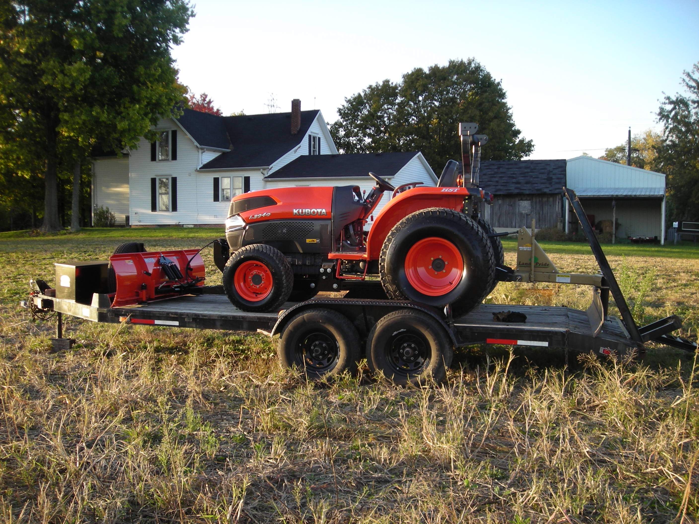

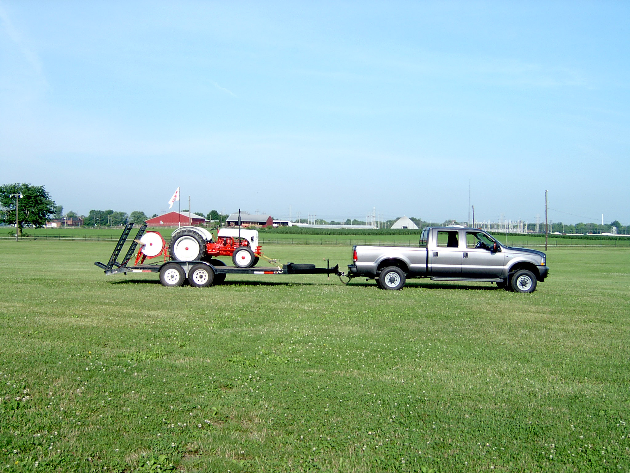

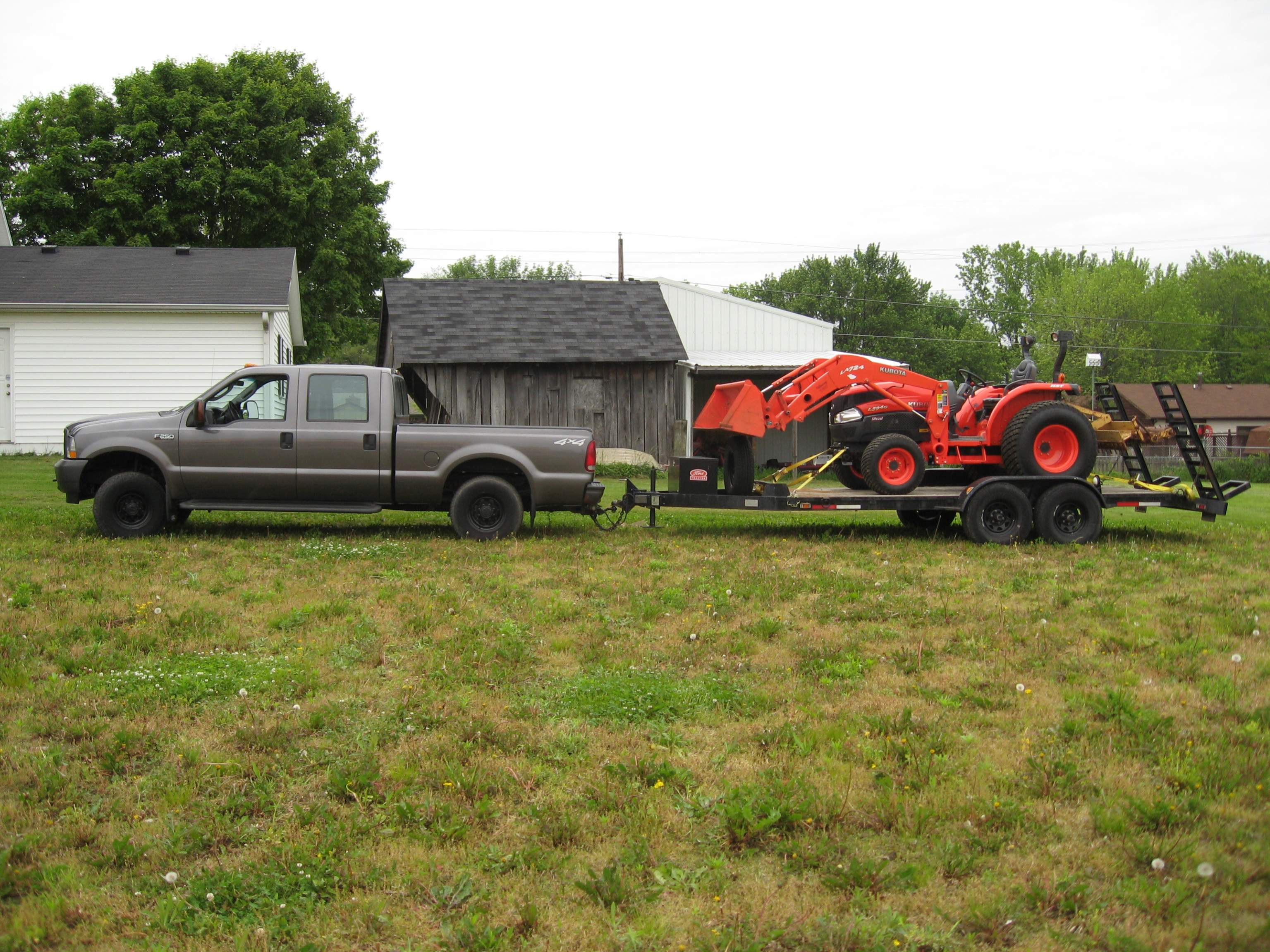

This is a 16' plus 2' beaver tail rated 10K. I would go tandem to distribute the weight better. It is very easy to quickly run out of length. Electric brakes are a must! Philip.
