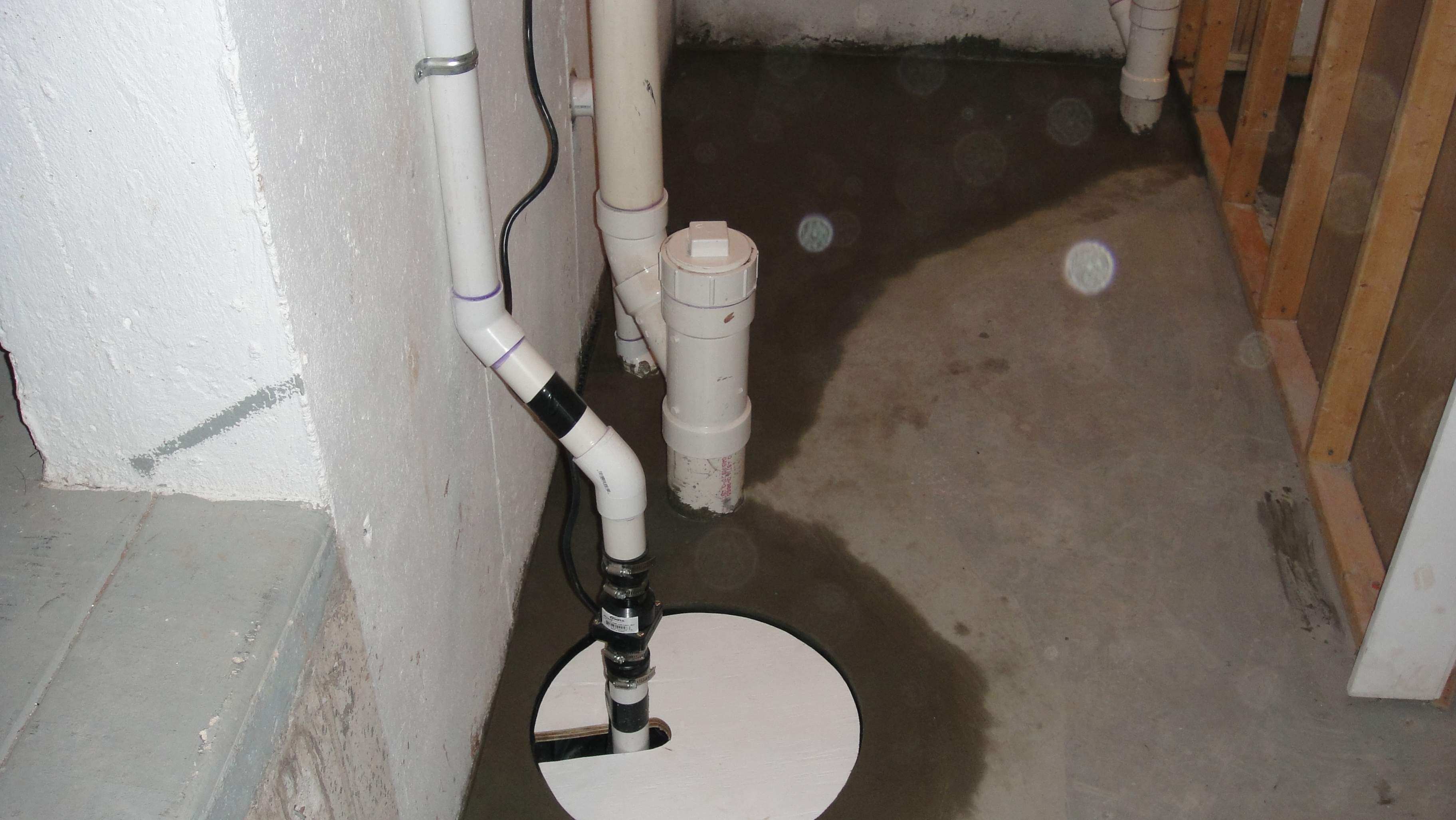

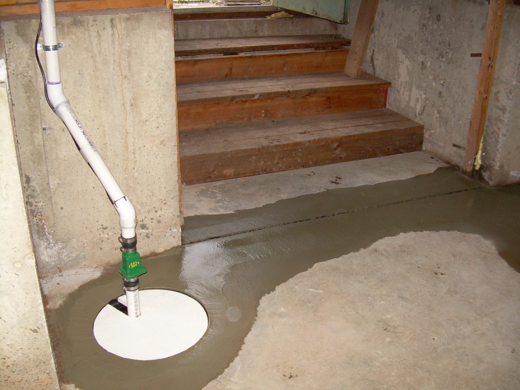

If water stays in a shallow pipe in the winter it will freeze. always leave an outflow outside the foundation, so if anything freezes the water can still be pumped out. this can be done just by leaving a space between the 1.5 and 4 inch pipe. The 1.5 can be 4 inches above the 4' pipe, at least in the winter, leave it set up like that.
I use 1.5 PVC with schd 40 fittings. the pipe is rated schd 40 but the regular DWV fittings are not, it's not because of pressure but the 40 fittings have a longer bell to glue the pipe in.
Use a check valve just above the floor to prevent vapor lock. and bring the pipe to the wall with 2 45's and clip it to the wall to keep everything solid and prevent the pump from moving.
That's how I do it, but 99% of the pumps I install just have a short stub out of the house on the down grade side. 3-4 feet out on the down hill side and no water recycles.
JB.
/ Best pipe for sump pump outlet #8
JB.
JB do you have any pictures of the outside of the house? Is the pipe stubbed then a 4" run started 4" away below frost depth?
Thanks

I don't think I have any pictures of outside like that, first of all like I said rarely do I put them under ground. Often times I drill thru the foundation wall about a foot above the ground and come straight out with no elbow, about 18 inches of 1.5 thru the wall and about 4 ft long pc of 4 inch sleeved over it, not pretty but effective.
That has to be done on the side of the house that the topography allows for the water to run away from the house, even just a little pitch is all that is needed.
If you are going underground then the way Deere Dude describes below is the way to go, I have done them just like that on occasion, but have no pics. My shop has a small basement and that's how the sump's discharge comes out. It only goes 20 ft under a driveway and spills into a swale.
Mine is only about a foot deep, but if you are going a long distance and live in a freeze zone I would go lower, if you can go below the frost line that would be ideal, most people don't, and though true usually sump pumps are not working much in the winter.
In the early spring when the ground is still frozen, but the snow is melting and it's raining, that can create a heavy demand on the structures drainage system/ sump pump.
I may be overly cautious about the freezing thing, it doesn't happen that often, but I have seen it and I can not leave a paying customer with even a slight chance of it happening.
