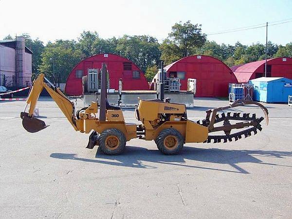

Hello all,
Thought my question would best be asked in a new thread rather than continuing with my previous thread about potential owner questions...
I've read quite a bit of material about minihoe & backhoe for PTs, but am still left with the following question:
Like KenT, I live in the North and would like to dig 6+ft to get past the frost line. Unlike KenT though, I do not plan on owning a PT larger than the 425.
The minihoe won't do, a Lackender skid-steer hoe is too large/heavy/demanding for a 425, and I seem to recall that the fella who custom-fitted the backhoe of a PT2425 on his 425 had some stability challenges...
So, does anyone think they have come up with the best off-the-shelf solution to digging 6+ft with a PT425?! (I say 'off-the-shelf' as fabricating a hoe is not an option for me, for several reasons.)
Worst-case scenario, I suppose a beefier and longer version of the minihoe could be built.
Pls. feel free to refer me to earlier threads that I may not have been able to find in researching an anwer to this question.
Thank-you in advance,
PTWannaHave

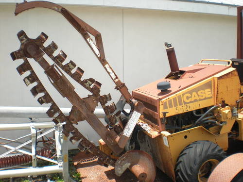

Perhaps something like this. Use the backhoe of the chain trencher
