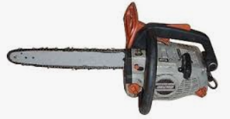

My Go to saw is a Husqvarna Farm Tough 55. Had it for decades. 1995 era. Old and injury's so I also use a Echo CS-3510 for the smaller limbs and trimming.
Almost 1 Yr. old come Jan.. I was surprised how well it works, starts and cuts. It is really easy to use on small debris. The 55 is Old school and just plain and simple a BA. saw!!. 18" Besides chains I had the shop where the echo was purchased rebuild the Carb. and replace the muffler. Still use the Org. bar. They even complemented it! You could tell when I got it back they didn't miss a lick... Runs and cuts like it was new.
