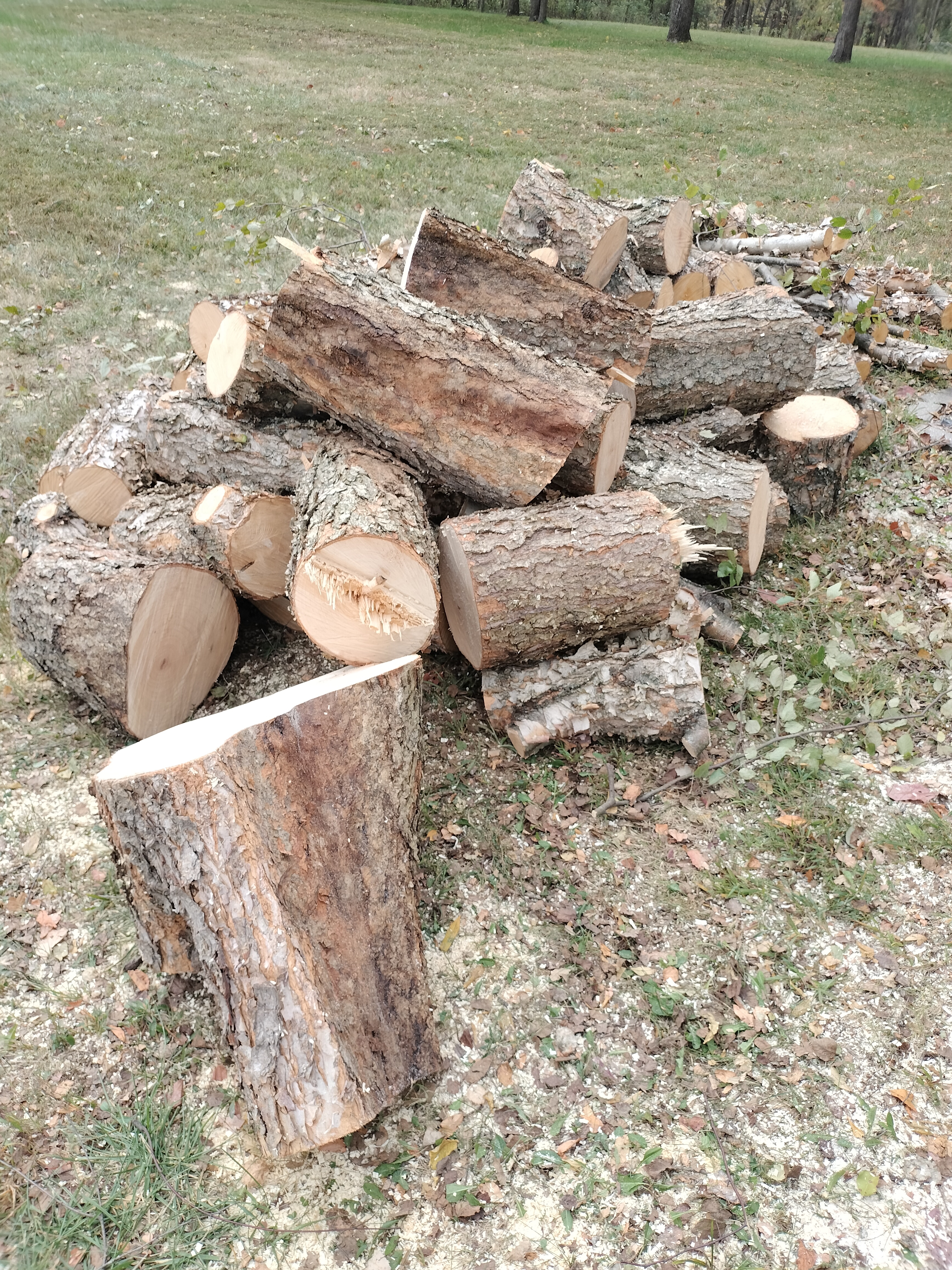

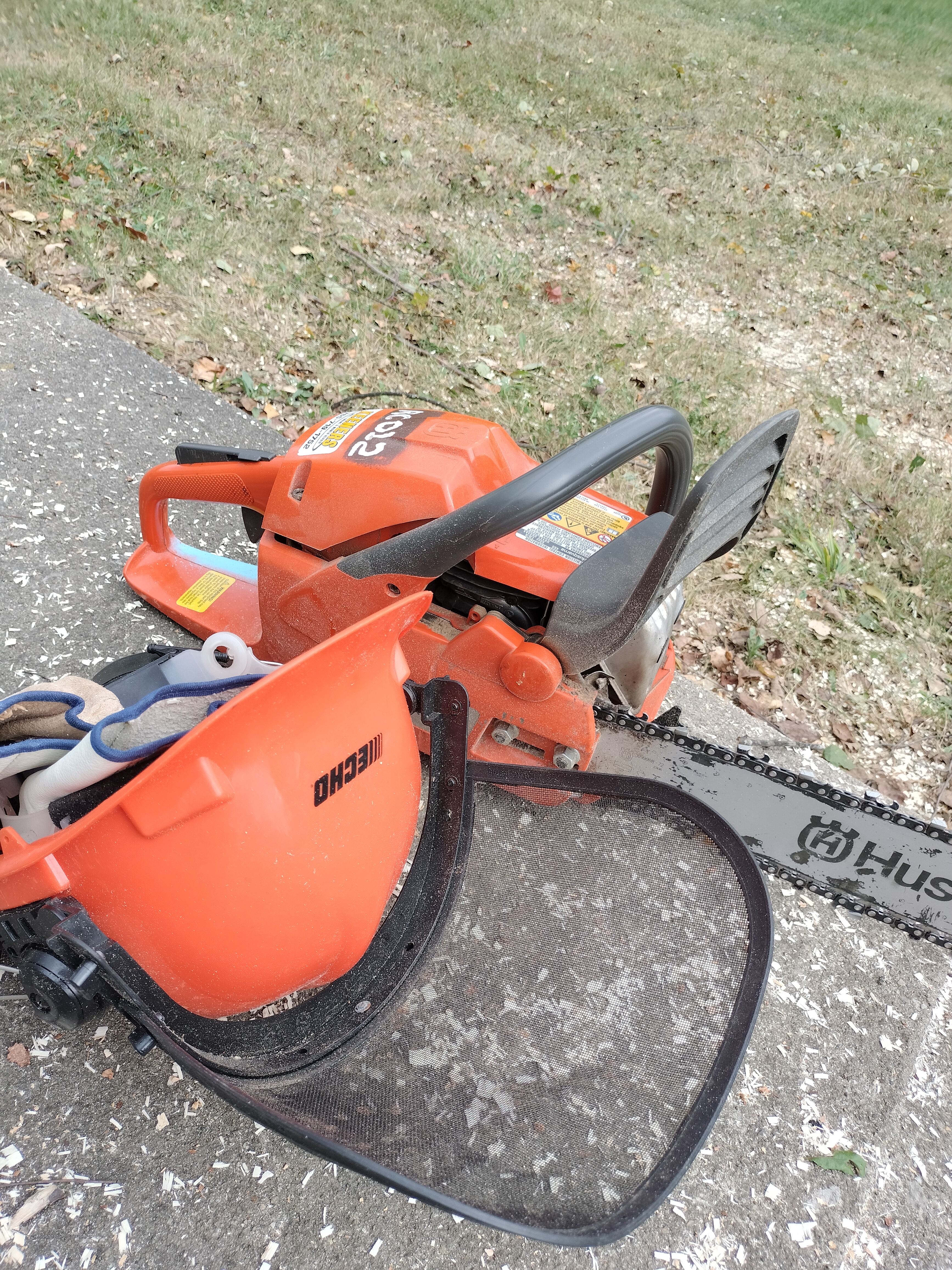

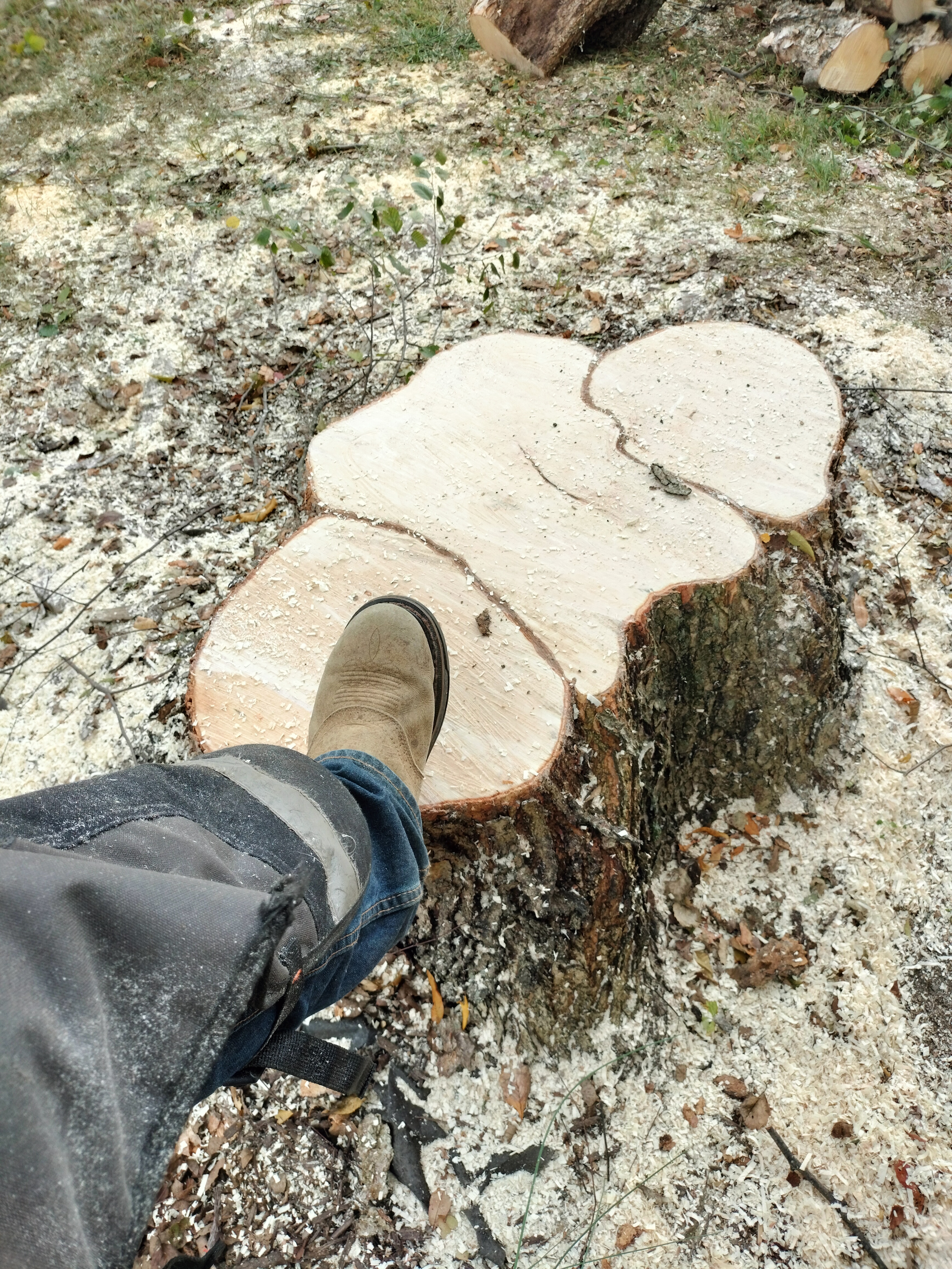

I got the long bar to cut up a 5' diameter white oak tree that had died and fell over this summer. I used the regular 20" bar on most of it but wanted to cut up the trunk without having to rip cut it.
The chain is a standard Oregon chain not skip tooth. Echo bar.
It did a good job, never got stuck. Had to cut from both sides So yeah had it all engaged.
Oak isn't as hard as Hickory, it cuts pretty well. Probably took 5 min to get through the trunk.
This was a bonus that didn't want to leave on the forest floor over the winter.
Motor on the 590 is stock and about 12 years old. The saw is more nose heavy of course.
I buck the wood down making about 9 chords a year for firewood. I am not a logger. Just someone who likes to stay warm in the winter. The first year that we were here, 15 years ago, we would cut wood in the day to burn it that night. No desire to do that again.
This was the biggest tree on my property. We now have big chunks of wood that need to be processed. Hopefully will be lighter once they dry by next spring.
I have saved some 3-5" thick slices of trunk. Want to make some rustic tables.
