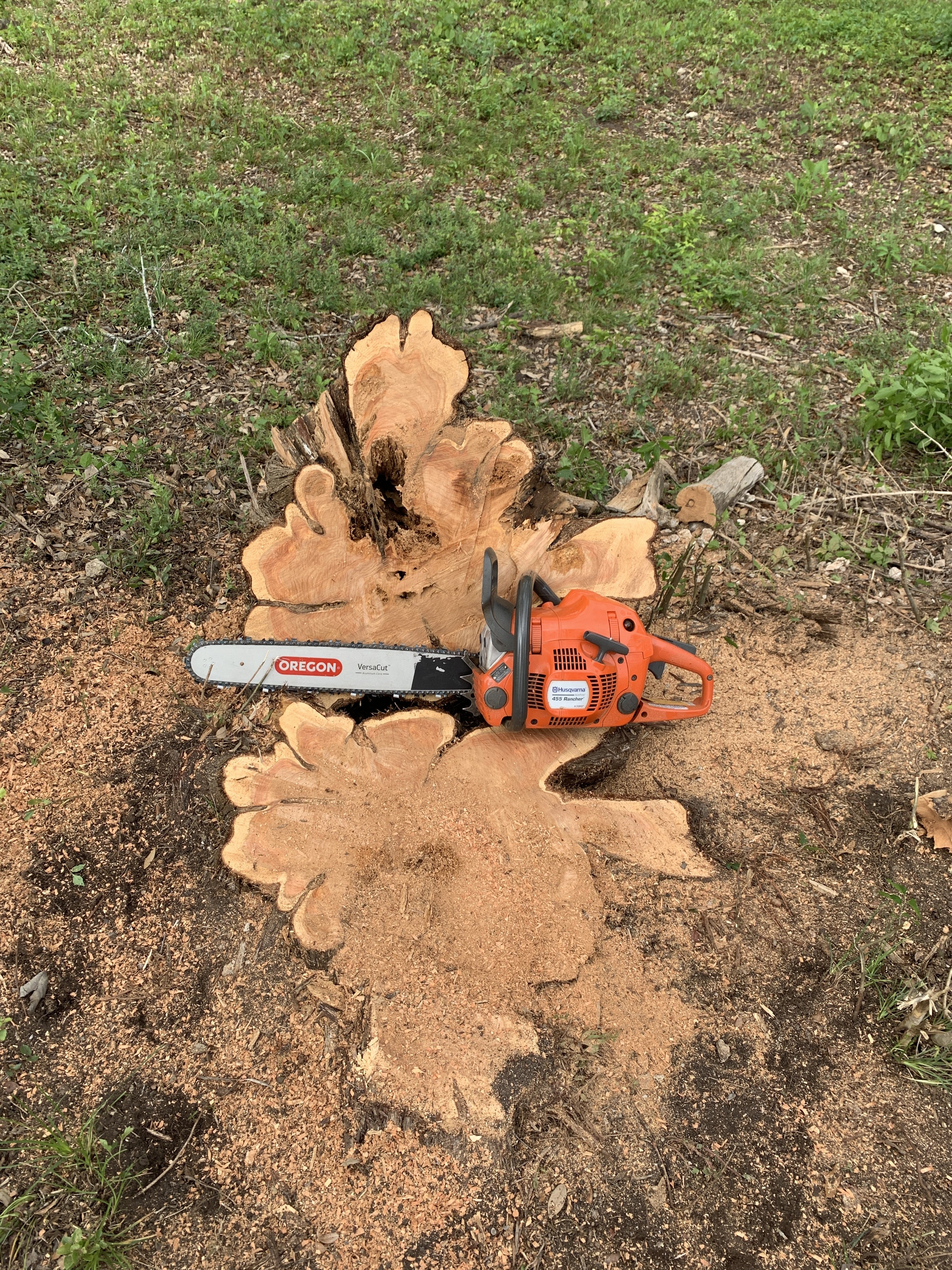

I cut firewood every year on my property with a husqvarna,i have a 445 and 450 rancher ive used for years,i even backed over the 445 with my f250SD and just cracked the plastic 5 years ago and still going,but my 450 is my go to,does all i ask
