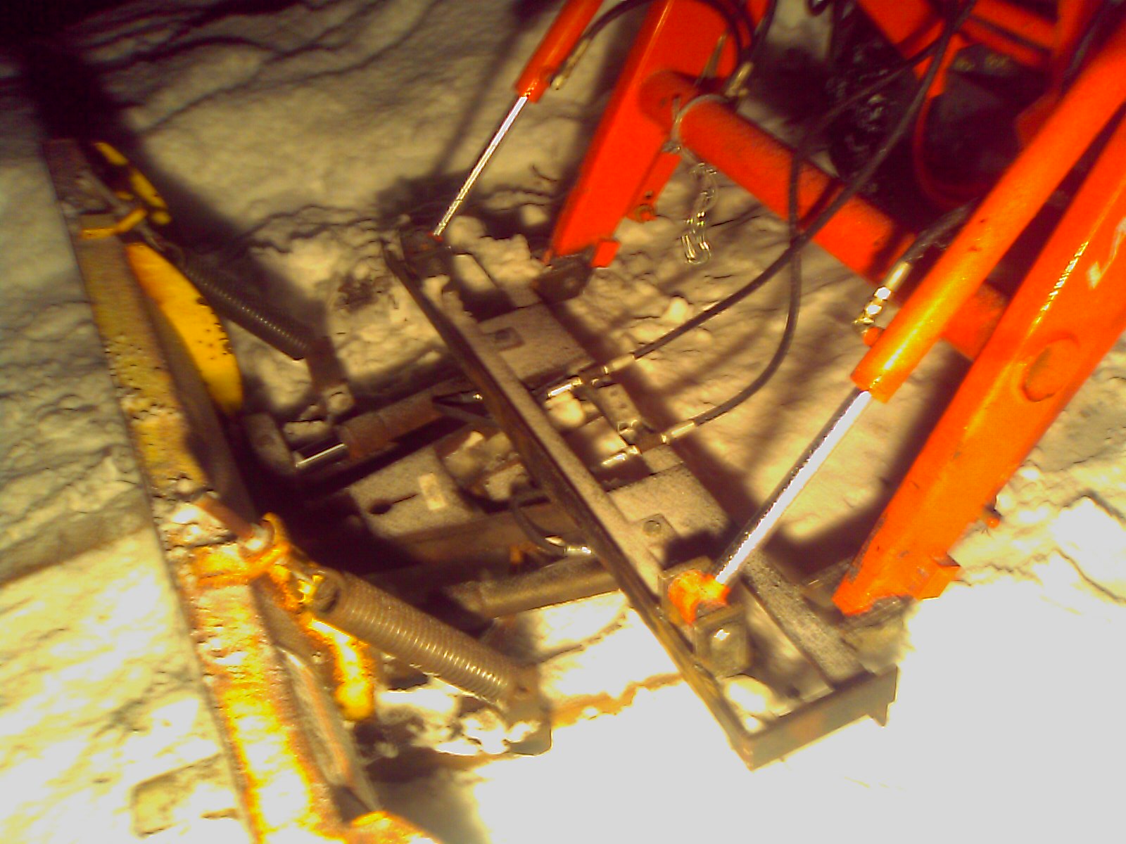

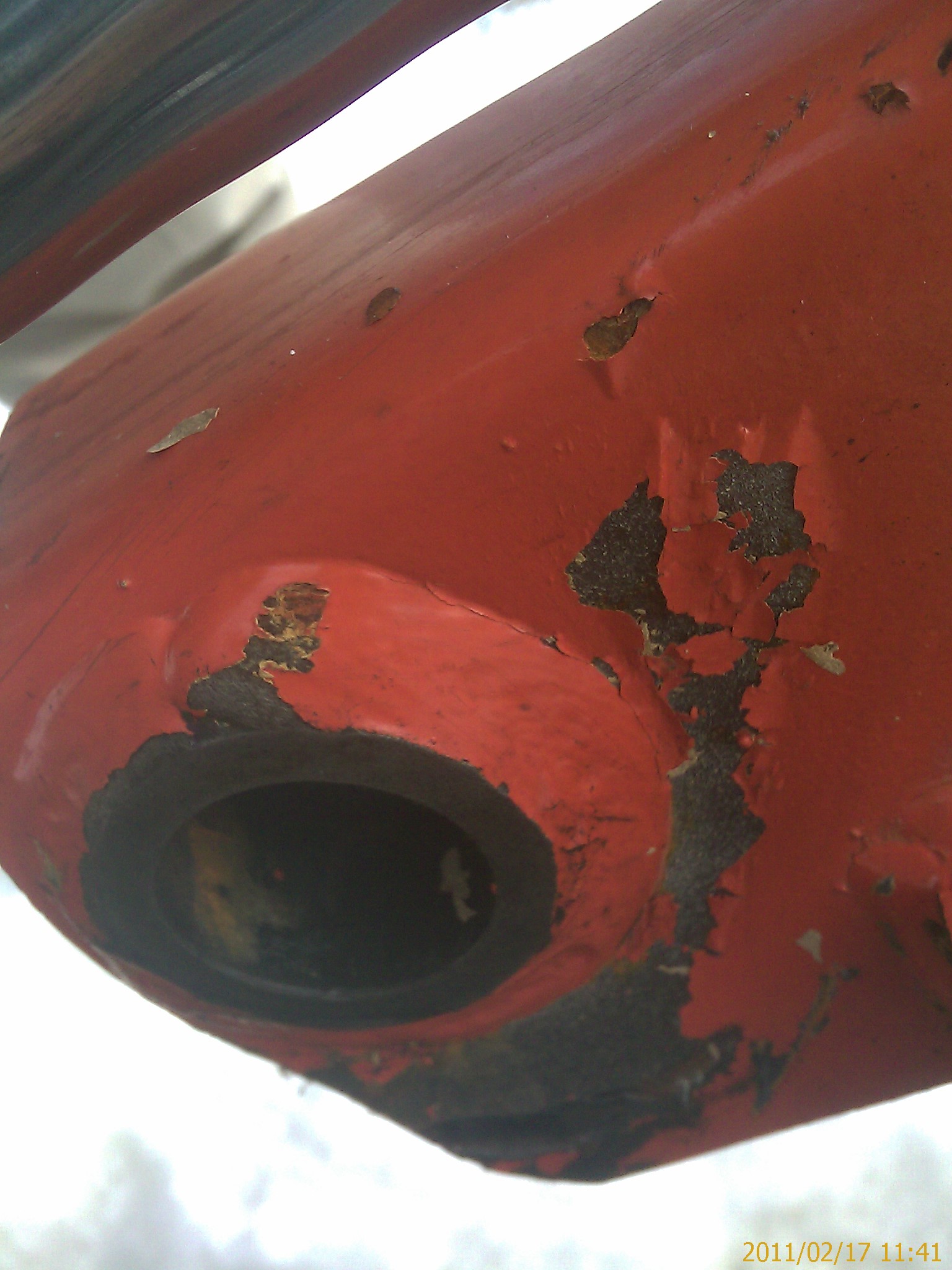

I have a 2006 B2630 with a LA403 loader that I put a plow on. The plow is attached to the loader arms and cylinders with a steel bracket that has tabs on it that you use to put the loader arm/cylinder pins in. I was moving a tremendous amount of snow with it this winter. I have a 1000 foot driveway plus I did a neighbors driveway and helped others out from time to time when they were completely snowed in.
Somewhere along the line while plowing all this snow we had this winter, a pin fell out of the loader arm and I did not notice it. The plow remained attached via 3 other pins (one through the other loader arm and two through the cylinders). In the process of plowing without the fourth pin the steel on the loader arm where the one pin remained and where the sleave for that pin is got bent. At this point I cant tell if anything else is bent. I just cant tell by looking at it. I have a bad feeling that other things are out of whack though. My bucket is inaccessible up in the woods under the snow so I cant check to see if everything lines up by seeing if I can connect it.
Any advice as to how to diagnose any remaining possible problems and fixing the bent arm at the sleave? I am thinking I need a welder to cut it out and reweld it in at the proper alignment?? I will put some pics up as soon as I figure that out.

You can do some point to point cross measurements to check if the arms are wracked out of parallel...
The twist that an angled blade puts on the arms is sometimes quite high.
If everything will still pin up, I would leave will enough alone. If it is tweeked too much for alignment, then you might have to either heat and reshape or cut and reweld...
If it is off a little and is off being perfectly true, I would not worry too much as there are some new loaders that are not exactly true and plumb...
If you can not re-pin the bucket, then you may have to do something... In any case you should repaint the injury/repair to prevent rust from further degrading the strength... KennyV

Kind of hard to tell how bad it is from the pictures. If it were mine, I would find a piece of cold rolled steel shaft as close to the pin size as possible , but still fit through the arm. Slide that through the bent side and see where it lands on the good side. You can probably straighten it using a rosebud on a torch and heating it bright red and using a long pry bar through the pin hole to pull it back straight. Use the cold rolled only to check your progress. You would want to do most of the heating on the side of the arm that is bulged. Flattening the bulge with a hammer may help too. You'll also need to verify that the distance between the arms is correct. It could also be done the way you suggested, cutting and welding. I would still use the cold rolled for an alignment tool.

I wouldn't use the cold rolled for alignment if you cut and weld unless it is a tight and perfect fit. Even a small amount of play gets multiplied substantially. I speak from experience, used this technique on an older case and the bucket has never fit quite right since. It's important enough to get it right to make the effort to dig out the bucket so you know the alignment is right. A carpenters square can also help you figure out if other things are out of whack.

I friend of mine just fixed a big loader arm for the same reason - pin fell out and they kept using it. He put a long bar through the bushing hole, then loaded the arm using the hydraulics - I think he used a snowplow to rest the other end of the bar. Anyway, the front end of the machine came up off the ground, with corrective pressure on the bar. He then hit the arm with a rosebud-equipped torch. Sloooooowly, the arm twisted back into position and it was fixed. Took an hour all together.

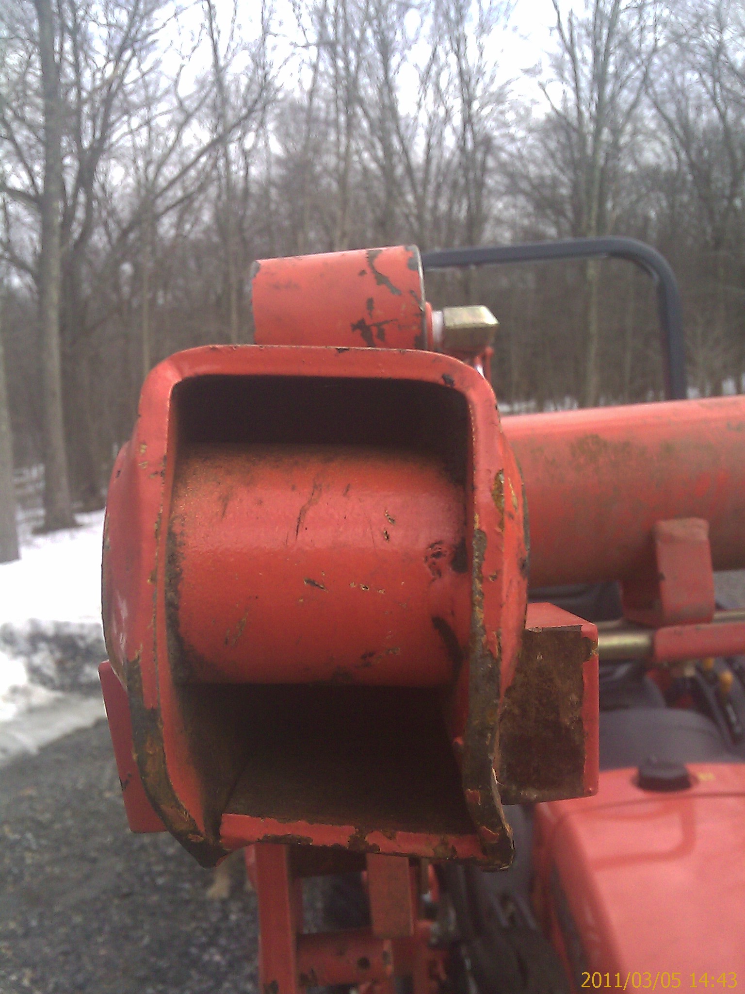

I bought the 1" bar about 6 or 7' long. Havent figured out where I am going to get the torch yet. Bar fits nicely. maybe a little loose as one of you stated. Here is a better pic of my problem:

Even though I am the king of "I can do it myself" I have found it surprisingly hard to heat up any significant amount of steel enough to bend it even with a small oxy acet rig. You should probably bite the bullet and have a pro come out with a big a** rosebud to heat this up so you can straighten it. Otherwise you'll spend waste hours of time and lots of gas. A decent sized rosebud requires big tanks because of the way acetylene is concentrated. Alternatively you may be able to rent a rig but I'd still bet the a pro would be worth the money.

Listen I don't want to discourage you but I do not believe you will be able to repair this because you will not have the correct torch and or other alignment tools needed to compleate this job.Do your self a favor and save time and effort have the pro's do this job, bit the bullet and have it repaired correctly.

It can be straightened with the regular tip on the oxy/acet torch, but you gotta have 2 people to do this. And zero wind conditions, on a hot day in full sun.
But I agree with KBL3830, the 'rosebud tip' will do a much better job(and faster), but I would still recommend 2 people for the task...........one operating the torch, the other bending and lining up the arms.

Thats going to be a tough one. I think it's going to take a rosebud to get it hot enough, and in the right places. I have gotten steel red hot using a weed burner but I don't know if what you have will be enough. You'll want to get the metal below the pin boss where it's deformed extra hot so most of the bending will occur there. Good luck.
