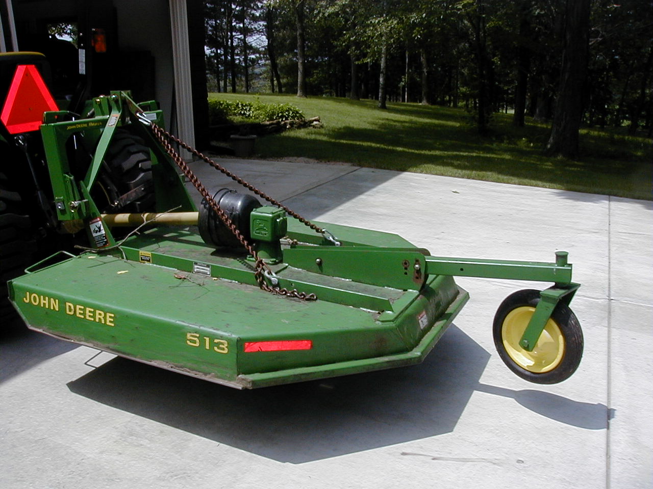

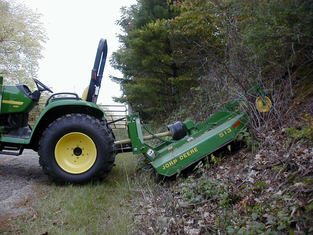

I wouldn't want to have it so I could not pick up the rear of the deck. I put chains from the top of the A back to the rear frame. I then let the deck ride on the rear wheel and adjust the front with the 3 ph. For moving over obstacles or road travel, I lift the 3 ph high and have the chains lift the rear wheel off the ground. This keeps from putting the stress on the top arm.
