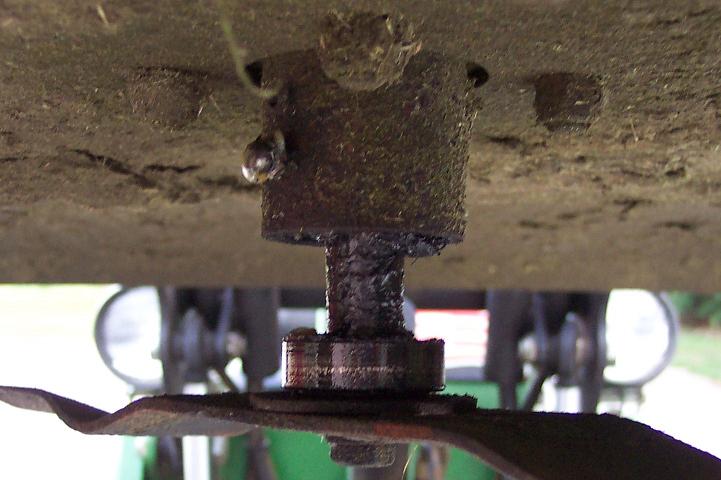

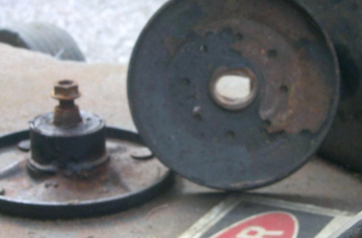

Started work on the mower deck. (Broken coupler and spider.)
Took off the top motor coupler bracket from the mower bracket.
Removed mower coupler (one allen set screw holds it).
Loosened pulley set screws (two allen screws on the pulley).
Drove the spindle shaft down to get coupler off.
Placed lower spindle with blade still attached on a block of wood and lowered deck down, to push spindle back up and hold in place.
Pushed pulley (still on spindle) back down into place and tightened the two allen screws with as much pressure as I could without breaking the allen wrench.

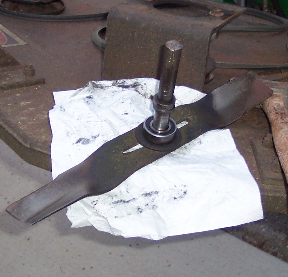

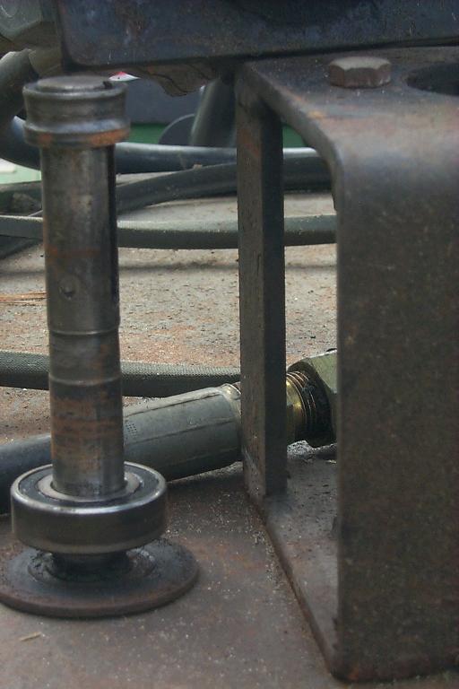

Lifted mower deck up to check to see if there was any "play" in spindle shaft...THERE WAS!
Decided to take spindle completely out to check bearings...good thing I did, the top bearing was completely destroyed, thus the "play" in the shaft. (I replaced both of those bearings on that spindle less than a year ago!)
Also, when I loosened the pulley allen screws, despite all the pressure I thought I put on them to tighten them, I barely had to put any pressure on the allen wrench to untighten.
(Not a good design if you ask me. If those allen screws for the pulley and coupler come loose, the shaft can begin a downward slide with all that vibration.)
So, I now have to stop again to order new bearings.

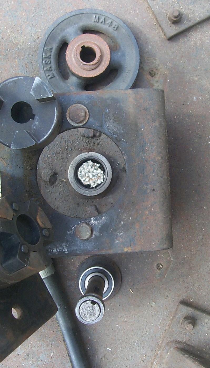

Ahh! Found it (I think)
You have to click on "Go Advance".
Let's see if it works:

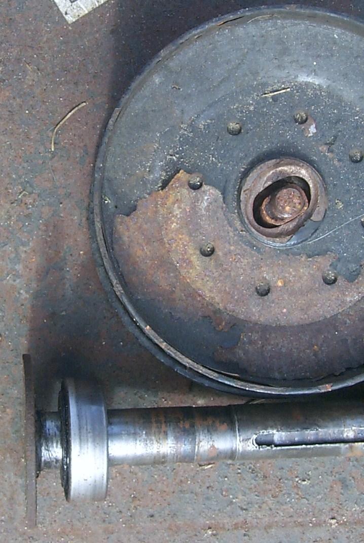

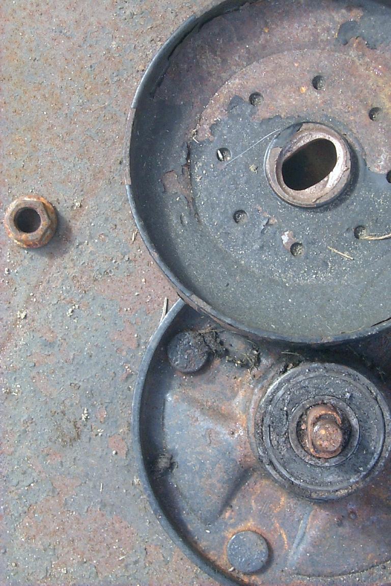

And a few more:

Great pix. Just for future reference, what method did you use to get the spider off the spindle? Hammer? Gear Puller?
As for everything else, man, that bearing is completely messed.

The spider doesn't attach to the spindle, but goes in between the upper motor coupler, and the lower coupler that is attached to the spindle. The spider is rubber (or plastic) and is for a buffer between the upper and lower couplers.
The coupler on the spindle, I just drove the spindle down with hammer and wood dowel, after loosening the allen screw.
To get the messed up bearing off of the spindle (at least what was left of it) a gear puller would have been nice, but not having one, a vice, hammer and blunt scrap steal to knock it off is what I used.

I have now found that the spindle shaft itself is damaged from the bearing. Where the bearing sits, it has caused a groove in the shaft (and has also started wear to a lesser extent on where the lower bearing is).
Keith at PT was going to be gracious and send me the bearings. But with the spindle shaft damage, well, that changes things.
And the company that made that spindle shaft do not make them any more! So a different one will be substituted and is about $150.
I am going to take a few more pics as soon as I can to send to Keith at PT of my mower deck, just to make sure we are on the same page of what I have, and what can be interchangable or not.

It looks like you are forcing a lot of grease into that spindle. The bearing shown is a sealed bearing and requires no grease. I re-built my 60" deck. Bought the bearings on ebay for 2.99 each. I do not grease the sealed bearings anymore and will replace them every couple of years.
sg
/ Belt for 48" deck #95
Idabe,
sg
IMHO, the best way to grease PT's sealed bearing is very carefully. Once in awhile I pump just enough by hand, never with the air gun, to keep the cavity full to keep moisture out and help transfer heat from the bearings.

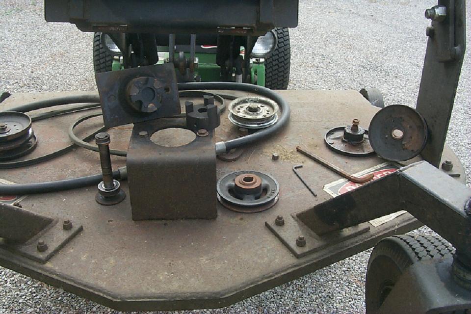

Well, I am back at it again, seeing the grass is getting higher and higher.
It is time to attack this mower problem again (actually way over due. I thought I would be able to get to it this winter, but......what was I thinking, I guess I wasn't).
Here is what I sent to Keith at PT:
Keith,
This is Abe from Michigan.
I need to know how much it will cost to get this mower (48' - 3 blade, T3025 / 15211) running again.
I believe it all went bad when the "center spindle bearing" took a crap and allowed spindle to wobble.
This wobbling caused the lower "coupler" to break (which I already purchased a new one from PT) and the
"spider coupler" to break apart also (also purchased a new one from PT).
I think, the right (viewing from front) "pulley" top nut must have loosened also, thus allowing it to wobble
and creating an oblong hole.
The "spindle shaft" (showing currently with a bearing on it toward the bottom, and the inside portion of a bearing
on the top) also looks like it is worn away, or has a groove worn into it about 3/4 the way down the shaft.
And, since this occured last fall, I have misplaced a couple "washers".
So, it looks like these are the parts I need:
1 - Spindle Shaft
1 - Spindle Key
2 - Spindle Bearings (M15068)
2 - Spindle Washers (M15071)
1 - Pulley (outside, not center)
Last fall you faxed me the Center Spindle Assembly pic / parts / description sheet [M880X1] for 48' Mower.
On it, it says there are "4 - 3/8 inch - 16 Elastic Stop Nut" (part # NE037-16) but has an asterisk by it that says "Not Shown".
Am I suppose to have these 4 parts also?
I will send this email with pics, and then give you a call to see that you received it and if parts are
available.
Thanks,
Abe
Well, I have the "old" style mower, and no parts availible.
So, I have to buy the "new" complete assemble for the center and the outside spindles!
$249 for all.
I guess it could be worse....and have to buy a whole "new" deck!

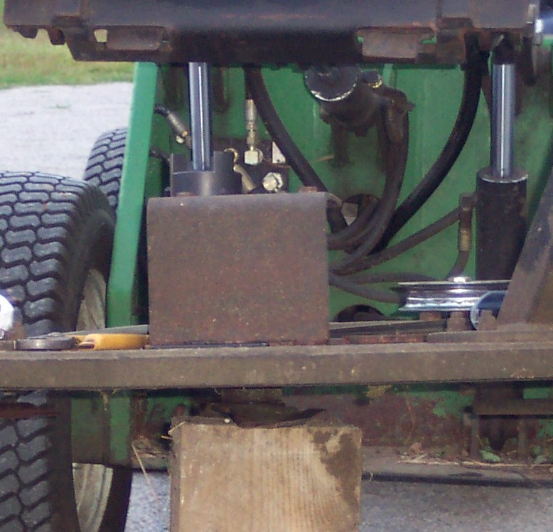

Let's try the pics again.

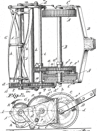

Just wondering....
Would it be hard to find one of those rotary blade mowers, like you see on a golf course, and fabricate it to a quick attach plate.
I have mostly flat ground.
It sure would be nice not to have to worry about the hydro motor, spindles, bearings, etc. just to mow grass.
Any ideas or suggestions?
/ Belt for 48" deck
#99
Like this (pic) but larger.
