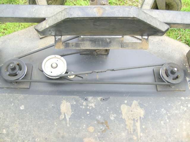

It's been awhile but I think the size I got from TSC was the closest I could find without going over the size of the used belt. The deck does have an adjustment for tension. My original belt became "chewed up" partly due to debris under the deck covers...I have since removed the covers hoping this will prolong the life of the belt. Now the leaf blower removes all debris quickly and this also allows you to keep an eye on the tension over time.

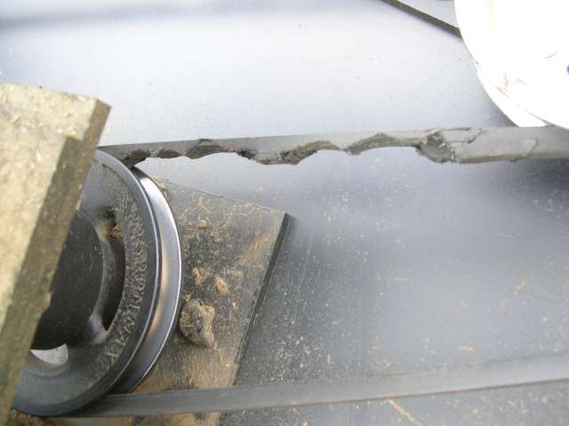

Look for a 1/2" X 105 " belt. Here is what my belt looked like after 2 1/2 mowing seasons.

Would it help to extend belt life if you engage the PTO with the engine going slow (maybe idle or just above). This reduces that startup shock which can take those notches out of the belt. I do this for the bush hog if I remember, to reduce the clunk. No belt there of course.
